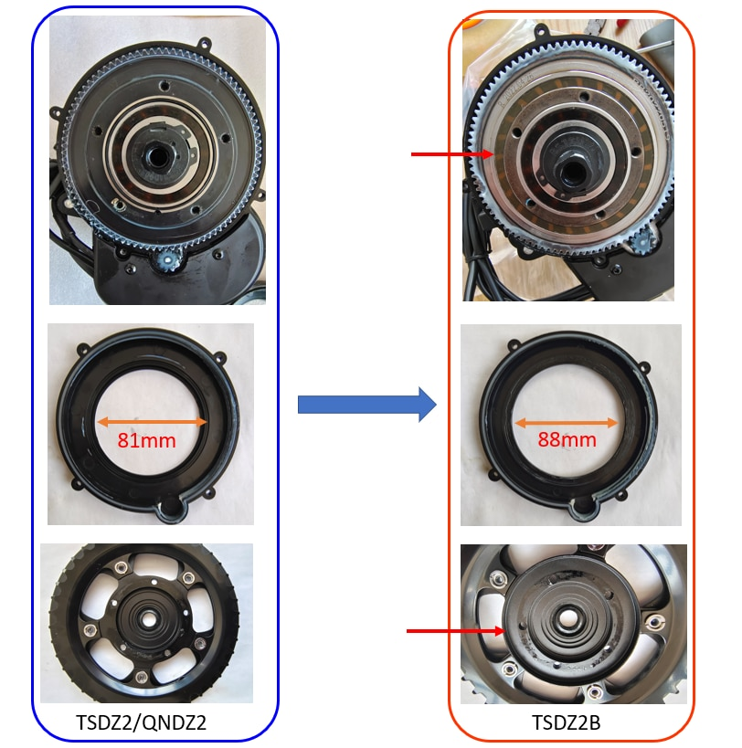

With the red Trek I could not install the chainring. WTF! I couldn't even get one screw through the spider. So I got out my calipers. Incompatible. It is because I was trying to install a normal TSDZ2 spider. The TSDZ2'B' V-5 has an improved spider design. It has a ring that recesses into the motor with a seal. The bolt pattern is also smaller. It tried turning the installed ring by hand - supper smooth. Zero play. But in the reverse direction there is a lot of resistance and you can feel the new duel clutch system. This one is 48V, 750W. I am just waiting for the chain to arrive. It should be here in one hour. The insidious thing about that large river in South America is that it is so easy. I ordered the chain last night.
Correction: The new duel clutch motor has more resistance pedaling forward when unassisted. It is about twice the resistance of the regular motor.
Do you know why they made changes? It would seem that more resistance pedaling without assist is a bad thing. So now there are two one way clutches in the main gear? Maybe to eliminate the small one way bearing in the blue nylon gear that runs off of the motor shaft? If the large one way clutch in the outer portion of the main gear takes the place of the small one way bearing in the blue gear it would explain extra friction (?) but should also be much more robust than the one way bearing in the blue gear. I might have it all wrong though.

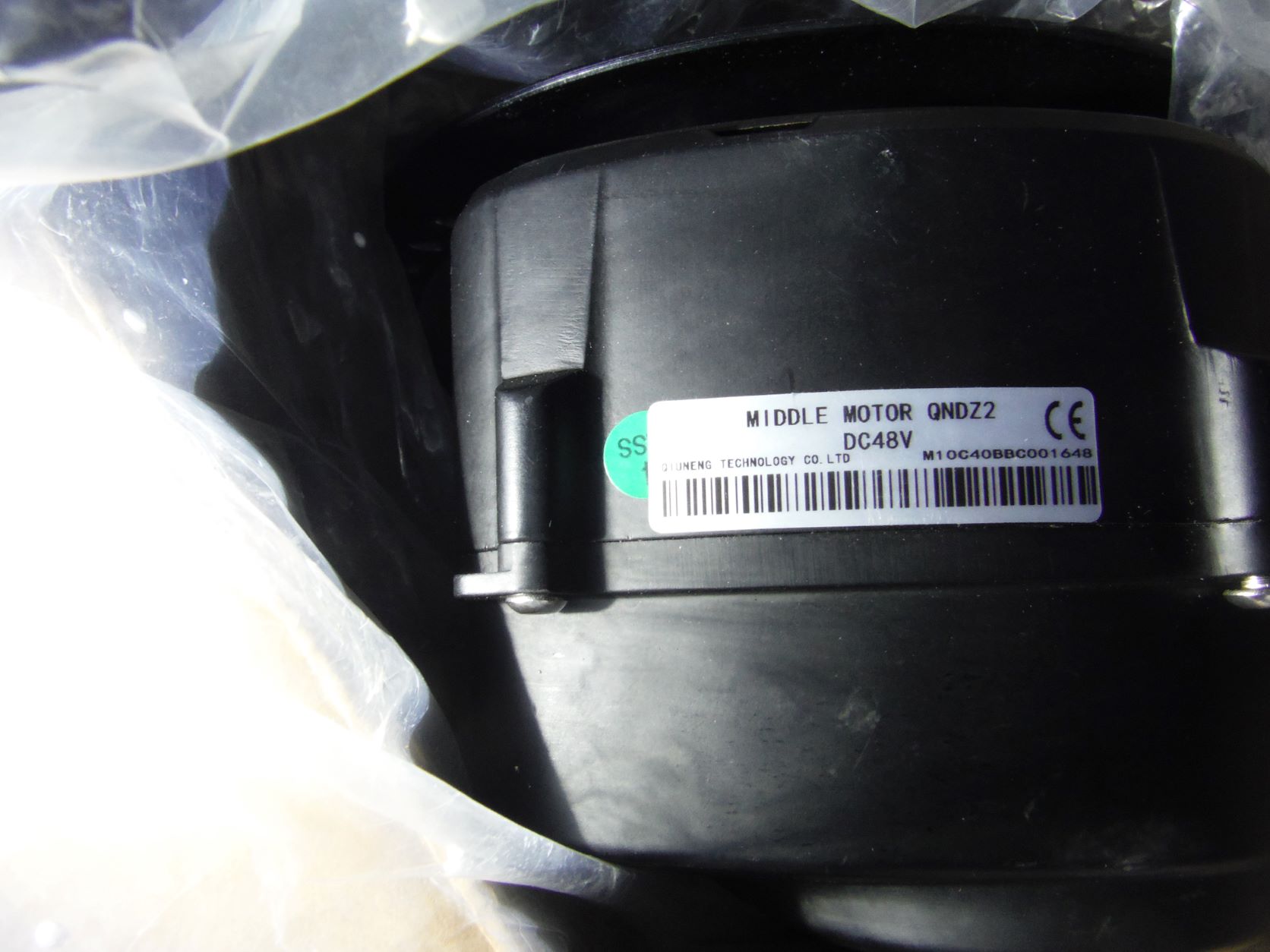

Self-doubt goes a long way. I may have simply overpack the sealed channel with lithium grease in my grease enthusiasm. I was just working it for a bunch of revolutions and it seams to have eased up as I went through a bunch of Q-tips wiping away grease that came out of the channel. I had never heard of a QNDZ2 until I saw it on a different motor today. It came from an unusual source in Colorado.

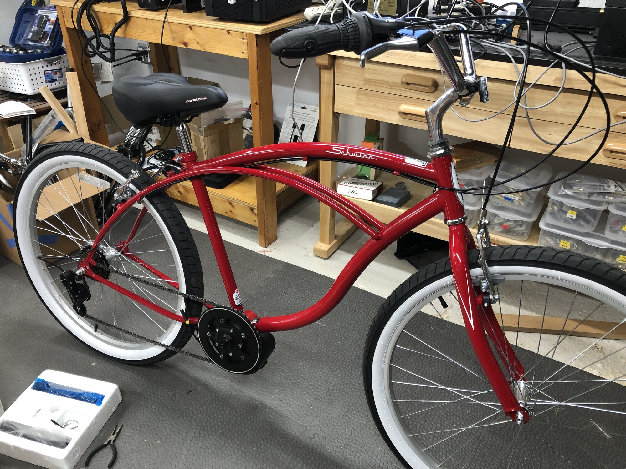

I didn't make much progress today... I had to move dirt and plant grass... you know how that goes... But I did manage to drop the motor into the frame. And that took longer than expected because the Luna eccentric adapters added some width to the bb, so I had to cut some custom spacers to mount behind the mounting plate. It all takes time! but here's what it looks like. Hopefully I can make more progress tomorrow!
