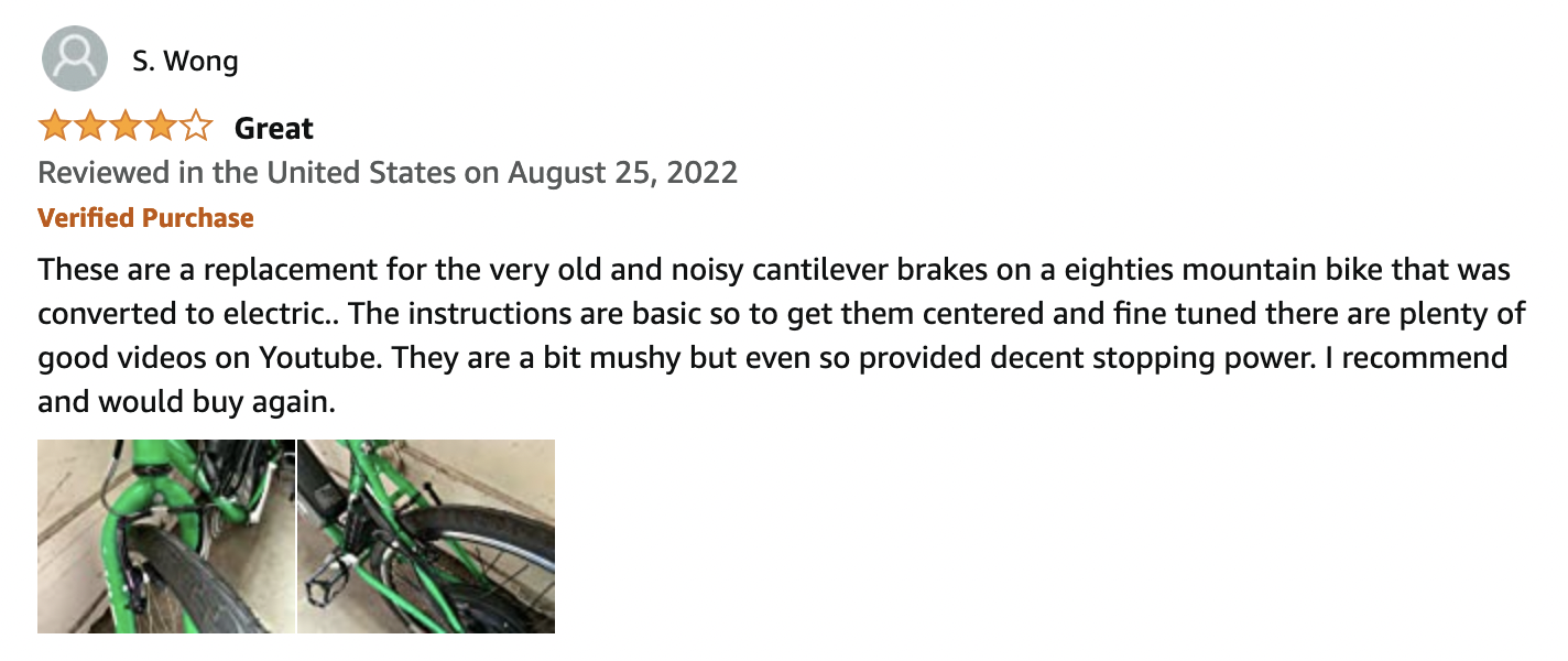

I was looking on Amazon, and came across this (see photo)... are ebike V brakes supposed to be a bit mushy?
Here's the link to the V brakes: https://www.amazon.com/Tektro-126M5...efix=tektro+ebike+v+brakes,sporting,87&sr=1-4

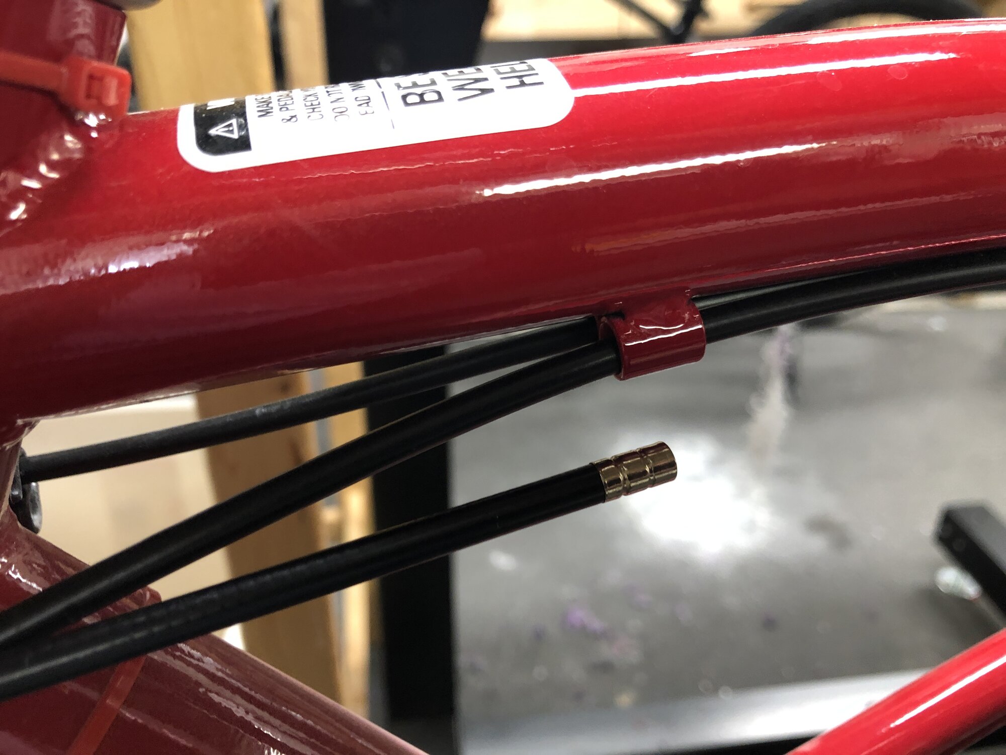

Getting back to the question of mushy brakes, do the cables need to be supported on the frame on both ends. My cable is only supported on the brake lever, and on the brake noodle. there are two lugs on the frame, but they are through lugs only. What if instead of a through lug, I were to make the cable end there with that metal housing end cap (ferrule), shown...??? and same thing down closer to the v brake noodle...???
I *think* the cable housings @PedalUma is talking about are also known as 'compressionless' and those are supposed to offer light years' better (less mushy) performance over your typical stock kaka housings. On my Envoy build I tried using a set of cabled BB7's I had in the parts pile to save money. On that longtail, rear brake performance was appallingly bad and the thoughts of the cargo bike community were that the long cable run suffered from not using quality housing. In the end I wound up going hydraulic to solve the problem (only one of several) and never took that further.

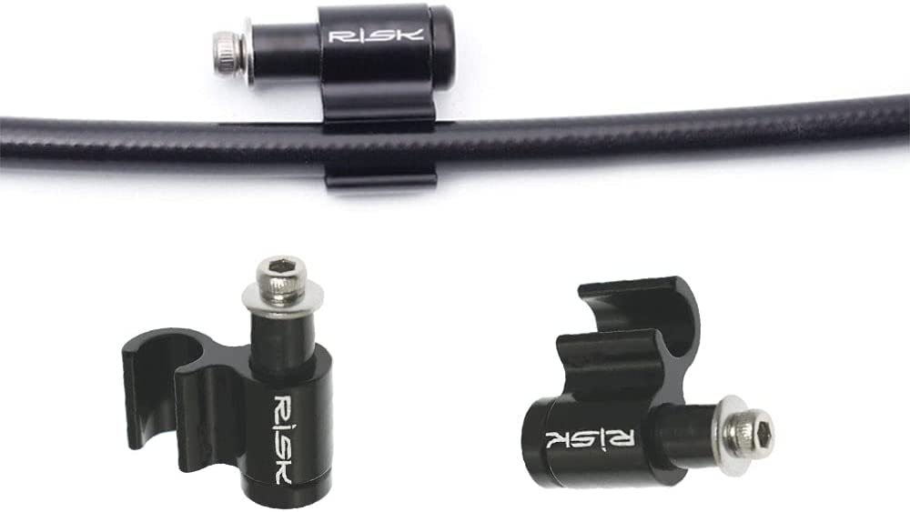

There are widgets to deal with this old-style one-piece cable guide. I used them on my Tracer build, which was a frame from 1999, back before good cable housing / slick cables existed, so the technique of the day was to use ferruled ends and bare cables for much of a cable run. These things:
The more the cables can flex, the more they absorb your lever motion rather than moving the cable. You want to try and lock that cable down. This is essentially the same thing that compressionless cable housing is supposed to do. So for all I know just buying the better housing will be enough (I think it probably will), but it cannot hurt to secure your cables. Also, in lieu of these doodads you can do a crisscross of very small zip ties - the 4" kind that are so small it won't even be noticeable you used them. Run the ties thru the cable boss, with the cable running next to the boss and held fast by the 'x' of the two ties. Tuck the little end blocks up against the frame so they are effectively invisible.

That's a real good idea, those clamps. I just have to get some of those and try them...

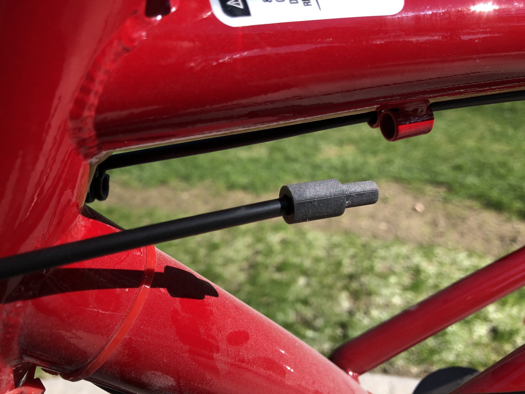

Meanwhile, here's what I was doing while I was waiting for your clamps!
I printed a couple ferrules and I am going to cut the cable up, and have a short piece of housing at the front, and a short piece of housing at the rear, and the rest will be bare wire! Let's see what happens!
I like continuous housing runs best. I suspect that older road bikes had bare cable to save grams. I am conscious of weight but don't need to be a weeny about grams. I like to feel the cable action by hand to see if there are any hang ups, like on the ends or too much of a tight bend somewhere.

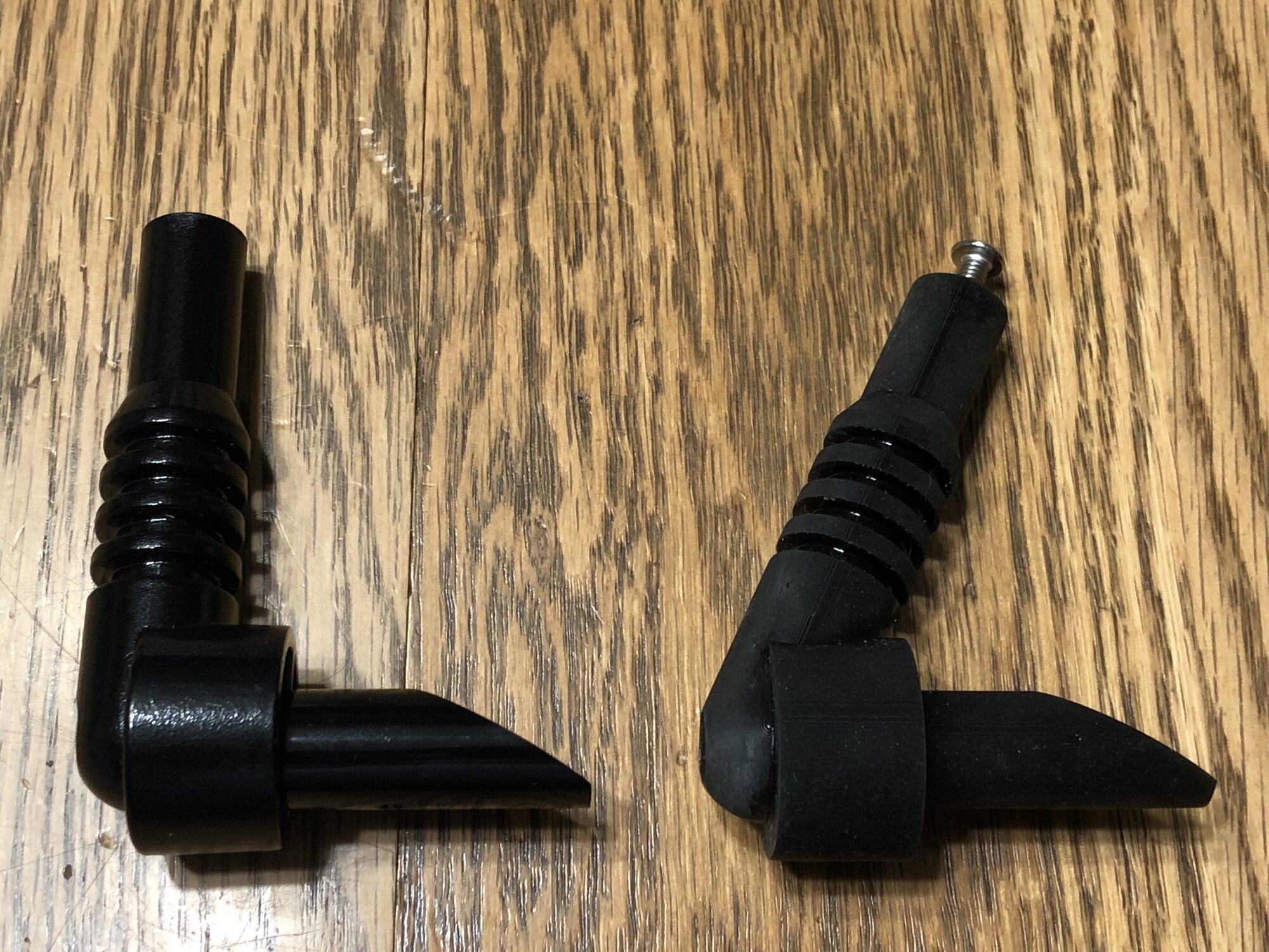

Hmmm... I have another bike with V Brakes, and the brakes work flawlessly... not mushy or anything. I think I'll swap a few parts and see what happens...
I didn't have to swap any parts. I decided the V brake noodle was the mushy spot. I went to the LBS and got a new noodle. Also my new brake pads came in, so I put those on too. Now the brakes are working pretty good. Not mushy any more...
But I did order the cable clamps... I'll try those when then come in...
