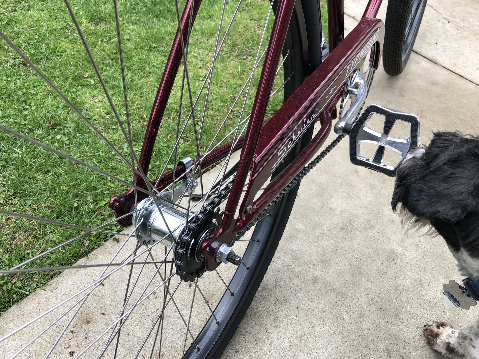

LOL, yeah, I wasn't very clear. I have an old Schwinn cruiser maybe 55 years old, which has a rear hub spacing of 110mm. I was just curious if it was even possible to spread it out to 135mm, because it's steel... But no I wouldn't do something like that...
Mike...
Weird! I have a 1973 Schwinn here for a cheap stealthy build. It and everyone I've seen has the typical 135MM dropouts.

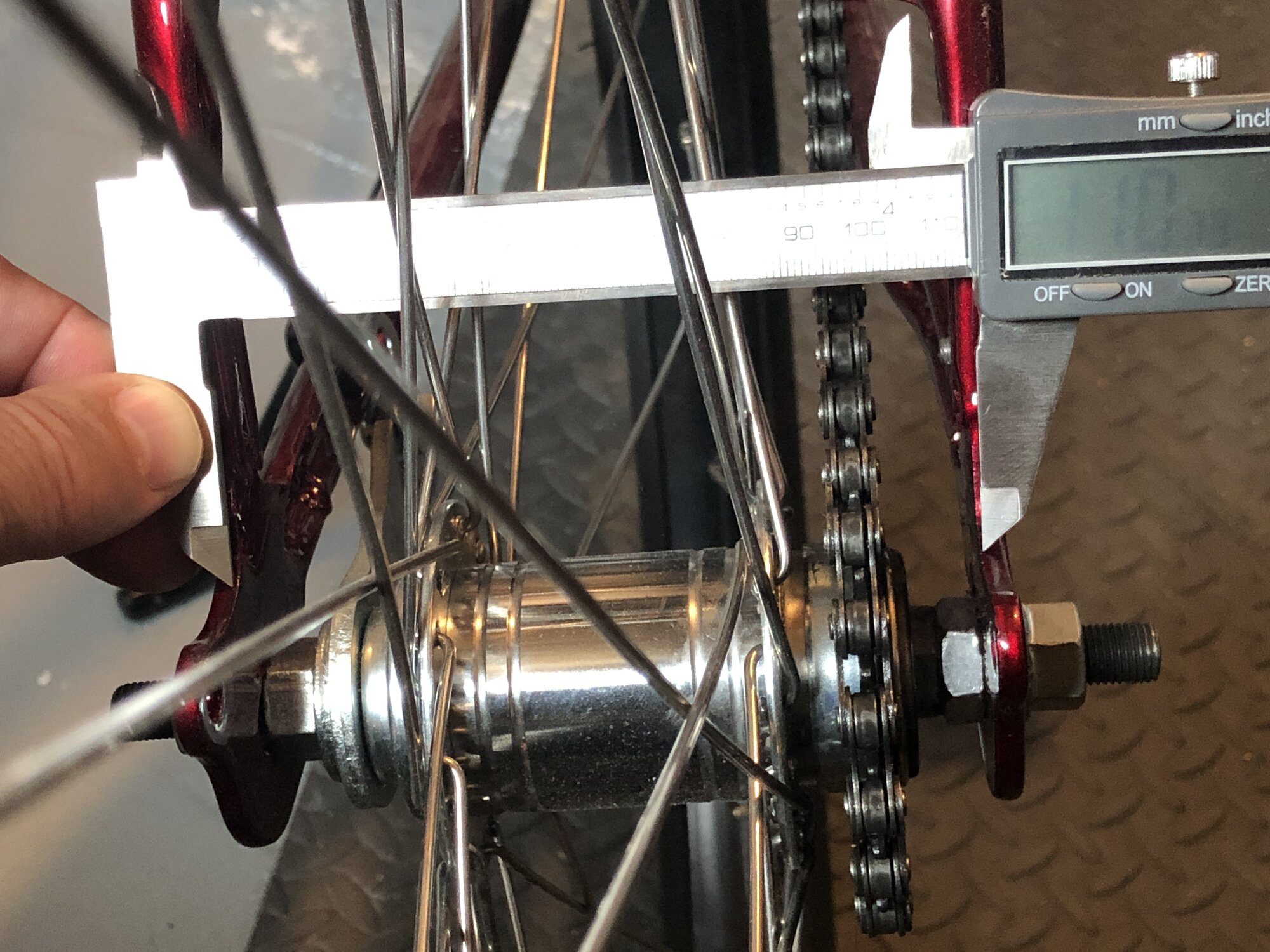

That's weird. I went downstairs and took a couple photos. It's a single speed with coaster brakes.
Definitely 110mm.
I also checked the serial number... it was made in 1977.
Even if I were to convert this to an ebike, it has no brakes, unless I add some caliper brakes using the fender mounting holes... Definitely not safe. :(

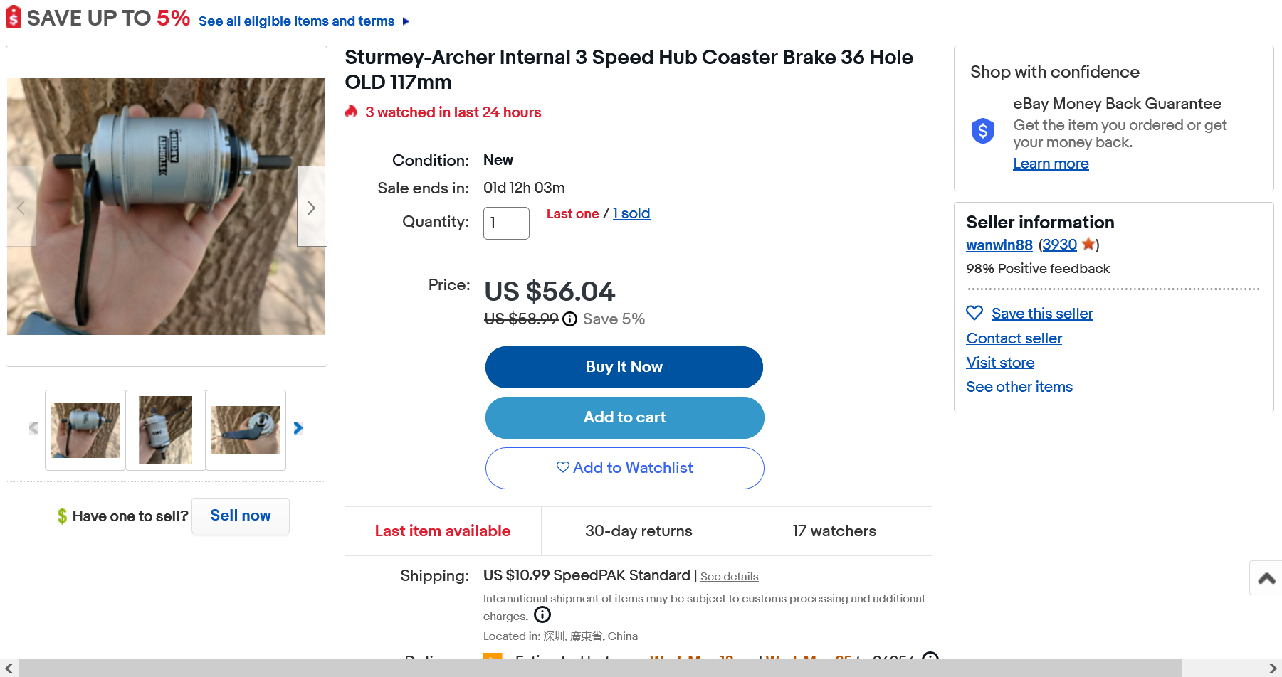

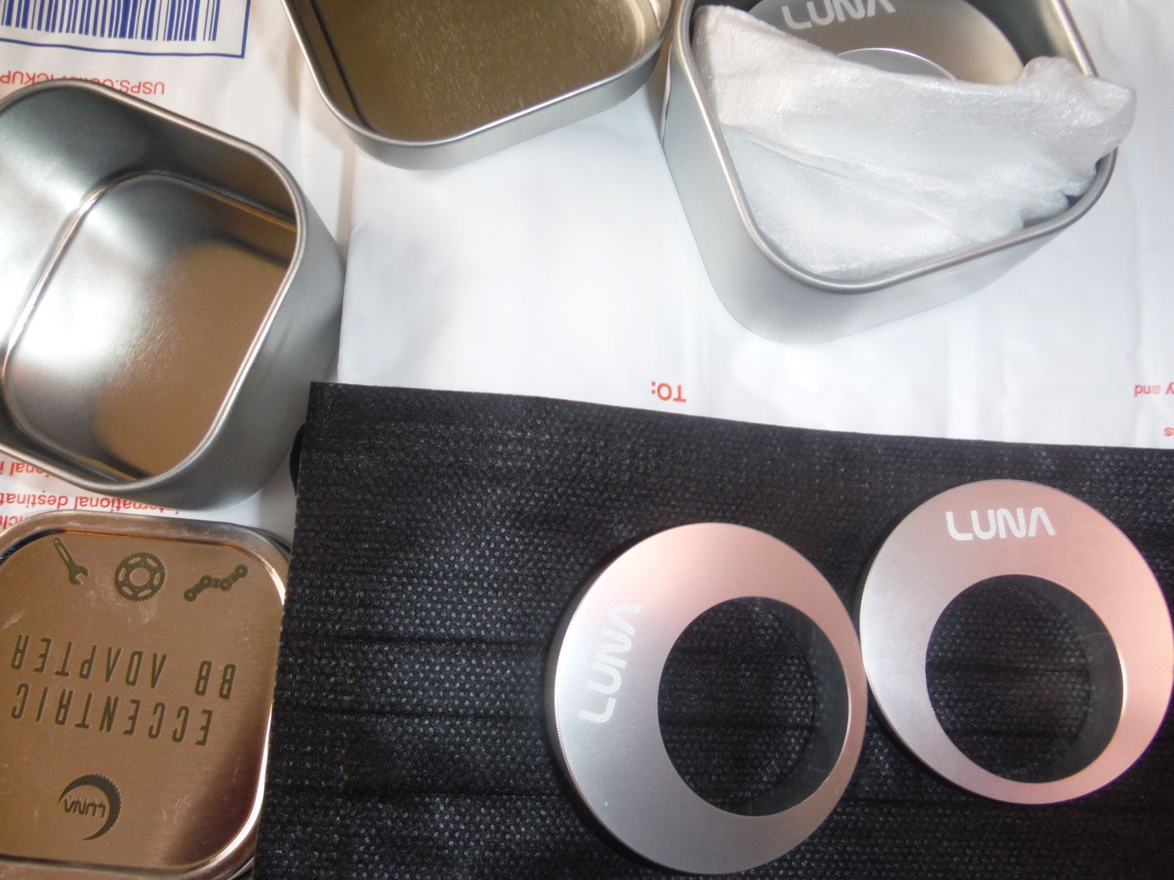

I would convert it. I would install a 117 OLD SA with coaster brake and use a coaster brake motor. There is also a solution for the American BB.

But what would you do for brake? Put caliper brakes in the fender holes?
Mike...
You would use the coaster brake. Just like on that cruiser that I showed you. Earlier this year I made a bike for a woman without thumbs. She has an eight speed Nexus with a coaster brake, so she can slow down or stop using back pedal pressure. I flipped the thumb shifter so she can tap it with her palm. It is a torque senor bike so the throttle is actuated with forward pedal pressure.

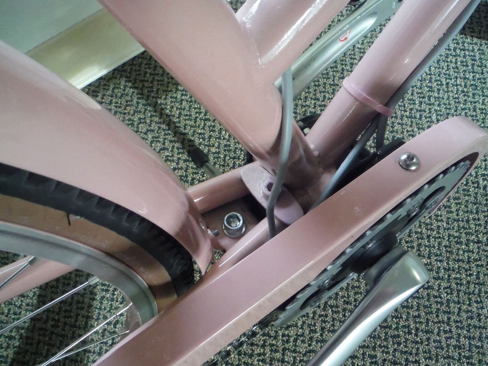

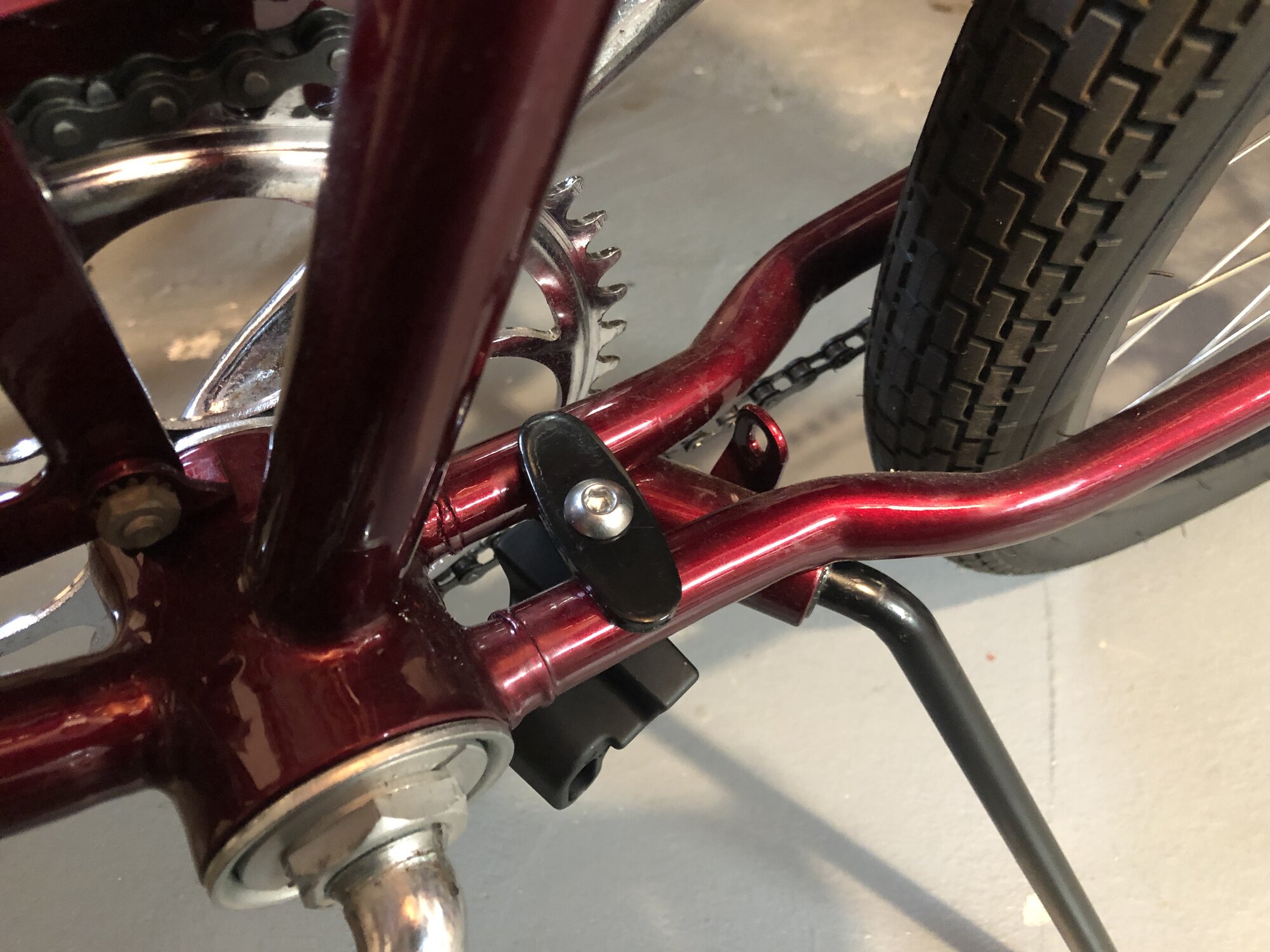

The tube behind the BB that leads to the chain stays needs to be drilled for the secondary motor mount. I have done that on many bikes. Here was my first attempt.

Definitely something to keep in mind when looking at potential candidates... The old Schwinn doesn't appear to have that issue.

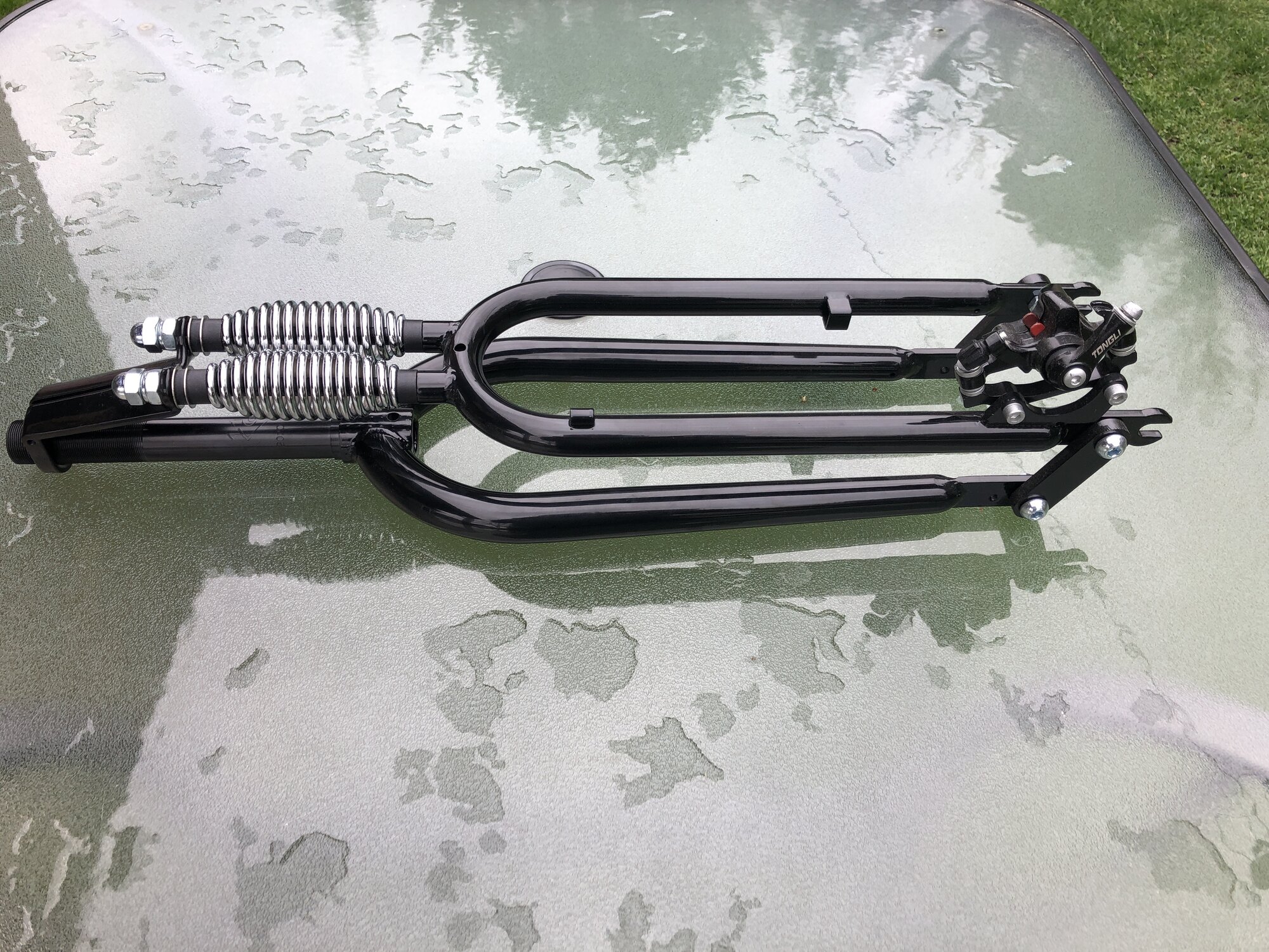

I've also got this, which would give me the option of adding front disc to anything with a 1" threaded steering tube. :)

I suppose, one could always get the Retrospec Chatham 7-speed if a cruiser was desired, and use koolstop pads with ebike compound. Just eyeballing the Chatham, it looks like a 1" threaded tube on the fork, so I could swap in the double springer and have at least front disc.

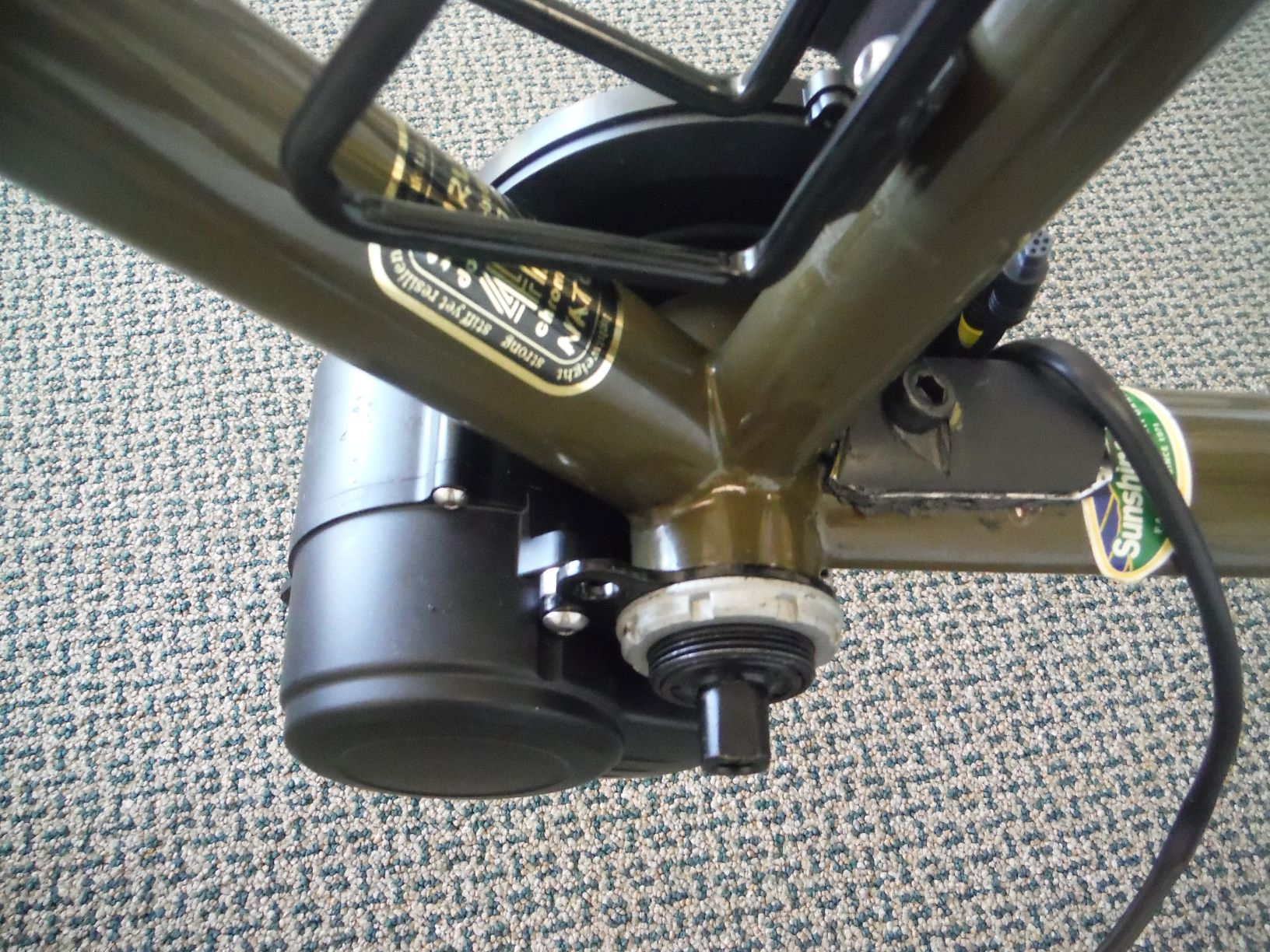

On the Schwinn you could keep the chainguard. Chainguards are very rare on eBikes. Check the color of the secondary mounting plate.
Very nice. Black would have looked out of place. I wonder, could you have wrapped the bottle in some vinyl adhesive paper?

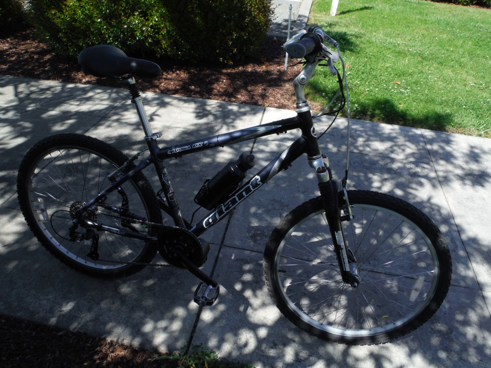

I normally use 36V 350W. But a guy bought a 250 kit on Amazon, took one look at it and threw in the towel. He sold it to me for $250 and its just sitting here. I am not sure where it will land. I am in the land of the San Andres. That means big hills. We also have very high winds due to temp differentials between the sea where it is 49 degrees and Sacramento where it is 73. The wind is channeled by something called the Petaluma Gap. It will knock you over coming around a corner. Our airport says the gusts are 21.2Mph today. That is why I go for the 350 over the 250. Sometimes I will do a 750W. MI is not hilly like San Francisco, so 250 might be right for you.
One lady put Nike stickers from eBay on her battery. The second photo is from New Years day.
I finished the $120 bike. It just went out the door. It has a throttle and a torque sensor. One final detail not shown is he wanted a bell, so I included a Pride Bell from Public Bikes. I was given the original prototype for this design a few years ago. I only owned it for about one hour and gave it to a person who was feeling down on the train. It didn't cost me anything, but it made his day and as far as I know it is still one of his most prized possessions. The $120 bike owner is super happy. Again, I am not the customer. I wouldn't want to invest in a $120 bike or ride with a Pride Bell.
