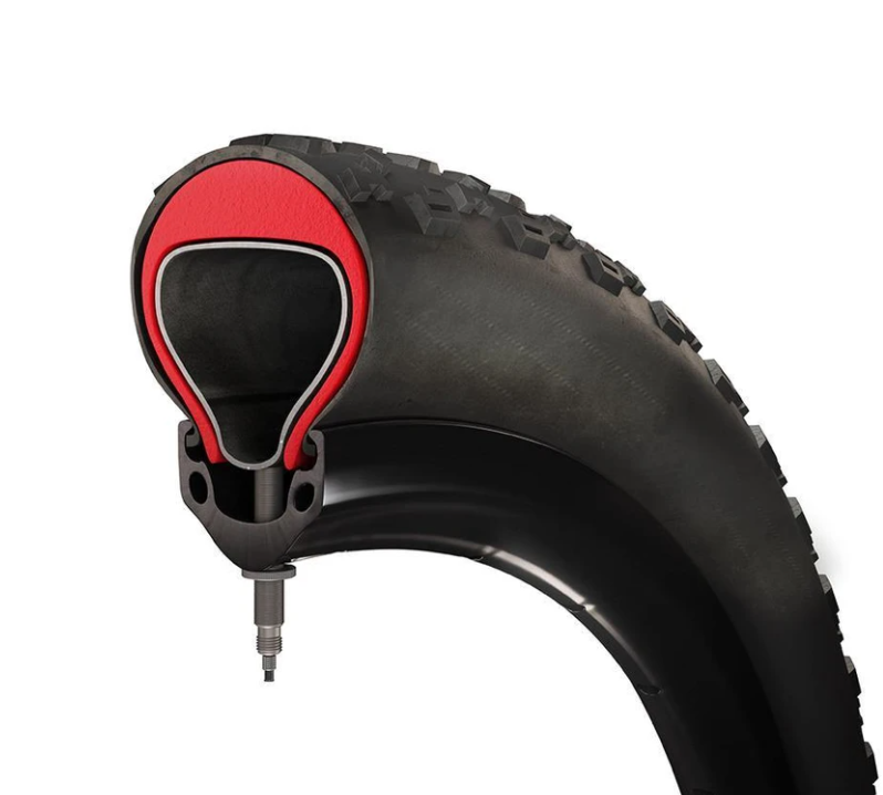

Thanks for the great info. I've had years where I'm the guy that gets the flats on every ride and years with none. eBike'ing is new to me so I ordered the Tannus liners and plan to use the Flat-out with it, but maybe I'll try without the extra sealant for a few months.
Just ordered the Mini 4 today after returning an RR6 that would've been too much trouble to travel with my family and their bikes\trailer etc.
Oh I would NOT rely on Tannus alone under any circumstances. Think of Tannus as gravy, despite the gray gravy you are using inside the tube :D
Don't know if you have researched it deeply enough but Tannus compacts itself over time and becomes thinner and thinner. I recently pulled apart the front (not the back, take note) wheel on my ti 2wd bike and found the Tannus inside had compressed quite a lot. Not paper thin yet, but ... baseball-mitt-leather thin? I just made that up. I think its still effective but it looks like, for a 26" fat tire. FlatOut is going to become a very expensive, wide-wrapping Mr. Tuffy liner. Which is not necessarily a bad thing. I am running Snowshoe XL's on 100mm rims running as low as 6 psi in deep, coarse, dry-ish beach sand. I think the liners are benefitting me in a couple of ways at such low pressures. But be advised That when Tannus warns you about this happening, and they recommend you deflate the tires in between rides (!) to stave off this outcome for as long as possible, its not idle chatter.
I am still going to use Tannus but if it compresses like this that means that using undersized tubes as Tannus recommends is not such a great idea. I like oversizing my tubes as it is, so when I change my tires over I will go from 4.0" tubes under 4.8" tires to 5.05" tubes and just *barely* inflate them inside to get them mounted - even on new installations.
This is a case where an already sometimes very difficult install (Tannus varies from 'no biggie' to 'nightmare' depending on the wheel/tire) just got a little bit more cerebral.

I wanted to like the Tannus, but if they compress I don't see how that works. They are supposed to have enough bulk to be a run flat (5mph). But the Fats are excluded, and if the liners compress?
Flat Out does not mention bikes in the advertising. I used the 'dirt bike' amount. When I went to add air, the valve was not gummed up. I had some tubes with a sealer that were always gummed up. I used the bottle of Slime because it has a usable core removal tool. No product, just the tool. The Flat Out has a toy core removal tool. Not a good first impression. I didn't know about the compression issue. That sounds really serious. The video concluded Flat Out plus the Tannus, but I don't see where the Tannus is pulling a lot of weight. It's very expensive foam. It was an entertaining video. Kind of like This Old House.
Thanks m@, That's why we have these forums. Seriously. You don't get long term use info like that without speaking with someone who knows. Thank you for the heads up the foam compression. I like the idea of the softer ride Tannus might provide, but sounds like that will fade some. I've used old inner tubes cut up and placed to line the the inside of the tire. I've heard of folks cutting off the sidewalls from old tires and using them the same way as a Tannus liner basically, so maybe I'll try those if I get flats with Tannus.
