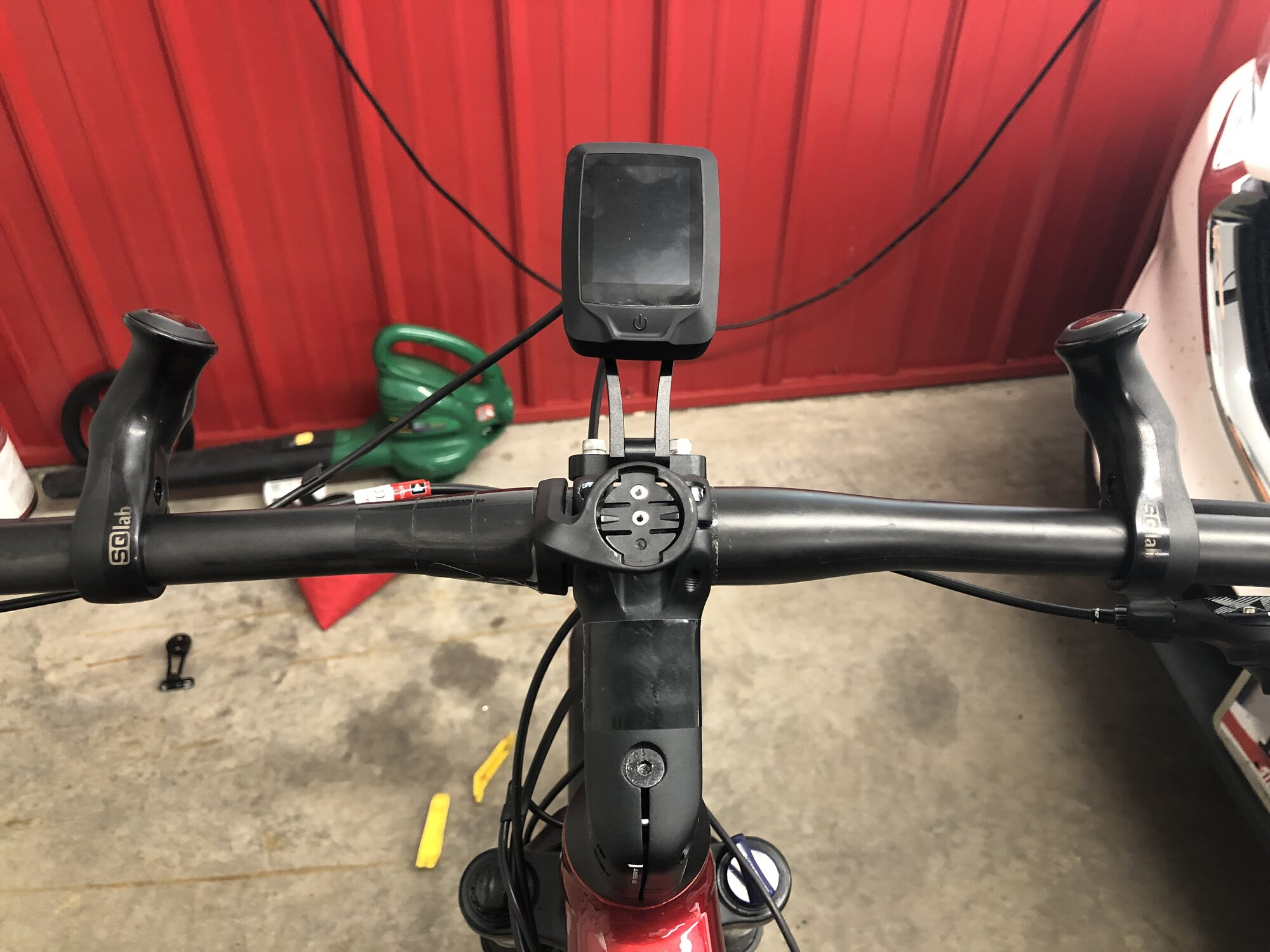

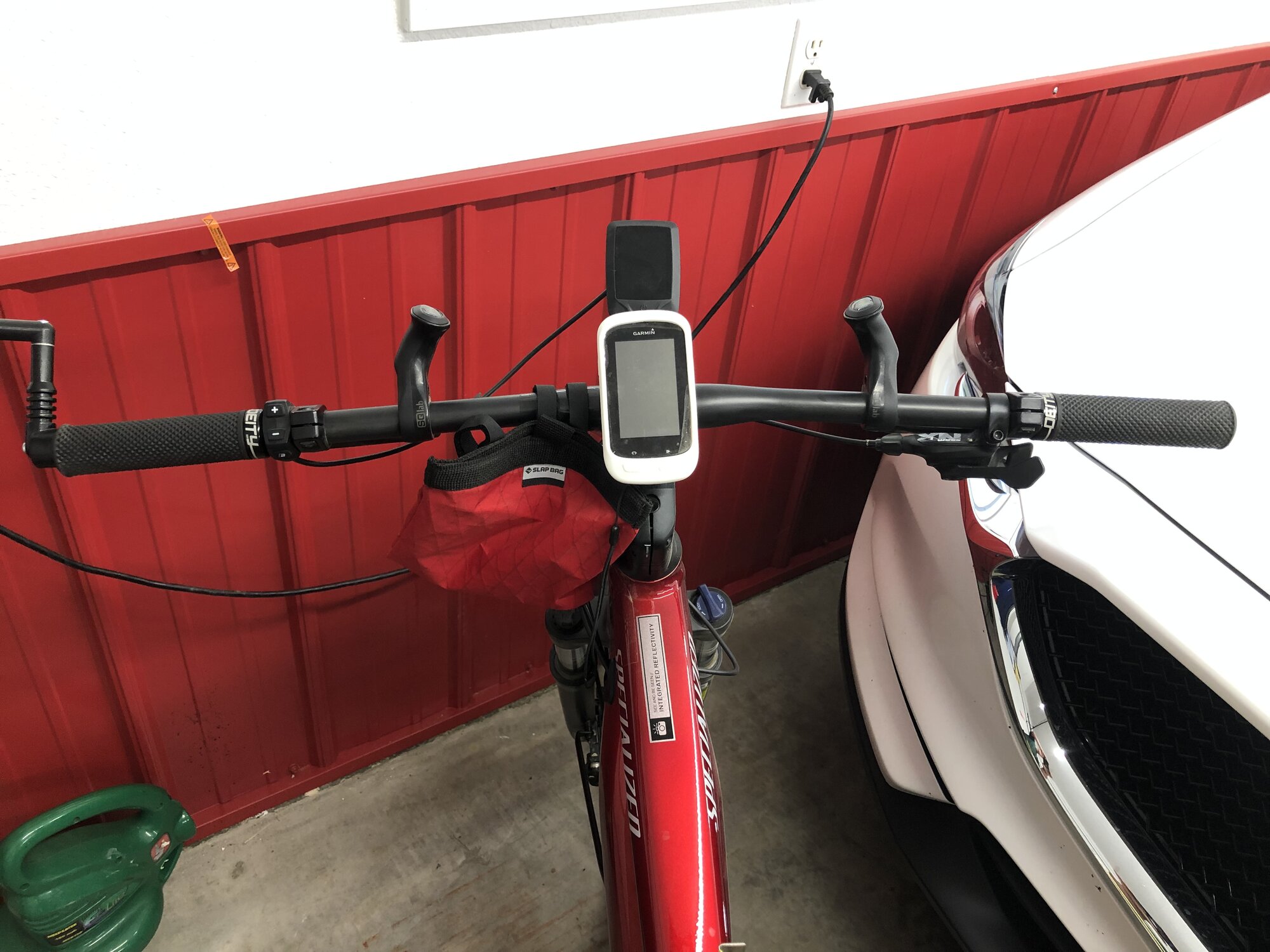

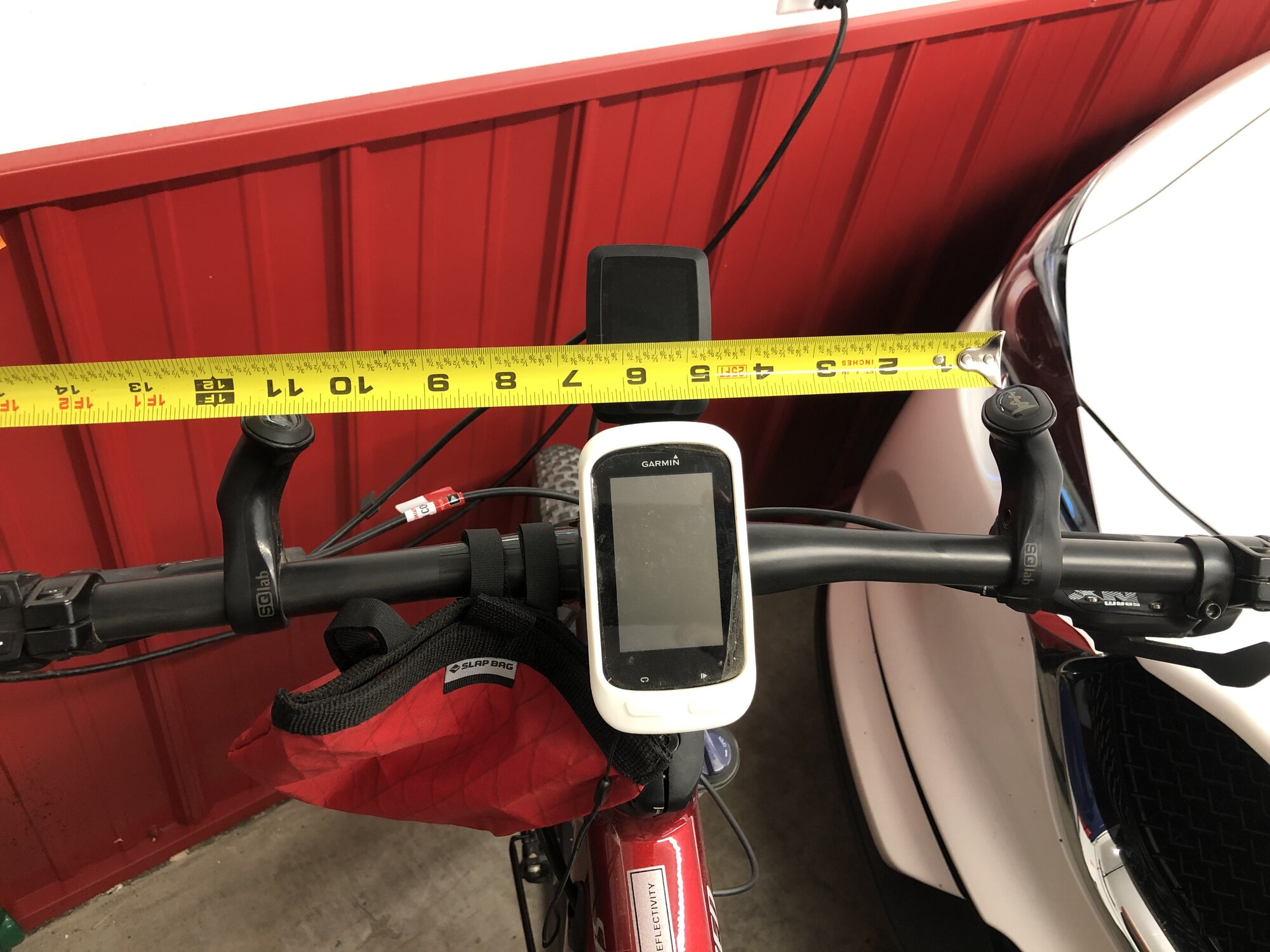

The bar ends may look uneven in this picture; it’s just the angle of the camera.
Sorry for upside-down tape measure.
I like where I have the bar ends positioned, but I believe you will often see photos of the SQLabs inner bar ends positioned right next to the handlebar grips.
They are mounted on a carbon flat bar (no rise) so it is a somewhat different configuration than a stock Vado.
You can pretty much set the innerbarends wherever you have space. I placed mine against the grips so I can easily operate the brakes while on the innerbarends. Sorry this is the only photo I have at the moment.

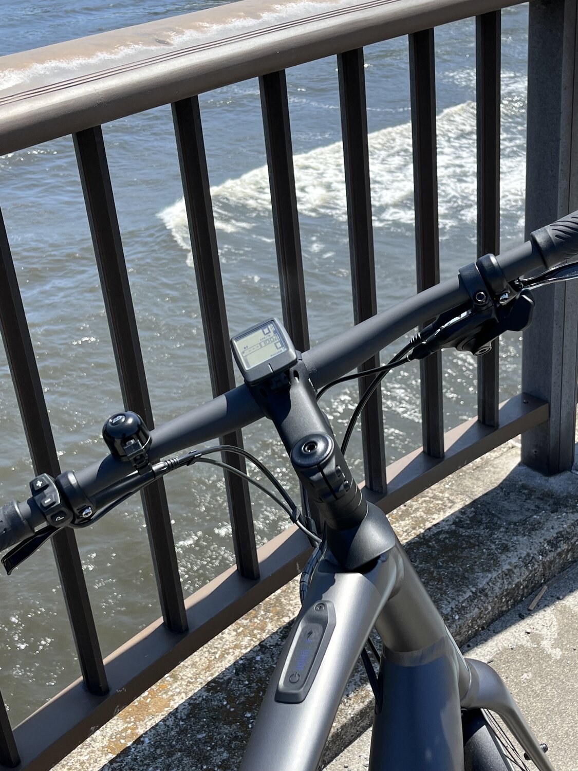

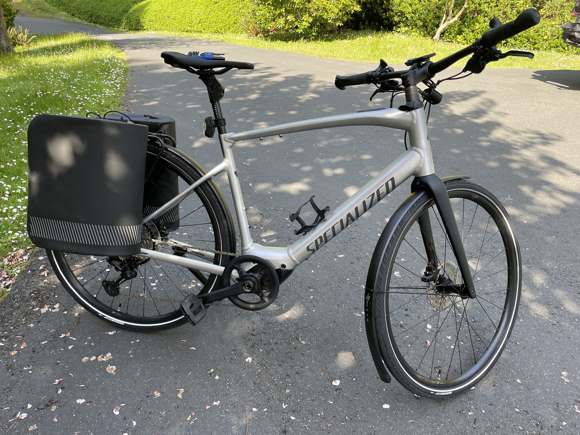

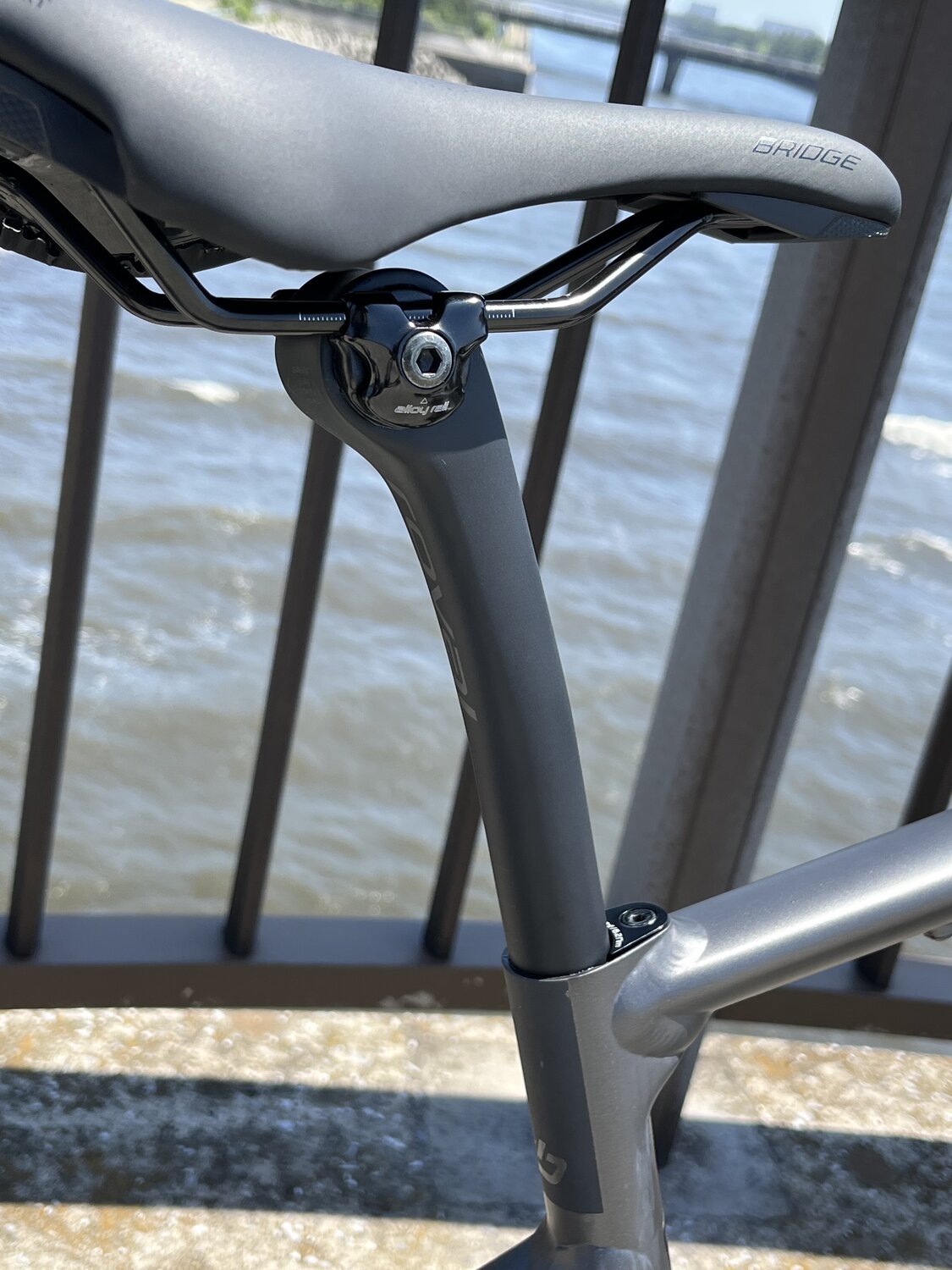

A couple of new mods to the Vado SL. An S-Works carbon riser handlebar and Roval seat post. I've temporarily gone back to the stock saddle from the Brooks but will likely switch back. I'm hoping the bar will reduce the vibration a bit. The seat post is a nice bit of industrial design but perhaps overkill on the
Vado...still, I'm happy with it!

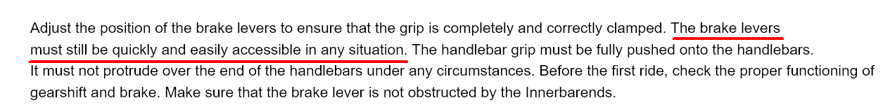

There is a rule about the Innerbarends: These need to be installed as close to the brake lever as possible because they are replacing drop-bar hoods and need to allow immediate braking. In my setup, the distance between the actual Innerbarend grips is 420 mm, or 16.5". The width of the drop-bar for road bike can be 380 mm, 400 mm, 420 mm or 440 mm. It is 420 mm with the innerbarends on my Vado SL. A perfect replacement for drop-bars. Who disagrees?
