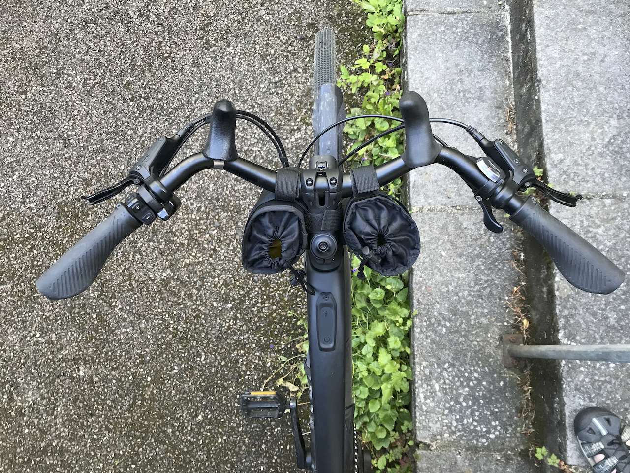

Not yet but thinking about it. Some padded tape I think between brakes and stem. Here's my current set up including my cheapo inner barends, very good for climbing, though far away from the brakes- not really an issue as I'm either climbing or on fast straight roads. Used to have this kind of homemade hoods set up when mountainbiking in the 80s/90s. Never liked the outer bar ends popular at the time as they had a nasty habit of hooking on branches and stretched the arms too wide. Coupled with the 43mm tyres it's become a pretty good go anywhere bike. Don't need suspension with the tyres and swept back bars, feels very comfy now..

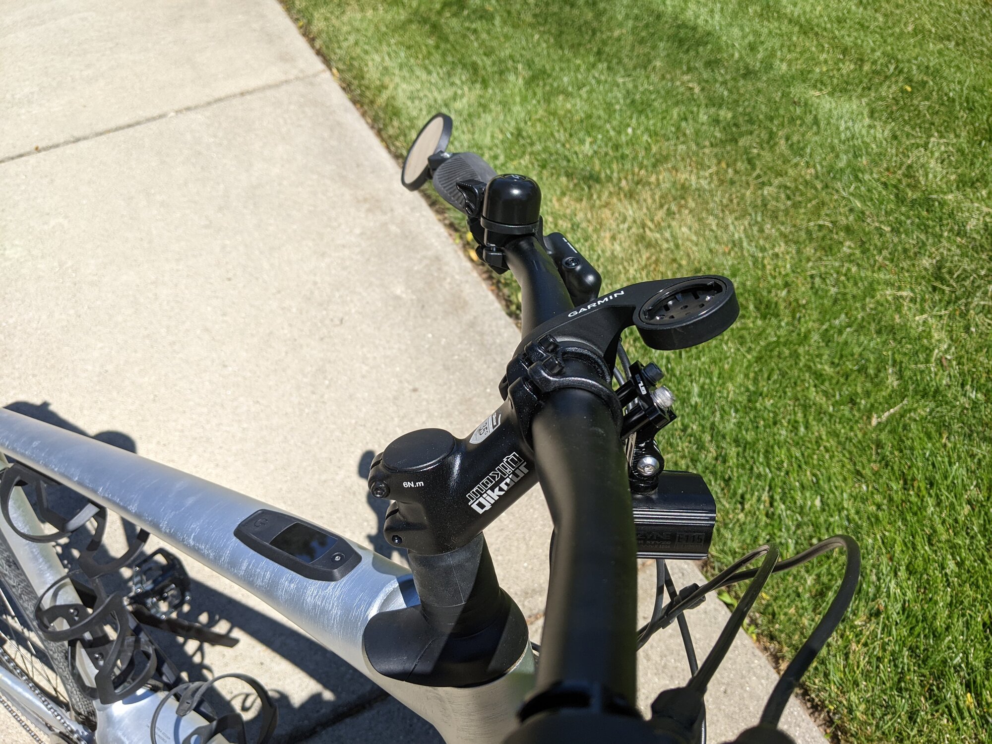

Unfortunately, there are few stem options for the 5.0. The OEM stem on mine is 75mm @ 14deg and I recently found an 80mm@35deg stem that the stem calculator showed would raise the bars by 24mm and set them back 16mm, which sounded perfect. I installed it and found it to work well as far as bar position, but it was not usable in the end because the stack height was 42mm vs the OEM 40mm. On a FutureShock bike, you can only use a 40mm stack stem because the top of the stem has to be flush with the top of the FutureShock or else that special threaded top cap won't go on! IOW, the stem would work OK on a 4.0 but not the 5.0. :mad: Here's a photo of the installed stem (the top cap is just setting in place since the threads won't reach).
Also note that some sort of adapter is needed for mounting the headlight vs. the one that's built into the OEM stem. Stems can also be raised by adding spacers, but it looks like the bike came with the maximum of three 15mm shims already installed.
I was able to return the stem and managed to find an 80mm@30deg stem with a 40mm stack that doesn't change the position as much but might be enough for what I'm looking for. However, I'd like to hear what your bike shop tells you.

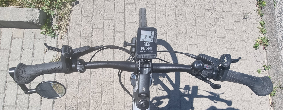

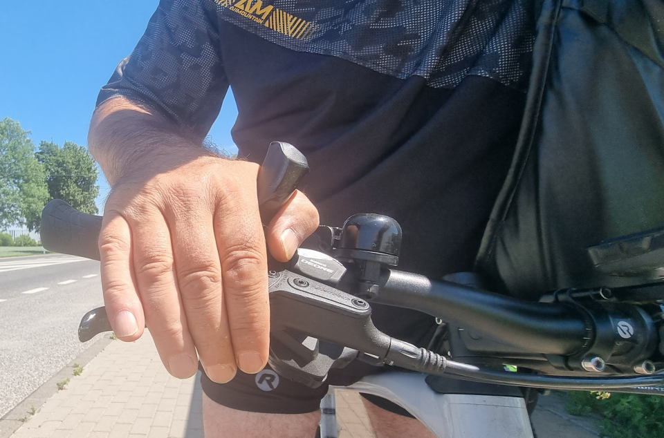

The SQlab 710 or 702 grips are integrated with with Innerbarends 410/402 to prevent people such as WIVado install the innerbarends in an unsafe position :)
Properly installed Innebarends ensure immediate and sure grip on the brake levers. The "hoods" distance is 42 cm there, as if it were a standard drop-bar.

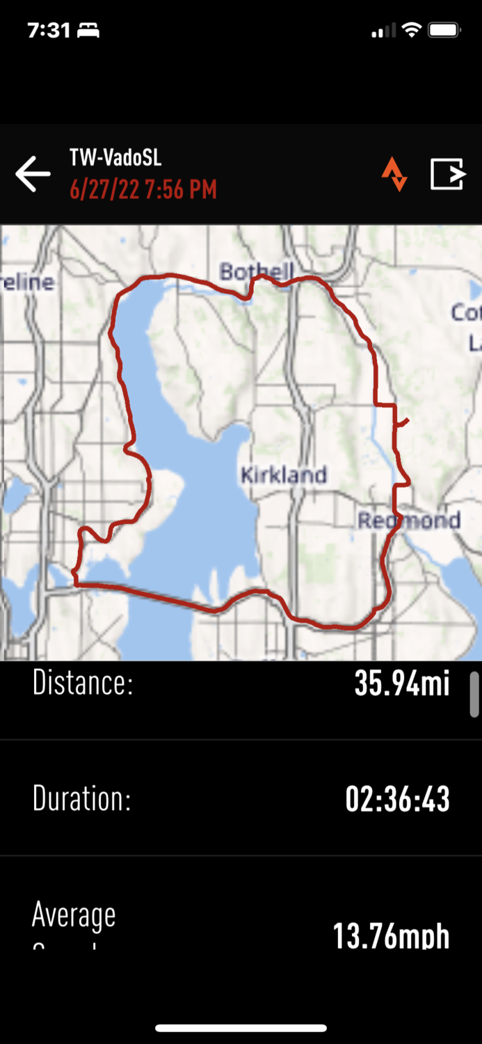

And soon after Thrilla in Woodenvilla attempted a loop of Lake Washington after work. That went very well.
- Stock saddle seemed fine,
- cadence was good,
- little bit of pain in upper back middle so going to LBS for another bike fit especially to check if it’s reach or forward angle causing it.
- Hills were fun with turbo and granny gear to the rescue.
- Lights get obstructed by cables
- Lights don’t stay straight
- Front suspension seems adequate
- Need seatpost suspension
- Need innerbarends and tape to create few more hand positions as I kept changing them towards brake lever joint, on the bar and at times standing straight and holding bar with fingertips or hands in air

When you changed the stock stem to adjustable/angled stem what did you do for the headlight mount?
I am thinking of doing a 30–60-degree angle and want to find a place for the headlights.

I used this: https://www.amazon.com/dp/B07CPJMCDX?psc=1&ref=ppx_yo2ov_dt_b_product_details. It was not without issues, as I had to use a file to narrow the center tab so that the headlight would fit over it. It doesn't matter now since I am out of ideas for finding a riser stem that works with the FutureShock. The Ritchey stem that I just got was listed on Performance Bike as having a 40mm stack height and when I received it I found that it was 45mm. :mad:

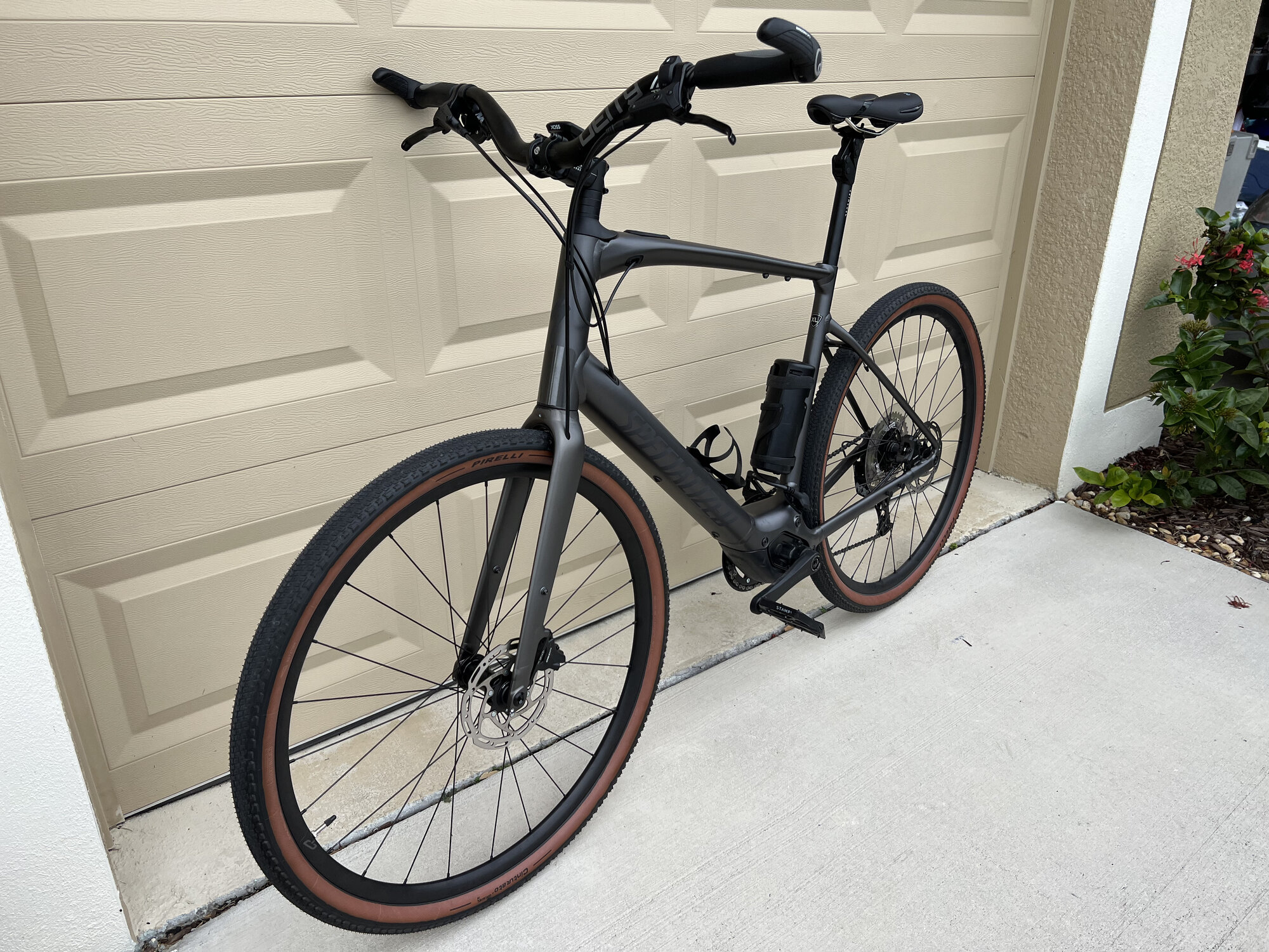

Well I have about 350 miles on the SL4 now and am really enjoying it. I've reached what I think is the final configuration, though I also have a set of 50mm Schwalbe Marathon Almotions that I really like. Installed in the photo are the 45mm Pirelli Cinturatos, measuring 47mm on the bike.
After years of running the Cane Creek Thudbusters I've given up on them and turned to the Redshift suspension post. I like it a lot better, and I think it looks much better as well. The weakness with Thudbusters has always been the clamp mechanism. Adjusting tilt is like guesswork, it's a real pain. Also, the one I tried on this bike would not stay in one position no matter how hard I cranked it down. Back it went.
At first I had the 30-degree Redshift stem but I didn't like the way it pointed straight up in the air, so I swapped it for the 6-degree and installed the Deity 80mm riser bars I had on my Vado 5. Since I need the bars an inch or two above my saddle this is working very well.
I'm riding in flat Florida and pedaled the bike to 25.6 MPH today, at max effort in light wind. I think the bike has enough power for my needs. The only time I have wished for more is in an intense headwind. On this bike I find myself averaging around 17MPH, and I only use whatever power I need to get over 16. I am definitely burning more calories than I did on the 5.0!
All in all, great bike and I'm happy with the purchase :)

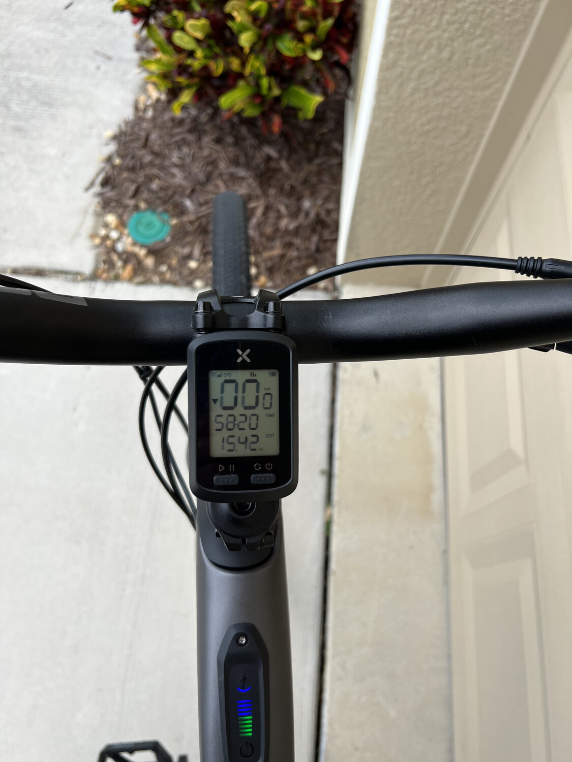

For anyone who just wants accurate speed, time and distance, that $30 rechargeable bike computer from Amazon works extremely well.
