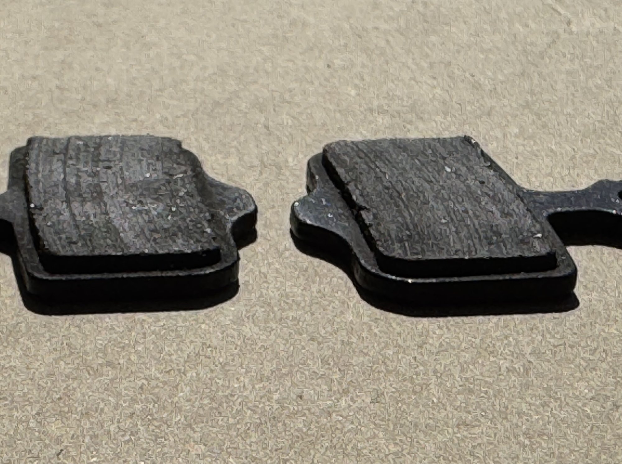

I have no clue Jeremy, but I had 4x stream crossing on a recent ride. Therefore I had something going on with my wheels/hubs, so cleaned them out. the squeak was still there. Hoping it was not my Bottom Bracket! So, not audible in the bike stand prior after my cleaning, I heard it from the rear. It was my brakes! uneven wear caused a ridge. the SRAM Apex brakes suck from the generation I have. I filed off the ridge on the pads and the squeak is gone. So, I am not suggesting that your noise is from the same issue. but sometimes it takes a bit of troubleshooting. Good luck!
