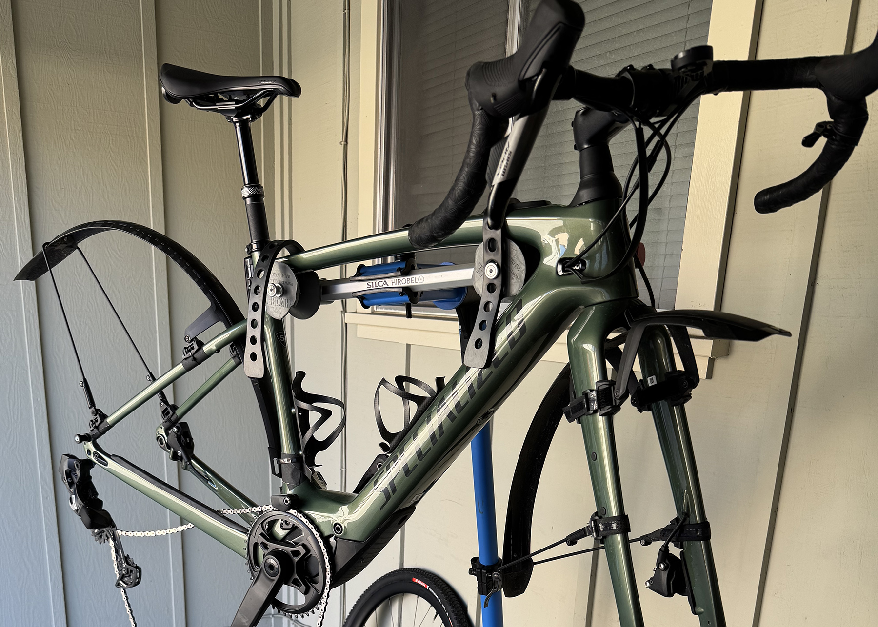

My experience: For my first full suspension Mt. Bike over 10 yrs ago,I had my dropper post slammed so the collar was right at the seatpost clamp. I was uncomfortable clamping the extended post. so I found the Silca Hirobel device to attach to the bike repair stand. I use it with all of my bikes. it is not cheap, but useful. Works for my Creo. photo below
Thanks! That Haribol gizmo looks interesting.
