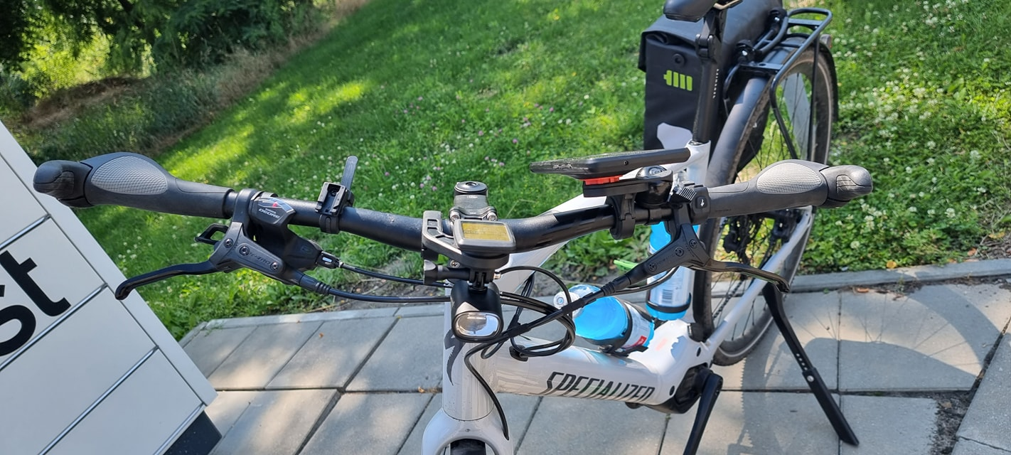

Dadelo, a Polish company that owns a large online bike store, has created their own brand EYEN. As I shop at Dadelo store often, I spotted an EYEN dual Garmin/GoPro mount there. Bought it, collected, installed. At last my Bike looks decent! :)
What mount is that ? I'm a little confused : I thought I saw somewhere that the TCD has a permanent mount SO obviously that's wrong ? Also if you got a rokform Stem mount you could move your phone right below the other stuff . ;) Maybe not for u ?
Now I’m curious if augmenting the Futureshock on my Vado 5 SL with Redshift ShockStop would produce any benefit.
Augmenting it with a ShockStop seat post would be great. Adding a ShockStop stem on top of a Future Shock would not be great. It would be a hot mess. They would interfere with each other.
Eyen Mount Duo. Probably only available in Poland.
There are two different displays by similar names.
TCD is an optional, portable, and wireless display for Levo, Kenevo, and all SL e-bikes;
TCD-w is the obligatory, fixed and wired display of Vado and Como.
While you can place the wireless TCD anywhere on the handlebars (or not use it at all), the wired TCD-w has to stay in the mount at the stem because of the way its cables are routed.
Not every product available in North America is available overseas. I'm happy with the Spigen MF-100 mount for smartphones (it is a distant cousin of Quadlock).
