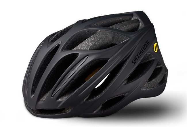

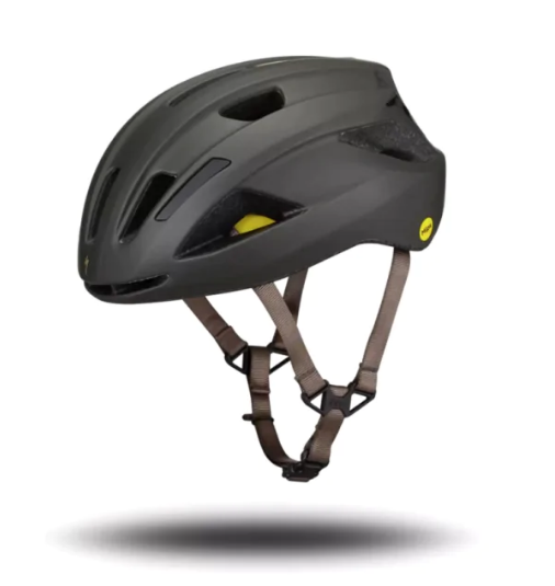

Specialized had beautiful highly rated helmets:
Echelon II MIPS.
Specialized Align II.

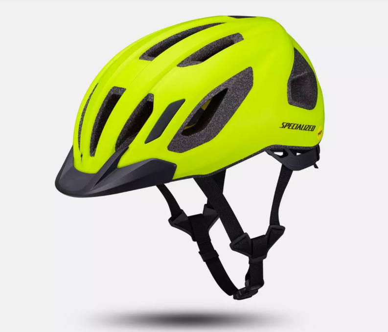

Now, those helmets went 'out of fashion', and the best you can get is:
Chamonix III. It is kinda... ugly.
Matter of taste — but of course, I look good in anything.
Love the Virginia Tech safety rating and ranking (No. 25 of over 250), ventilation, light weight, fit, and simple strap. Hard to beat for the price.

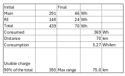

Not sure to what attribute the fact I was doing very well on a gravel group ride last Saturday. Were it the tubeless wheels under low pressure that soaked up the terrain vibration? Or, was it the 50/100% assistance that allowed me to ride in the lead for many kilometres upwind?
Yes, I rode derestricted but it only allows for riding faster than 25 km/h when the rider is pedalling with a solid input and especially downwind. The group were no racers, either. I loved the effect of the "100%" in the Max Motor Power term. It means a big boost from the motor if you pedal hard and fast. There was a longer and boring asphalt road segment. I sighed and started pedalling strongly. My Vado SL just shot forward, and I left the group in the dust! The max speed achieved was 42.2 km/h, and I must clearly say the terrain was mostly totally flat.
The battery consumption was reasonable in that assistance mode:
I rode for 70 km. Had to replace the Range Extender just 2 km before the originally planned finish line at the 77th km or maybe I would just finish with the derated motor assistance :)
