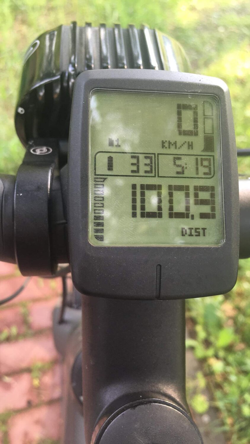

Here's my brother Jacek's latest performance on my Vado. 100.9 km and still 1/3 of the 604 Wh battery left! The maximum range would be 150 km (93 mi), while the practical range is 144 km (90 miles). Jacek had the motor set to 20/20 assistance for all the modes to not to be tempted for more pedal-assistance :D We rode both (I rode my Lovelec) and we had average speed of 25.12 km/h (15.6 mph). Note: Jacek could maintain over 35 km/h (21.7 mph) for 7 km (4.3 mi) at that assistance level. We actually caught up with a road-cyclist over that distance :D

Here's my brother Jacek's latest performance on my Vado. 100.9 km and still 1/3 of the 604 Wh battery left! The maximum range would be 150 km (93 mi), while the practical range is 144 km (90 miles). Jacek had the motor set to 20/20 assistance for all the modes to not to be tempted for more pedal-assistance :D We rode both (I rode my Lovelec) and we had average speed of 15.12 km/h (15.6 mph). Note: Jacek could maintain over 35 km/h (21.7 mph) for 7 km (4.3 mi) at that assistance level. We actually caught up with a road-cyclist over that distance :D
