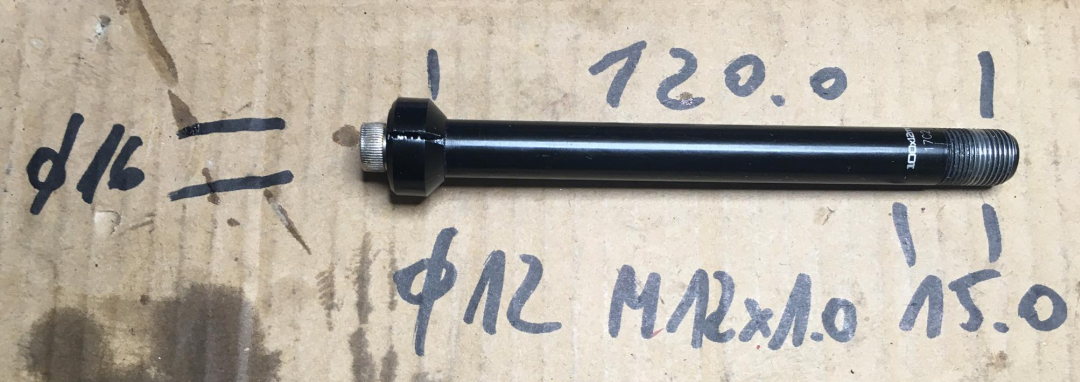

Need Urgent Information
I need to replace the front thru-axle in my Vado. Questions to @TS25, @Sierratim, @Brendon@TBSM or anyone competent:
I need urgent answers.
- Is this axle the 12x100 mm with 1 mm thread one? Please confirm.
- Do you know what make/model is available in the market?

The story of the front axle (2017 Vado 5.0) continued...
The Robert Axle Project 12x100mm - M12x1,0 117/123mm axle might not fit my Vado. Not sure what "117/123 mm" means but the original axle is 120 mm long:
I agree. I'd send a description of your axle, including all your dimensions and a note re the tapered head, to them at; https://robertaxleproject.com/contact-us/ . They've been quite good about responding to my questions.I would check whether the axle head fits but not worry about the length. Robert Axle provides a spacer underneath their axle head to adapt length between 117/123mm.
I have one from them on my road bike. They told me that the difference depends on if you have the tapered washer installed or not, which is dependent on the particular bike.The story of the front axle (2017 Vado 5.0) continued...
My brother has managed to fix the axle. You can see a bigger bolt locked in the original axle with Loctite Red.
It works!
