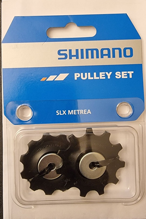

One of the derailleur pulleys in my Vado has worn out. As it is difficult for me to describe what the "wear" means in this case, I'll try to show a photo of the bad pulley once I have replaced it.
SLX METREA....is this not wrong? My Vado 5.0 has a Rear Derailleur which is a Shimano XT, Shadow Plus, GS cage, 11-speed which uses Shimano Pulley Set for RD-8000 (Model # Y5RT98120).
You are right. The SLX pulleys would fit although the ones you mentioned are better. Luckily, there was no need for swapping the pulleys.
