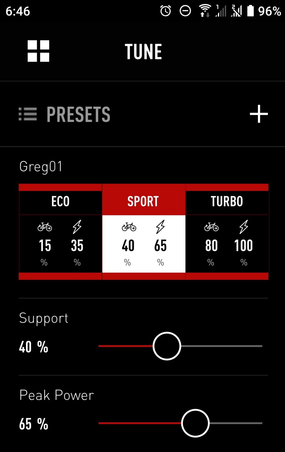

This is from a fairly average ride yesterday, although there was some headwind/tailwind. Settings are as usual, Sport selected with settings shown. Just using the internal battery.
Bike turned on at start of ride and nothing touched after that. I was riding with one other person, side by side all the way so no drafting at all.

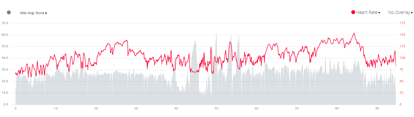

On the graph below red is my heart rate and grey is my speed.
There was a slight headwind during the first part of the ride and you can see from the graphs below I was sticking close to the 27.5km/hr where the boost cuts out.
The middle part of the ride (from about 38km to 48km mark) has some hills (up to 20%) and then a tailwind home so frequently above the 27.5km/hr motor cutoff.

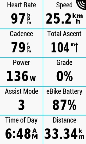

View attachment 43766 View attachment 43767 At 33km have used 13% battery

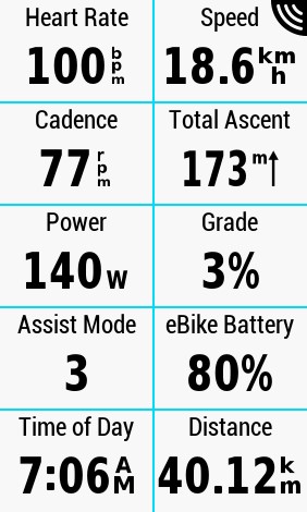

View attachment 43768 At 40km with first climb, have used 20%

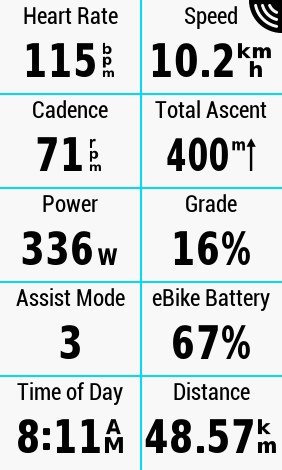

View attachment 43769 End of second climb 33% battery usage

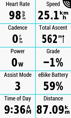

View attachment 43771 At the coffee shop, used very little battery between 48km and 87 km due to tailwind.
Extrapolating these figures, on this type of ride I could expect something like 100/41 x 87 or just over 200km range.
