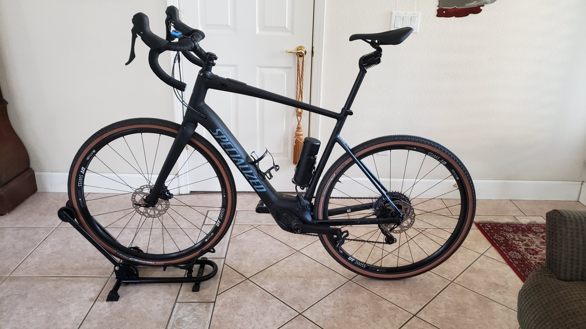

I'm running the same tires that are stock on the Creo EVO (Pathfinder Pro 700 X 42mm). Other than a dropper post, my bike is now effectively an EVO. I've had the bike for almost 3 weeks and have put 366 miles on it. Less than 20 miles have been on gravel road or dirt trails. I'm confident the bike can handle moderate off road but I'm happy on asphalt trails. Although I love the bikes responsiveness and handling without the Pathfinders and suspension seatpost, I found the ride a bit harsh. The Carbon models are purported to absorb bumps better but in my test riding I didn't notice much if any difference in that regard.

With the addition of the SPD SL pedals I have had no pedal strikes. I did some adjustments to the seat post height and fore/aft position. Also have the Kinekt seatpost suspension adjusted to the softest setting. Although the Future Shock 1.5 helps absorb front bumps, the switch to Pathfinder Pro 700 X 42m tires has made the most difference in ride quality. The larger tires give me more confidence going off road on gravel and mild single track trails but also perform great on bumpy paved streets/trails.

Here is a pic of the current setup with the Pathfinders. View attachment 63740

Standard tire on the Comp Carbon EVO in the US is 700 X 38. I wanted the largest tires that fit and my LBS as well as Specialized Rider Care recommended the 700 X 42 Pathfinder. I've got arthritic wrists and many other breakdown issues that occur at my age so anything that assists with bump absorption is welcome.
