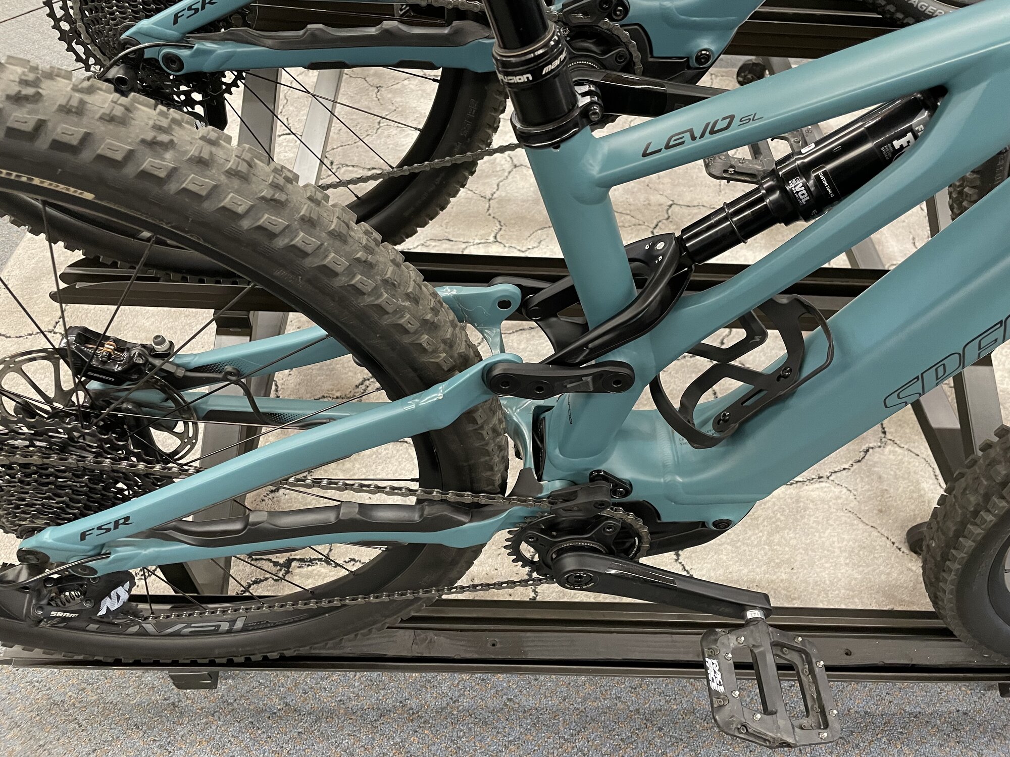

Specialized shop with medium framed Levo sitting there
Dallant
I took it for a test and liked it but $5k seems a bit outrageous. They have a small Levo SL too but $7k is nuts. Is this part of the recent price increases?
The SL you mention must be made of carbon fibre. Five grands for a premium aluminium e-MTB is a regular price.
The SL evidently stands for Super Light with carbon fiber and has a less powerful motor. The Levo came with no display but I did really like it. It climbed a very sharp incline well but I didn’t quite have the cadence right so I had to bail out just before the top.
Oh, Jim already wrote the facts before I did it. Levo comes without the display. You can either buy the wireless TCD or keep smartphone in your pocket or you can connect the bike to your smartwatch. It is not a Bosch e-bike 🙂
@Dallant, five grands is the money that perhaps buy you Trek Rail 5 or Giant Stance E+ (not sure on Trance E+ though).
Ok, what’s the diff between Levo and Turbo Levo Comp?
there is no naturally aspirated (non-turbo) levo, but the base turbo levo is aluminum frame, 500wh battery. Turbo levo comp is aluminum frame, 700wh battery, other improvements to the components. Turbo levo expert and up are carbon frame, 700wh battery, lots of other improvements. there are also all new versions this year, easily identified by the new display / control unit on the top tube which has a little screen!
