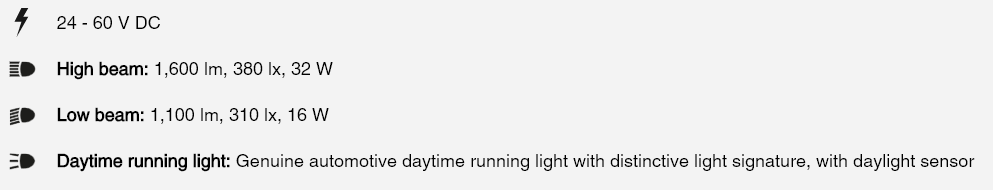

Be careful. There is only one Vado 6.0 model that supports high power light output. The light is Supernova M99 Pro (€464,09) that provides:
However, that light must be served by a compatible motor:
  • Specialized 1.2s or Brose TF, or
  • Bosch Performance Line Speed
