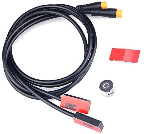

Then you lose the brake motor cut off.
Hydraulic brake sensor.
You would be swapping. This is akin to swapping one tire for another but in this case swapping one wire for another. It is not more tires or wires on the bike.
Where does the cable for brake cut off go? I see 3M tape on the sensor. Looks like a extra cable to me.
I am making the assumption that you have wires on your current brake levers that lead to connectors, then they lead to a bundled wire harness, which leads to the controller. If you pull one of these brake lever cutout wires from its connector by the HB it will have a yellow end. Inside are places for three brass pins. The new wire goes in there. Toss the old lever with its wire. Install the new lever. Then the little circular magnet @tomjasz showed gets epoxied to the new lever. And the 3M peal-and-stick goes on the lever's base. A drop of super glue before you stick it, goes a long way. The distance from the magnet to the pickup should be about the thickness of a nickel, 2mm. After its installed, a drop of black nail polish from the dollar store will make the magnet disappear. The entire installation of new pre-bled hydraulic brakes will take about 15 minutes with no mess. The wire install can be on the underside.
