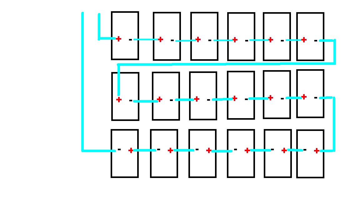

So here we talk about power for the rest of your time when you aren't on your ebike or even on the grid .
Solar panels, charging and discharging batteries, inveters and chargers, running large loads during peak sun hours. Etc. etc.
