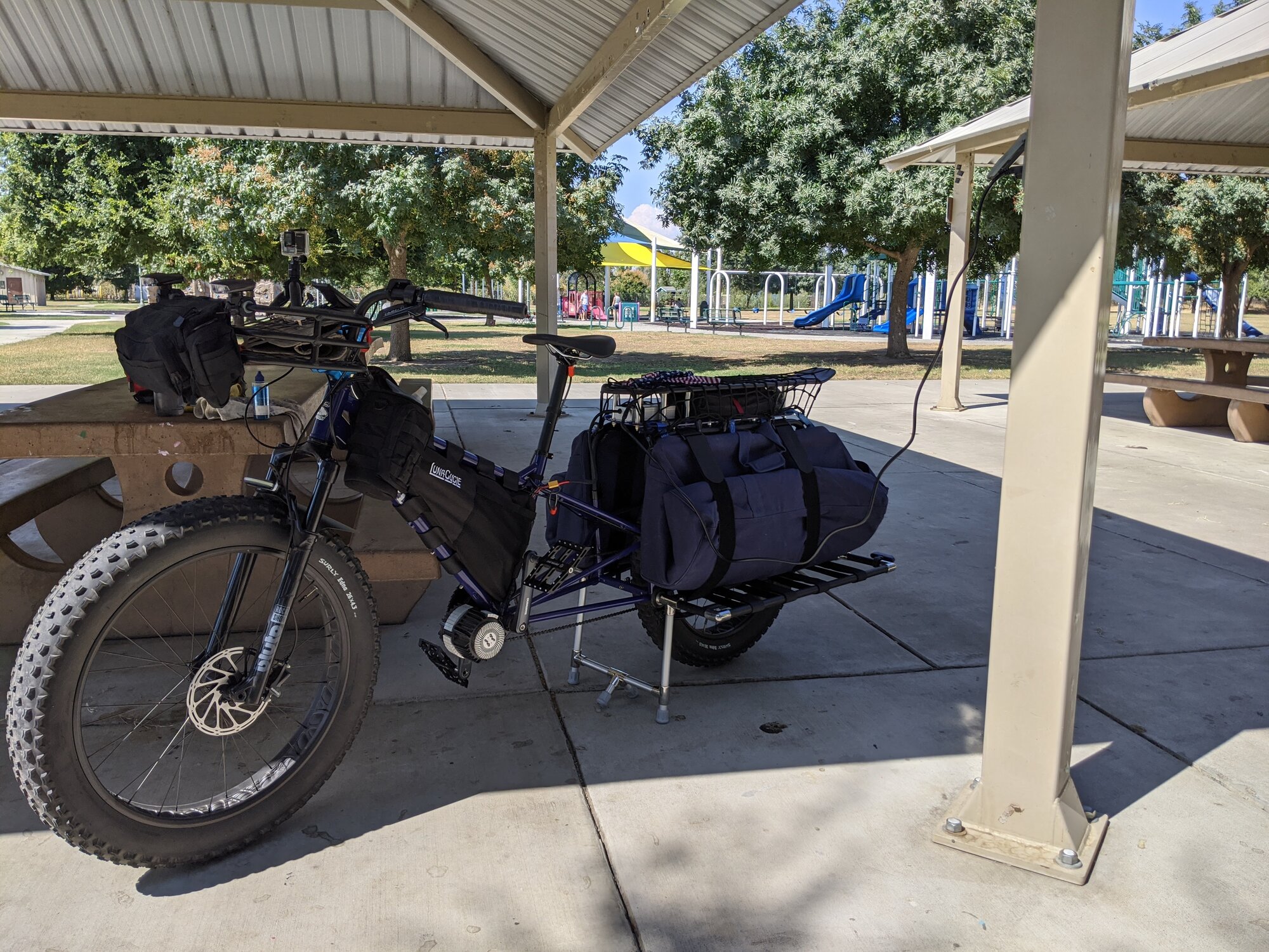

Riding bikes like a Surly Big Fat Dummy... you are pretty well screwed with respect to flipping it over, or even using a bike stand in your garage. Lots of folks use a come-along thrown up over a rafter and looping back down to hoist the bike up. I have been able to get away with a couple bricks under the 2-legged stand.

I forgot to mention I made a portable workstand. What you see is sitting inside of a receptacle on the wideloaders I made. the 'U' shaped stand is a separate piece and you raise the front wheel and lower it down onto the 'U', which is free-standing and - on a bike this size - is not noticeable with respect to weight or carry convenience.
In the pic, its hard to see but the rear wheel is up off the ground and is free spinning.
For my Bullitt, I either use a couple of bricks to raise the existing factory 2-legged stand, or trolleys like these, one under each leg so the wheel is up off the ground and you can spin it around like a top if you want.

Nope :) That was that bike early in its life. Nowadays it has a retractable 2-legged stand (I bit the bullet and bought a Rolling Jackass) and recently I put a 32T front chainring on so I could use it overland in the Lower Sierras on a camping trip I would have been coming back from today if the Forest Service hadn't closed all forests in CA due to the fires :-( Maybe this winter.
