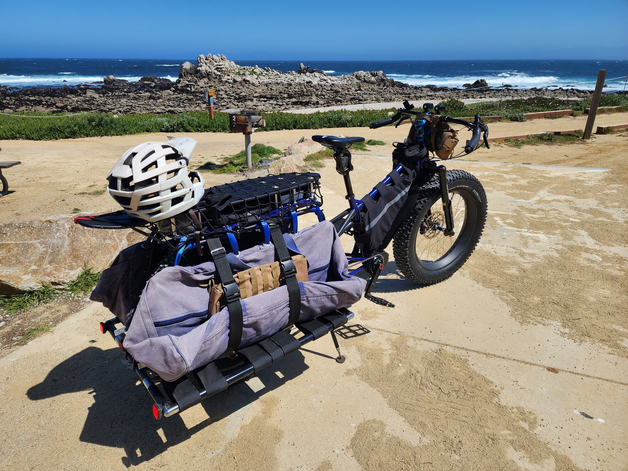

BEFORE: More upright position and Ergon ST Core Prime in Large size (click to embiggen).

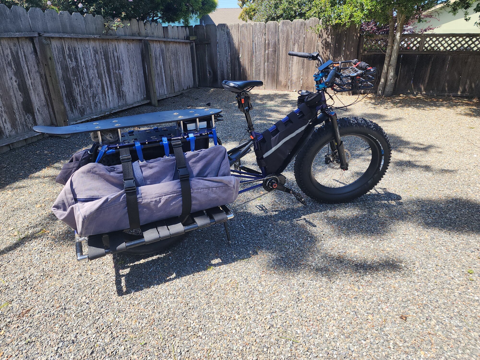

AFTER: Lower handlebars and the Ergon didn't fare well. Swapped in my 16 cm Ergolux from another bike and problem solved (except now I have a bike with no saddle on it). This pic was two days ago.
Note the different top profiles of both saddles. The SQLab looks angled down but its not. Thats the ischial padding making it look that way. Nose of the saddle is parallel to the ground.
