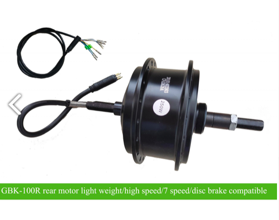

I know you aren't interested in building. However, the little Bafang and GBK geared hubs are pretty lightweight (5 lbs GBK) and adequate. torque sensors can be installed too. I bought a GBK GD just to finally see what's what. A neat little hub drive!
