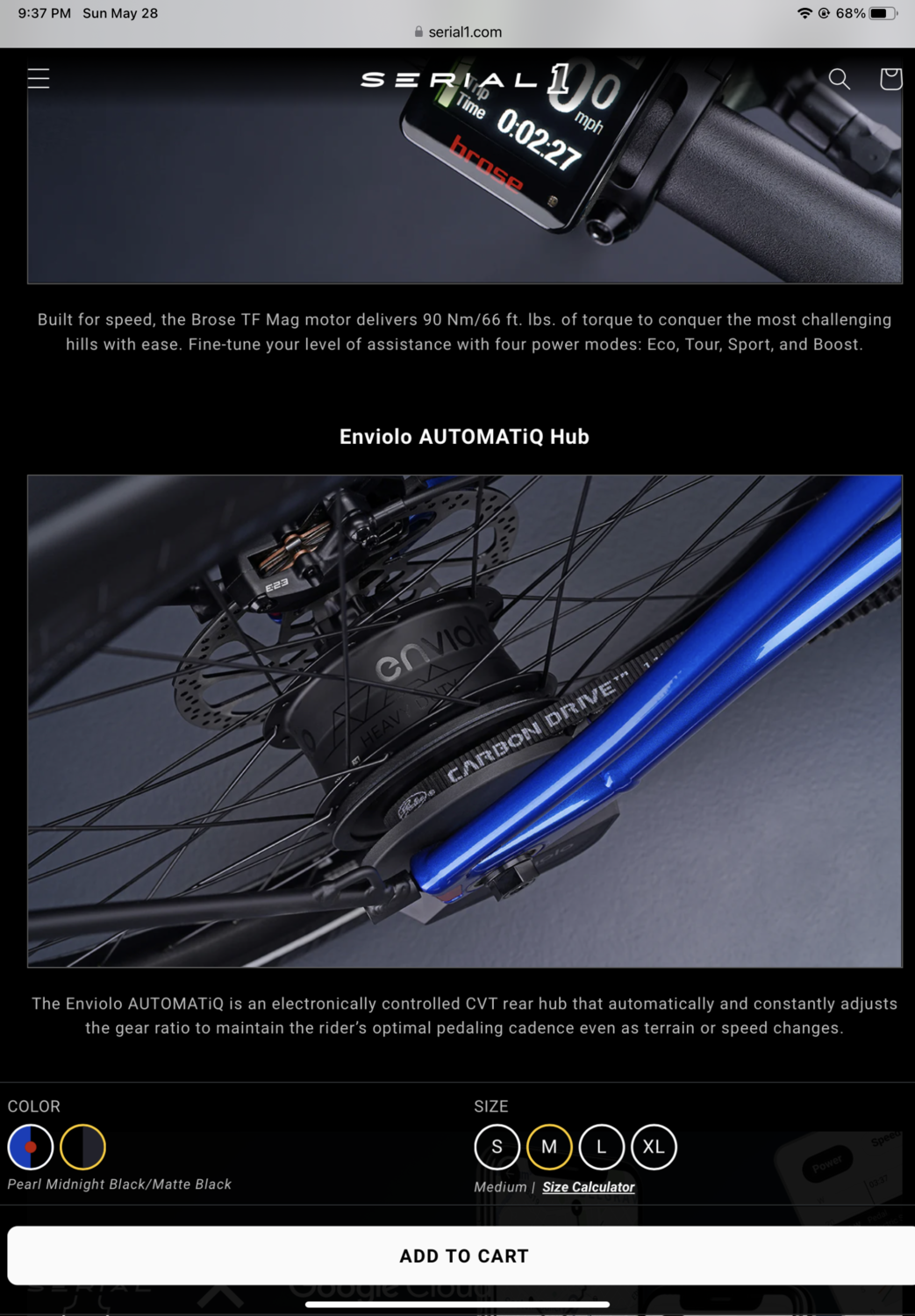

Both are not necessarily true.
- My Serial 1 rear wheel can be removed and reinstalled without having to adjust belt tension. The tensioning system and its setting is not touched when removing/installing the wheel.
Enviolo equipped removal @ 1:40 and installation @ 3:25
- What kind of rear wheel repair are you referring to? Removing the wheel to repair a flat? If so, then no, the IGH does not have to be recalibrated…... At least not on the Serial 1. I’m guessing you would need to perform a calibration if you removed the auto shifting mechanism from the hub assembly or something similar.
BTW, the calibration procedure takes maybe a minute to perform. Easy peasy! 😆 I have only calibrated mine once when I first got the bike just to make sure it was calibrated and to learn how to do it. I noticed no difference in operation after doing so.
