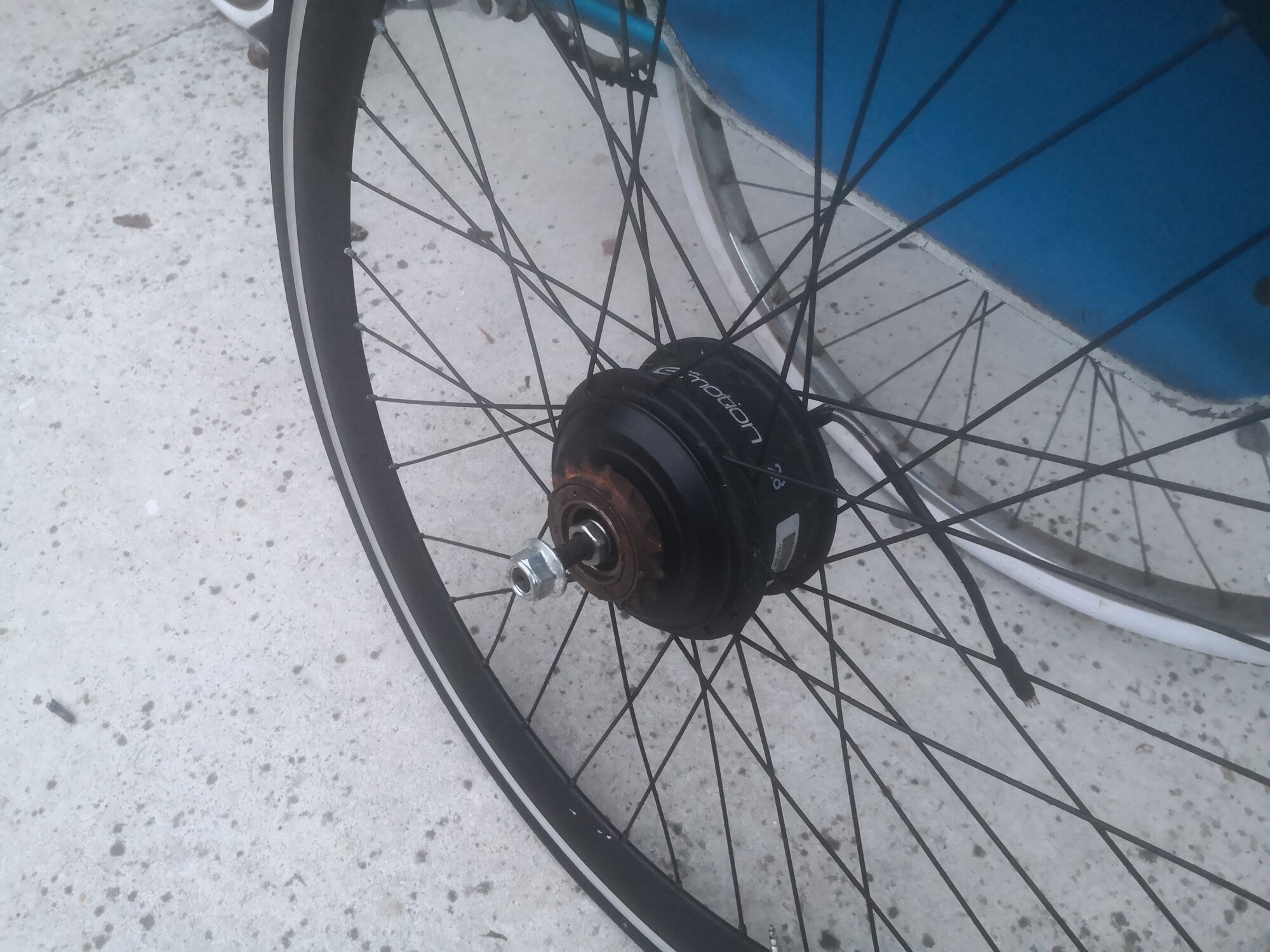

My bike is converted to electric, using a single speed hub. I got it from a wrecked easy motion bike.
36v 13a gets me 21mph, 48v @13a gets me 25mph. I think the gearing is 46/16T. At 25mph, to be honest is too fast for me to pedal so at that speed the bike is doing all the work.

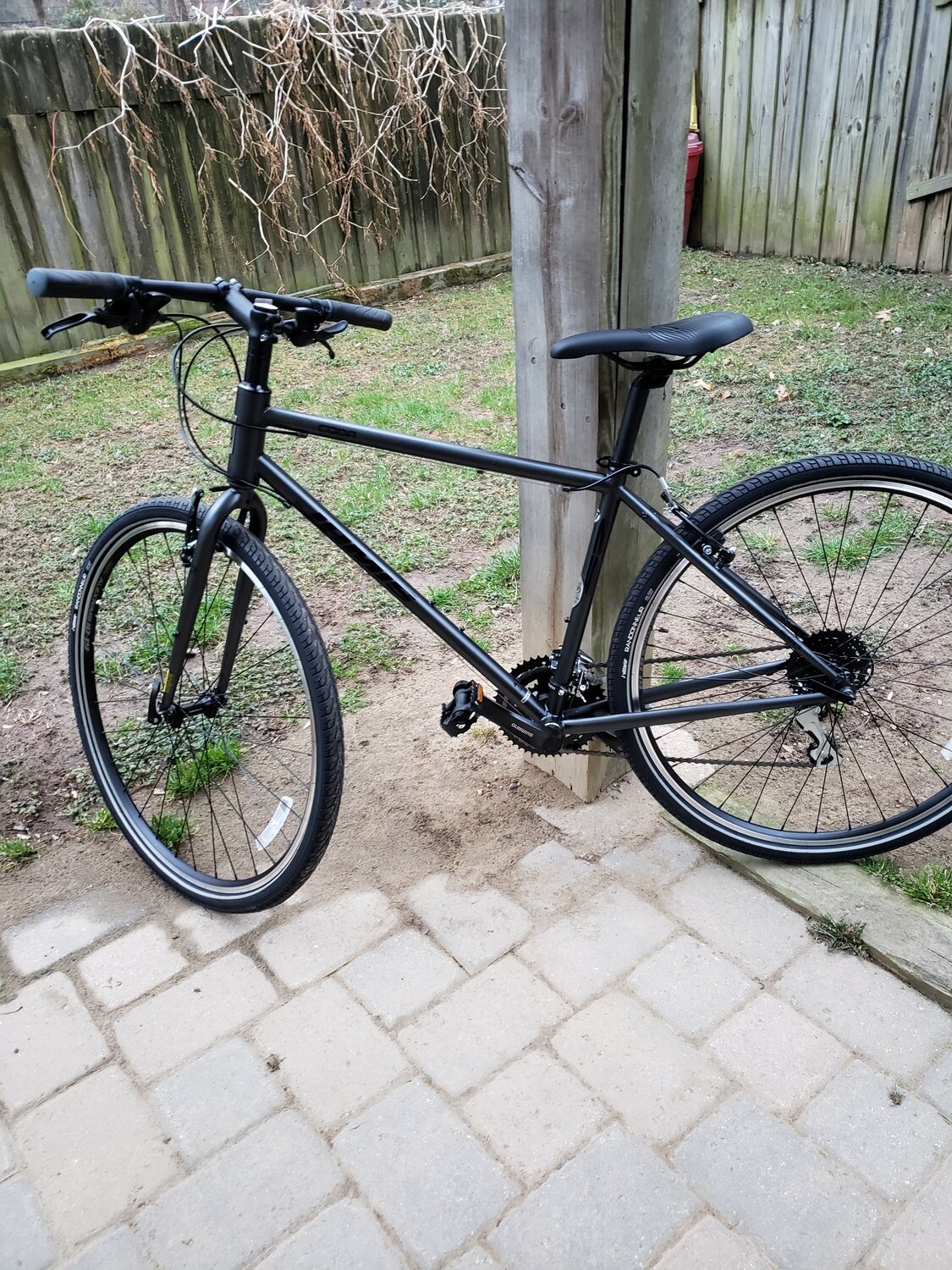

Well I ended up picking up a Jamis Coda S2 yesterday and I will ne ordering the Tdzs2 this week.

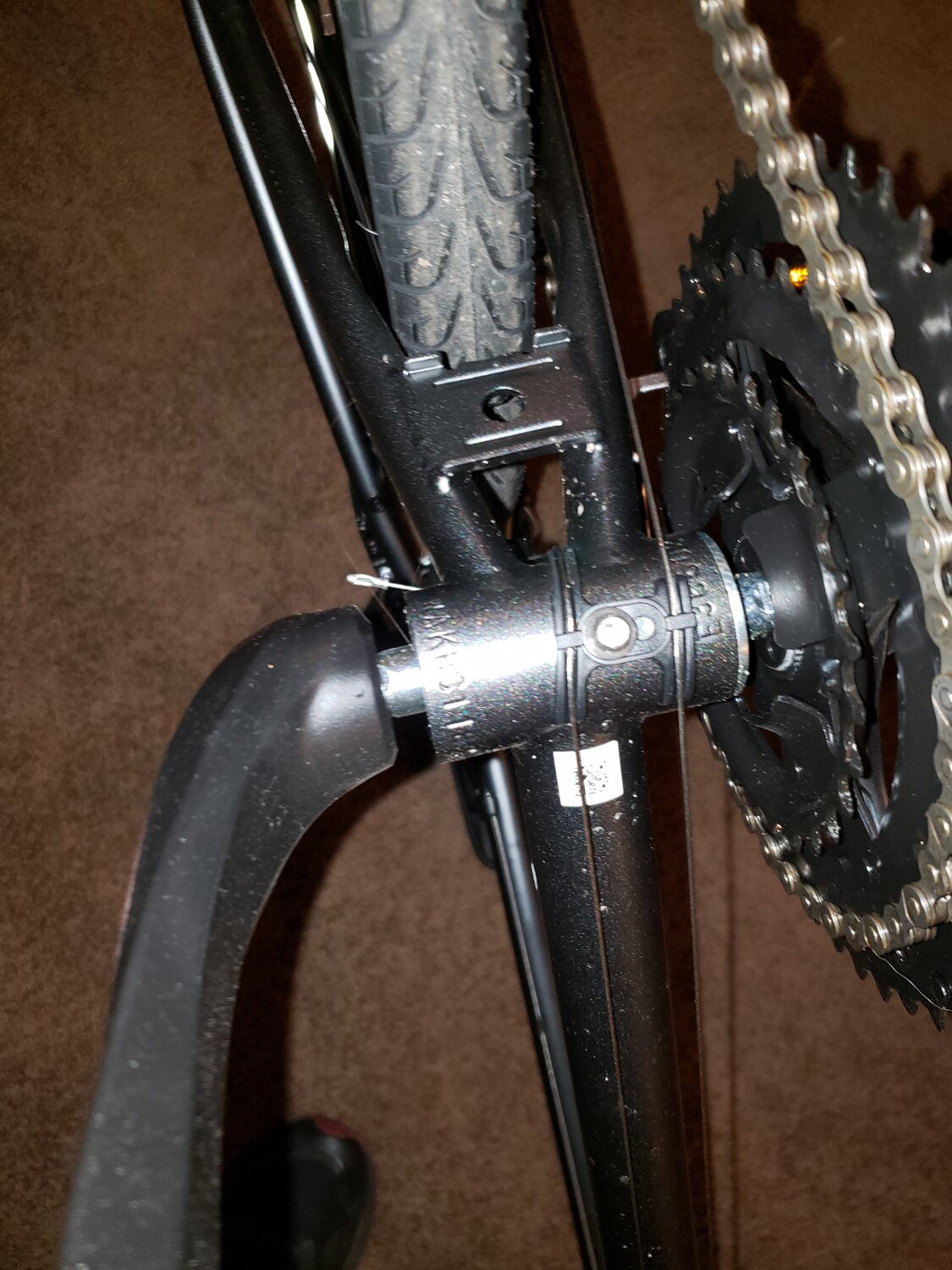

You will need to run continuous shift housing over the bottom bracket so that it does not get pinched. Here is an example. The black line behind the chainring is the housing going over the BB.
The secondary securing bolt needs to be longer and stronger for your bike than the one that comes with the kit. It will sheer by the second ride.
Is that the vertical bolt that goes thru where the kickstands usually mount? Around 2:05 in the video. There's another horizontal one coming up a few seconds later.
Yeah, as soon as I drywall the big hole in the ceiling above my head here in my den, I'll work on my TSDZ2,
The horizontal one is fine. I can sometimes keep a center kickstand. The vertical one is the one to replace with a M8 1.25 hex cap screw that is longer and stronger. It is placed very close to the bottom bracket on the chain stays.
