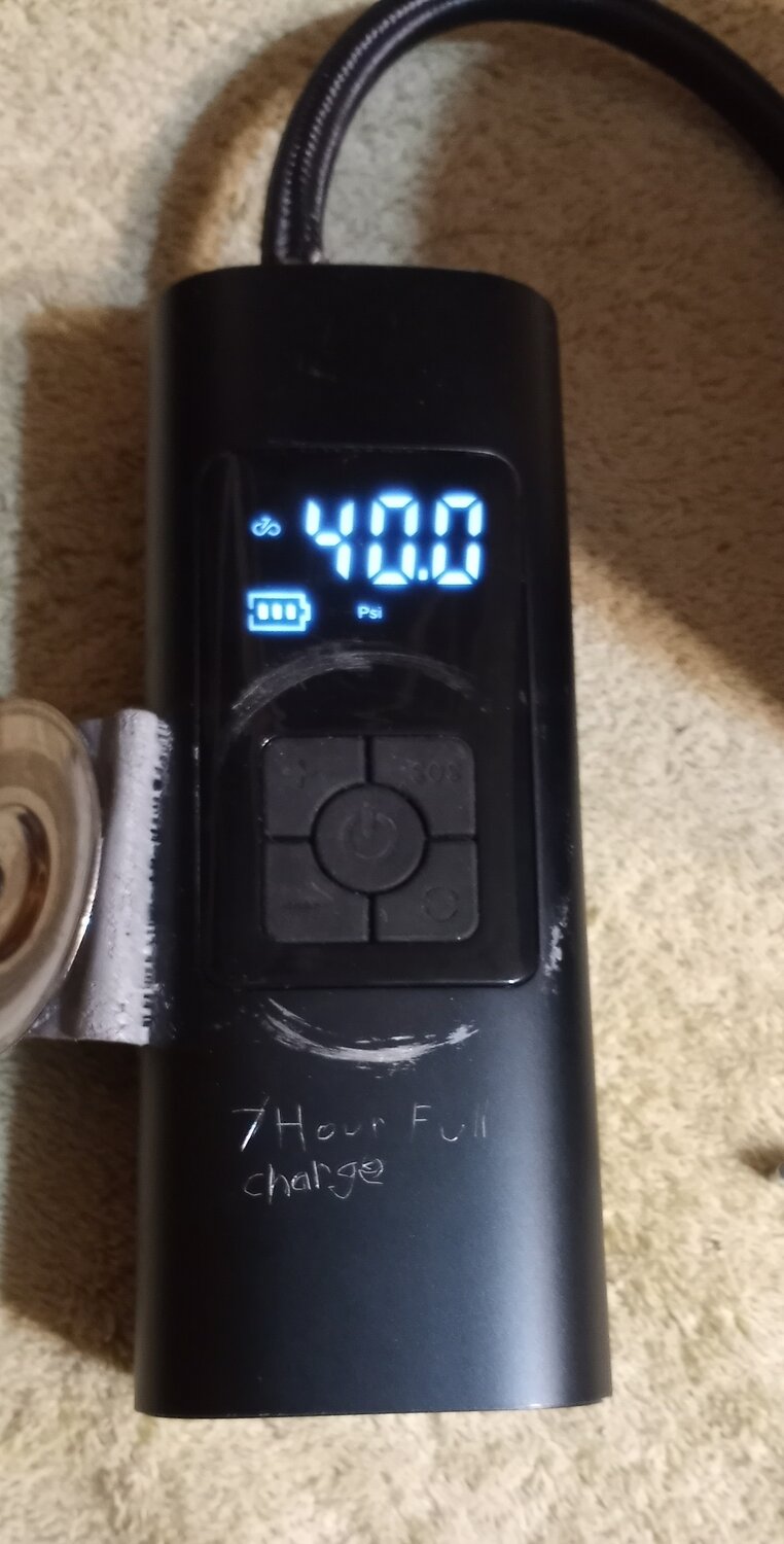

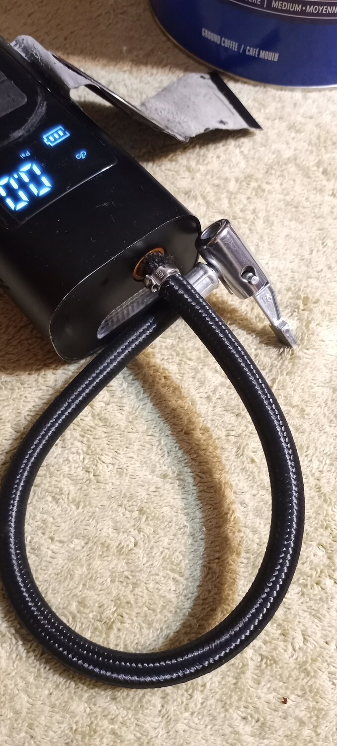

Now I'm using my rechargeable compressor.
My ebikes have Way More volume and I only pump them up to 40 psi.
The quick release chuck that came with it was a piece of crap and would fall off the valve, so I put on a new chuck with a longer hose,..

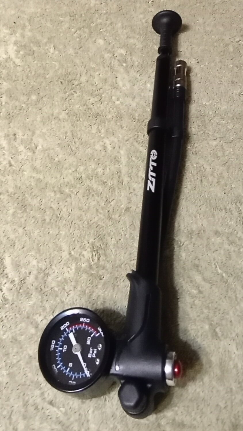

I only use it at home now, and carry my shock pump with me on my e-bike and it's got the bleed button,..
I can adjust my air shocks when I'm out riding, And it works Great to pump up my tires. It's got the long handle so it doesn't take 7 days and nights to pump up a tire like a 4" micro-pump. 😂
Alternatively... Fill the tire 1 psi heavy and then use a digital guage with a bleed button to be dead_on_balls accurate.
My rear shock is "inflated" to 185 PSI with a cylinder about the size of a pill bottle, so the tiniest loss of air when you disconnect the chuck makes a Huge Difference.
All chucks and gauges lose some air when you disconnect them, But the pump has a Really Cool chuck and it really works Slick !!
You use two hands to unthread it and with practice, you can remove it fast with the same amount of air loss every time, (you can hear it) so you can adjust for it.
I've got the air loss down to a microsecond hiss, and I still lose 25 PSI, but it's the same 25 PSI every time.

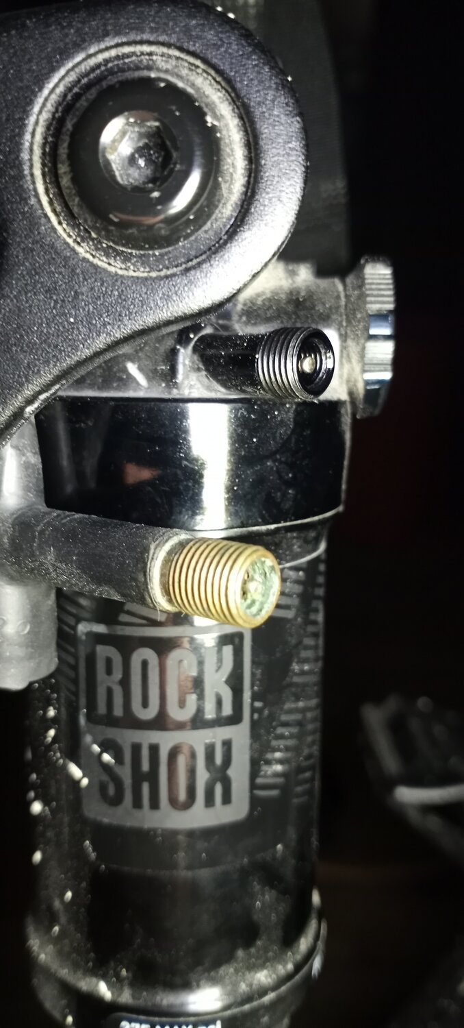

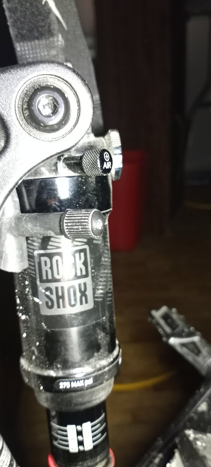

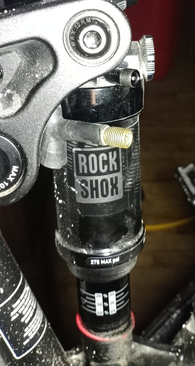

Actually, seeing the maximum pressure at 275 psi reminded me that I set my pressure at 225.
It's supposed to be set at the rider weight (185) but it's on a ebike with a second battery so I used my O-ring to set my sag at ~20% and that works out to be 225 psi.
And I've been ignoring the fact that the dirt on the O-ring is oily, so I think I blew all the "fork oil" out of the cylinder?
Apparently it's common to happen with Rock Shox
So I might be opening up another can of worms to replace the oil and gaskets ?
Maybe I'll wreck it while fixing it even if it ain't broke, then I'll have an excuse to upgrade the shock to one with adjustable compression AND separately adjustable rebound.
Maybe filled with nitrogen with a separate canister for it? That'd be Cool 😎

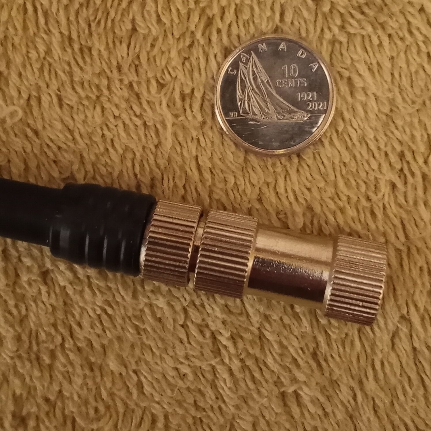

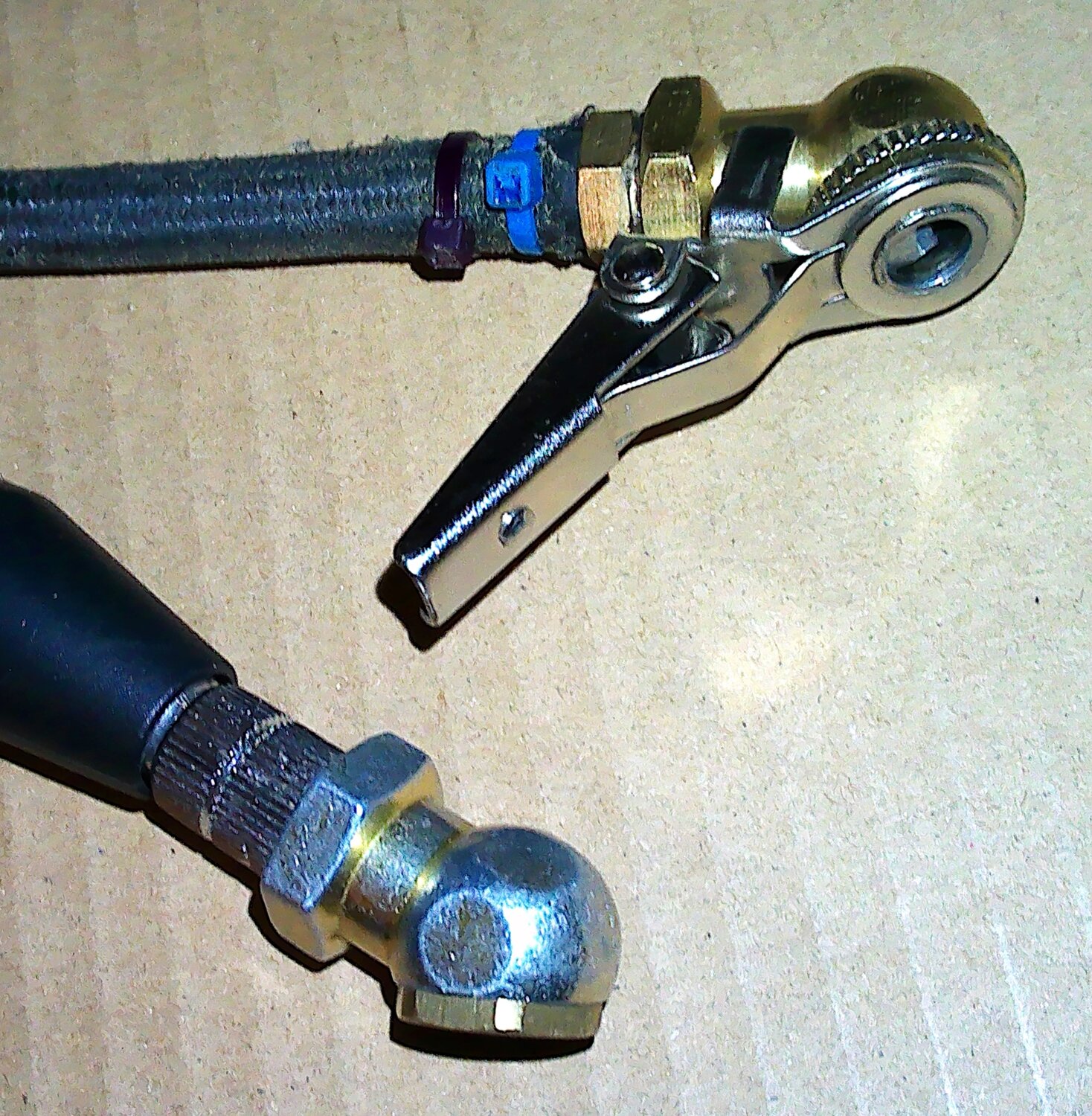

Ever hear of Carl Norgren? Ike invited him to both inaugurations and often visited him in Colorado.
Norgren invented the ball chuck in 1926. A Schrader chuck should have a rubber washer soft enough to seal around the rim and then let you push the chuck down to open the valve. In previous chucks, the soft washer would soon wear out. He solved the problem.
The lower ball chuck is on a 12" hose attached to a digital gauge reading in tenths. I can check a 2.3" tire at 50 psi ten times in a row without losing 1 PSI.
The upper one is on a 20" hose to my pocket pump. With one hand, I pull the clip lever, push the ball onto the valve, and release the lever. Taking it off is just as crisp. The pump reads in half-pounds. If I remove the chuck and put it back on, I'll get the same reading.
When Ike was prez, ball chucks were well made. Now many are substandard. I had to try my luck with several.

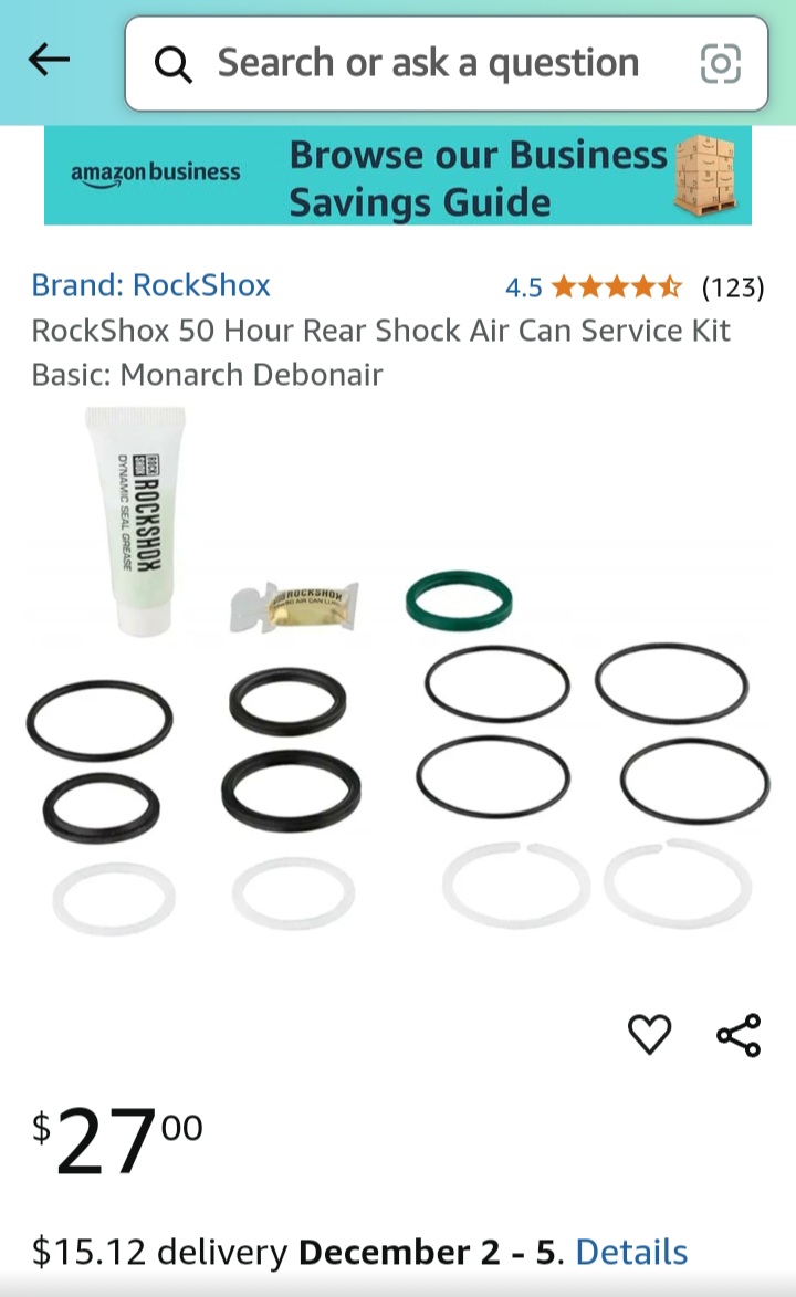

$42 CAD for a rebuild kit every year.
What a load of crap.
Maybe I'll just save my money and put it towards a new shock that doesn't leak.
Meanwhile, I think I'm gunna let the air out of the shock, remove the valve core, (thankfully its not a Presta valve), and give it a little squirt of an appropriate "fork oil"?
Maybe some anti-seize will work ? 😂
