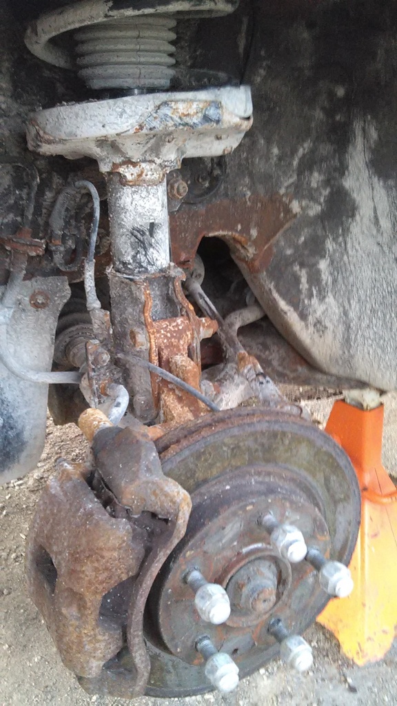

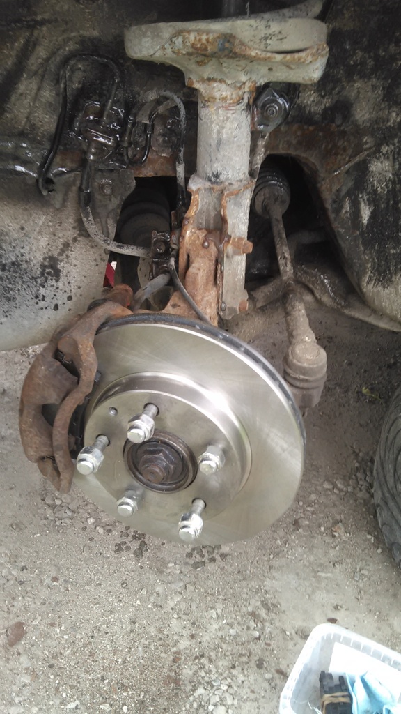

Permatex silver is not for wheel studs? Pfffft... every tool kit in a race track paddock on test'n'tune day has a little jar of that stuff somewhere, and it goes on the wheel studs.
The copper stuff is supposedly for brakes, usually as a 'disc brake quiet' thing, but I've never felt a need to put grease anywhere near a braking system. If my pads are squealing I just need to drive harder to get 'em up to temp.

One reason to use anti-seize or lubricate threads period: it prevents galling of the threads after repeated install and removal. Thats the reason we always used anti-seize on wheel studs on a car being raced on-track. You would do tire rotations maybe 3-4 times in a day and thats really hard on the threads... unless you grease them up and back off your torque spec by 10% to compensate for what greased threads do to the torque process.

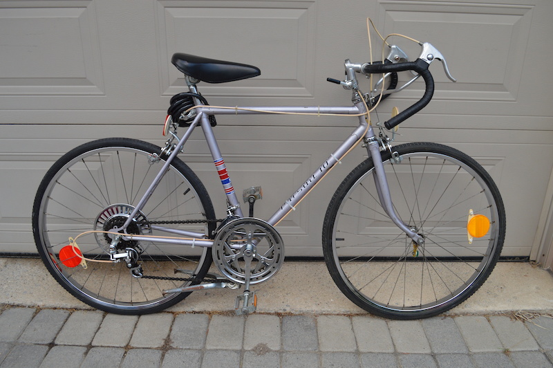

I had a CCM Pursuit 10 when I was 12 years old.
A ten speed like this,..
Shortly after I got it, the right pedal partly unthreaded and started to wobble. By the time I noticed, the pedal was cross-threaded and I couldn't thread it back in.
I used a hammer to keep smacking the pedal straight as I slowly screwed it back in, and managed to get it threaded all the way in.
Then I Tightened The Hell out of it with the hammer. 😂

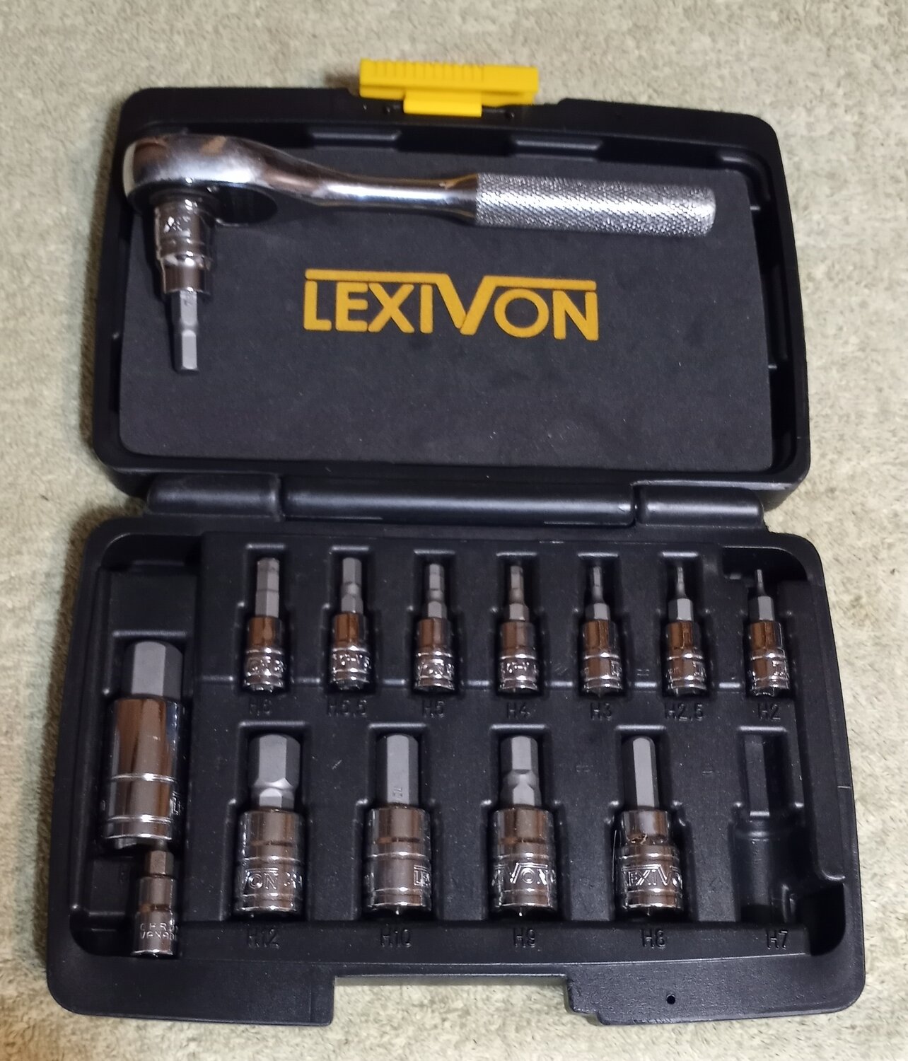

I use my socket set for pedals.
I would also recommend anti seize lube on the threads.
Like PCeBiker, I use this same type wrench combination anytime I need to remove a pedal.

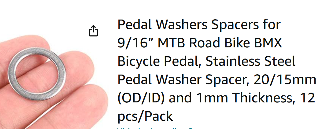

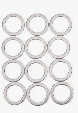

Also, I would recommend the use of pedal washers if not already on your bike.
I had never seen or heard of pedal washers and, hence, never used them on any of my bikes over the years. What is seen as the advantage of them?
Any reason a standard hardware store washer isn't good enough?
I have always gotten pedal washers when I purchased pedals. You can certainly try going to the hardware store but I think it may be a challenge to match up the typical dimensions. Pedal washers are fairly thin, polished, and the inside dimension relative to the outer dimension is not typical of standard hardware store washers. There are lower cost options, but Amazon requires purchase of greater quantiles than most will need. I would see what your local bike store may have or other online stores. Here is a typical photo of a pedal washer.
