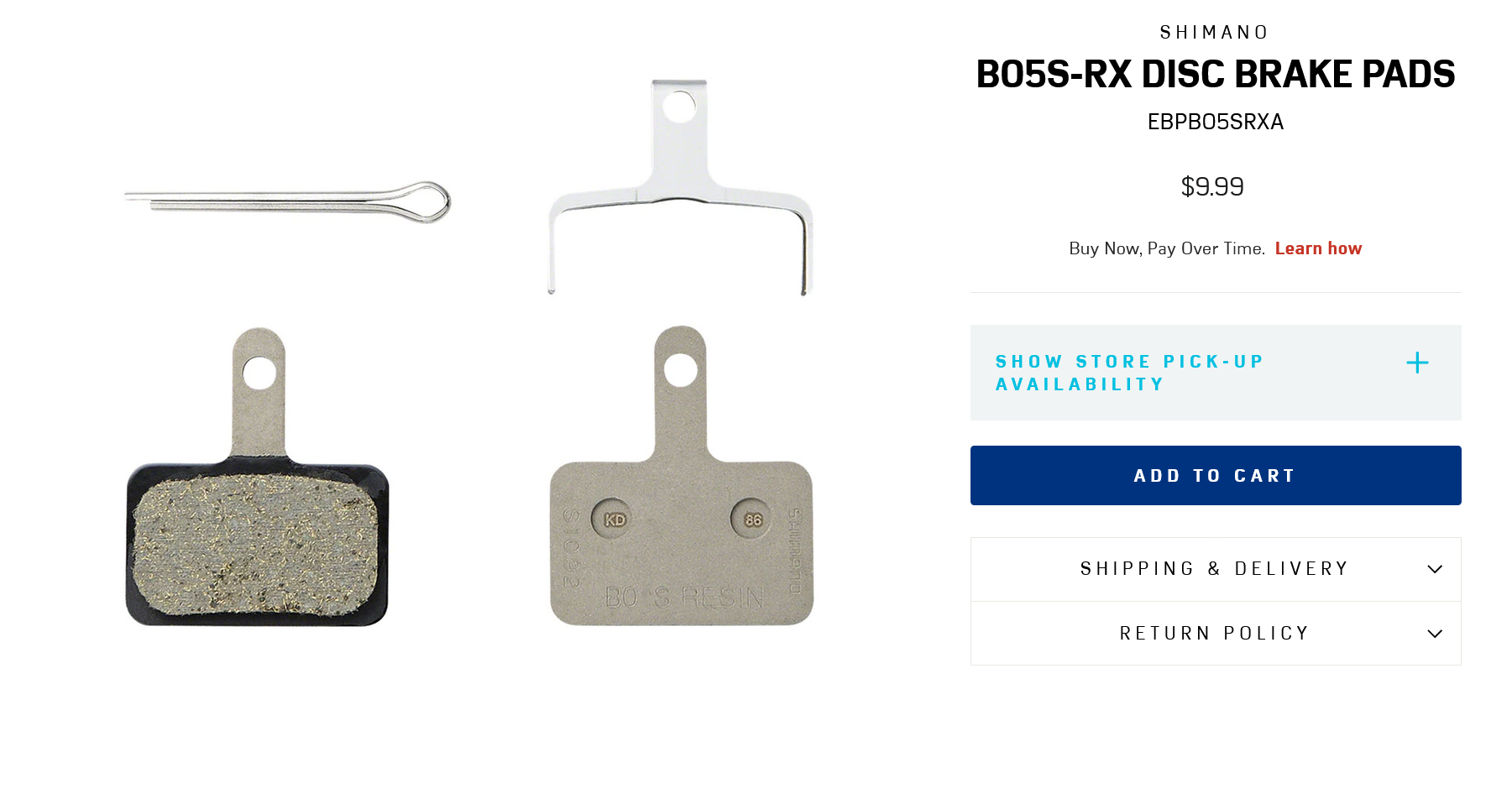

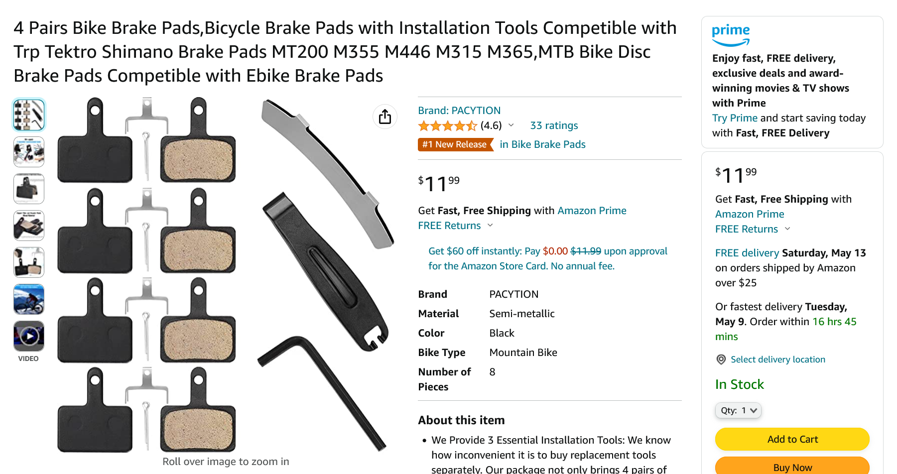

The goal of Pon Group who purchased Mike's Bikes it to make it into the 'Starbucks of bike shops.' It was a local Bay Area shop with a couple of locations in Marin. Then it expanded to 14 shops in the greater Bay Area. Now it has 25 locations across state lines. It is like getting a guitar from Guitar Center instead of supporting a local music store. The maintenance plan used to be a good deal but now at $700 it is too much, in my opinion. And it does not include any parts or eBike specific requirements. Here is one cost difference using brake pads as an example. What is better two for $10 or $12 for eight pads, plus tools. Mike's won't do a job unless they sell the parts at full pop. They are charging about 750% more for parts.
View attachment 153196 View attachment 153197
