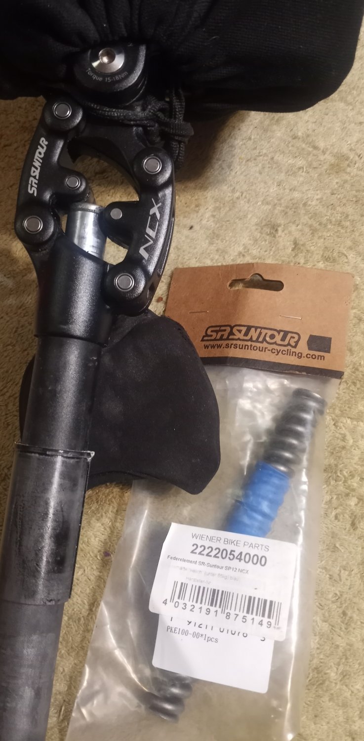

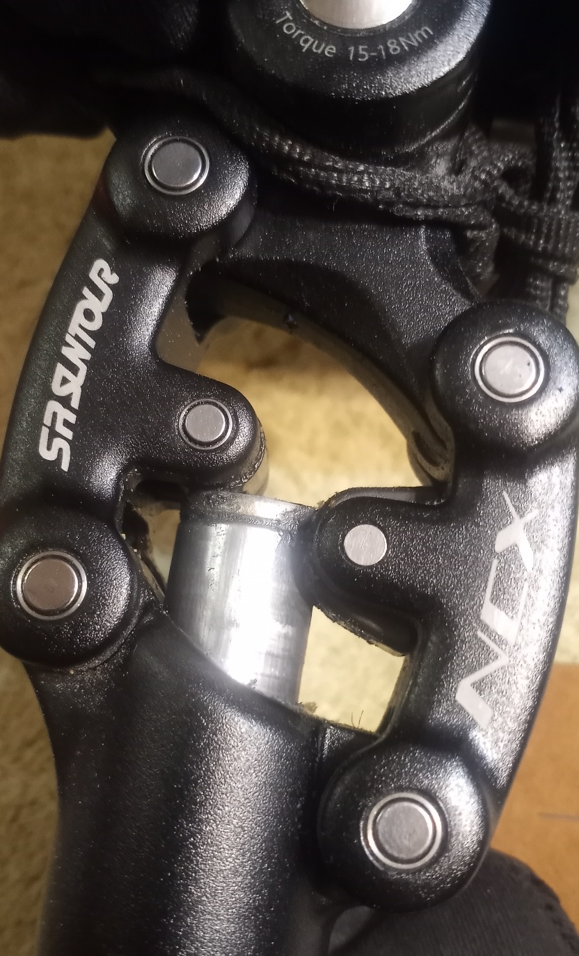

My Suntour NCX suspension post is doing OK after ~7000 km.
There's a tiny bit of wear in the bushings. I can feel it when wobble the seat around, but it's not too bad and doesn't feel dangerous.
Maybe I'll clean it when I install the softer spring ?
