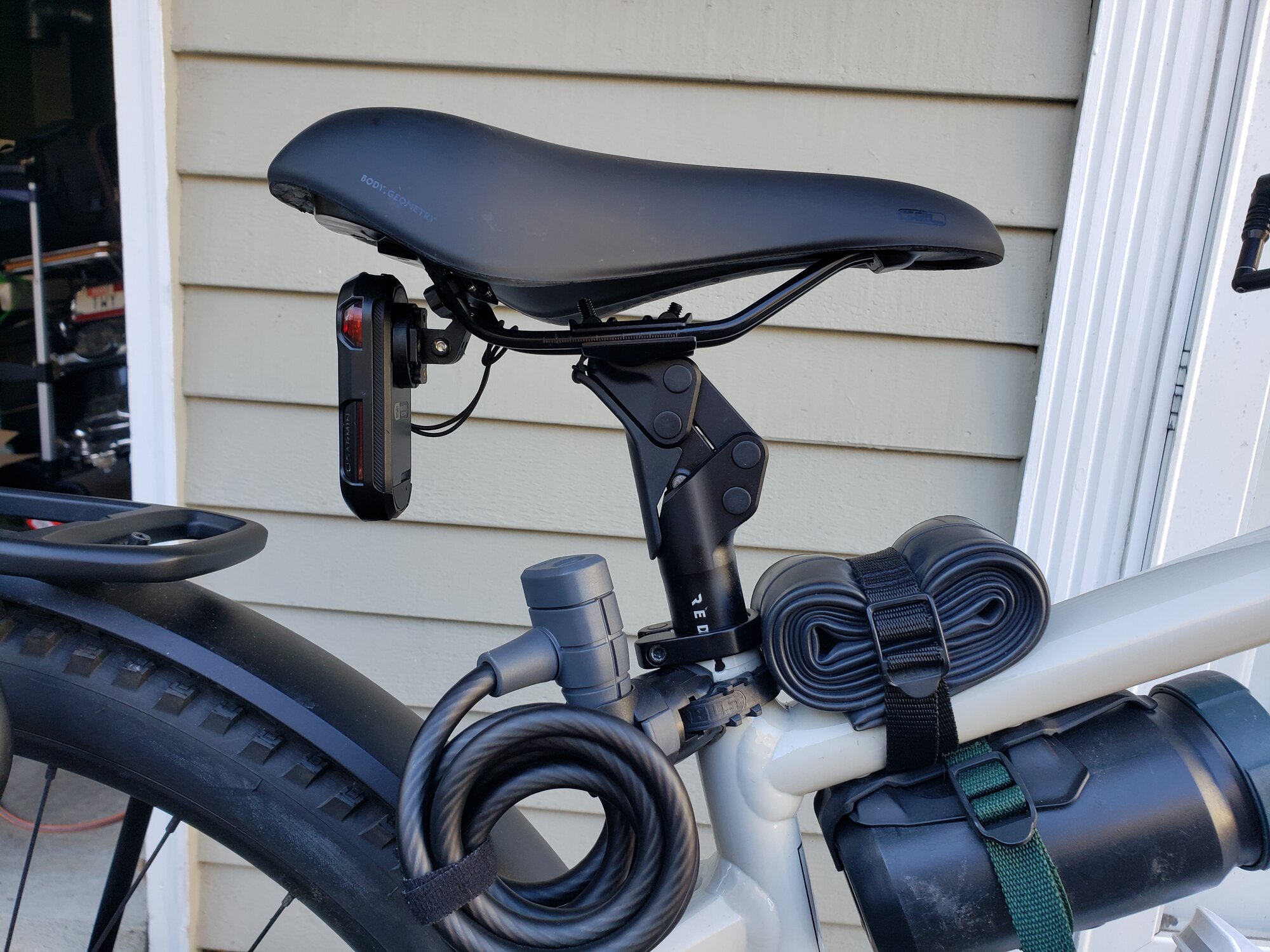

I bought a Tero 3.0 and put about 1100 miles on it so far but was not happy with the harshness over bumps. I looked at both the Kinekt and the Redshift and chose the latter because I needed to minimize any additional seat post height. I installed it yesterday. At 195 lbs I set it up per the instructions with one spring and a preload of 3. It tended to bottom out a little too much on slightly rough trails so I switched to both springs and a preload of 2. It seemed much better but I haven't tried it yet on more challenging trails. I would be curious what other people are using for their setups.
