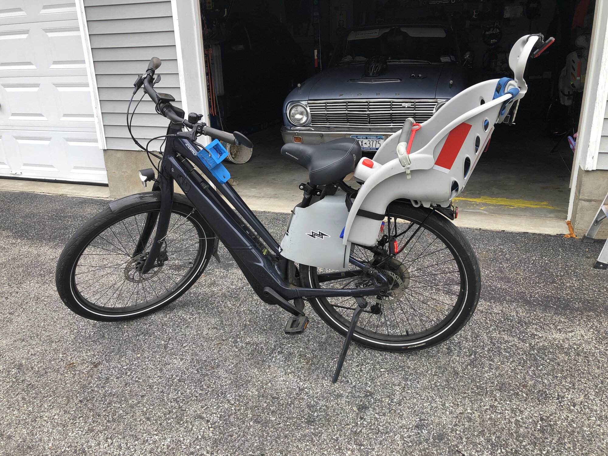

Como 2.0 @ 6K miles:
OK obviously you're supposed to keep hands on bars even on well paved roads I ride on :
.. but now if raise hands off bars at all, scary shimmy starts, goes into destructive oscillation unless bars grabbed quickly ! .
Until very recent development could cruise without hands on bars effortlessly never a shimmy ! - ?.
Wheel/tire spin as true as I can see by eye, headset is tight, - what may contributes to problem ?.
thanks

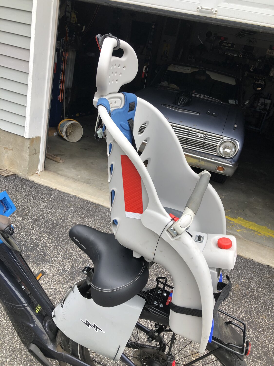

last comment mentioned REAR tire load, and I did just mount a child carrier on it recently. Child carrier matched same mount as our other matching COMO which has had the carrier and kids for @ 3 years with no shimmy . ( Haven't noticed shimmy with kid on it but probly kept hands on bars. Carrier is only a few pounds, easily carries 30 lb kid ) . Carrier is easily removed leaving the small light rack , I will try removing carrier and ride ...
identical but no shimmy one of our two Como's with kid carrier.
thanks for responses .
THANK YOU -
Nvreloader​
removed the child carrier from the carriers' rack receiver and does not shimmy !. - 'my' Como of our identical pair, the child carrier identically setup, appears to produce an uncontrollable shimmy of front wheel/bars if hands are not kept tight to bars.
seems hard to believe, carrier weighs @ 5 pounds (US) ! - going to mount carrier back to rack and test ride to confirm this odd assumption/finding ...

TOTALLY UNEXPECTED - our Como that has had same carrier ,'the other one', DOES develop a shimmy with rear child carrier, just takes longer to start...
Harmonic Resonance? - CG offset?, hard to believe such little weight difference can cause / effect ...
is front fork rake a factor?, seems very light.
the child carrier is well engineered for 'universal use' and offers considerable protection for kid
