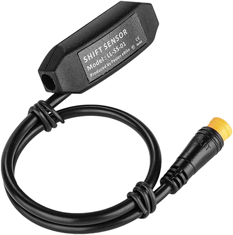

hi. Living in the northern California hills riding my very new Prodigy (magnificent beast!) -- I've discovered that the motor temporarily CUTS OUT when I try to shift down under duress, such as a hill. This is my fourth ebike in as many years that I've been riding in the hills, but THIS one cuts out the pedal assist for a few seconds when I downshift on a hill. Hmmmm. This bike is perfection itself except for this one issue. I used to race in my ill-spent youth, so I know about chains breaking under duress. However, you would think Ride1Up would allow me to make up my own mind about negotating a hill.
SO, is there a way to disable this cut-out?

The bike has a gear shift sensor that cuts power when shifting up or down, I am sure that you could disconnect it pretty easy. It is located nest to the derailer.
