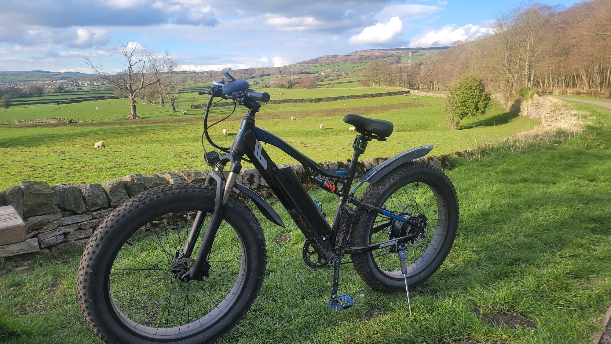

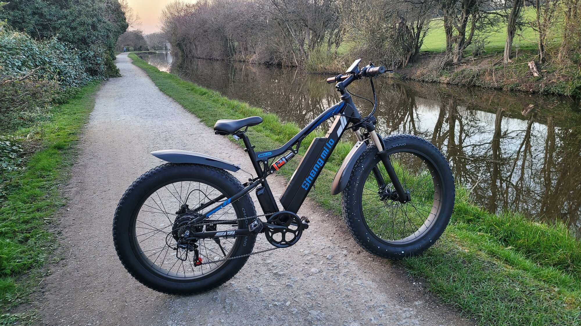

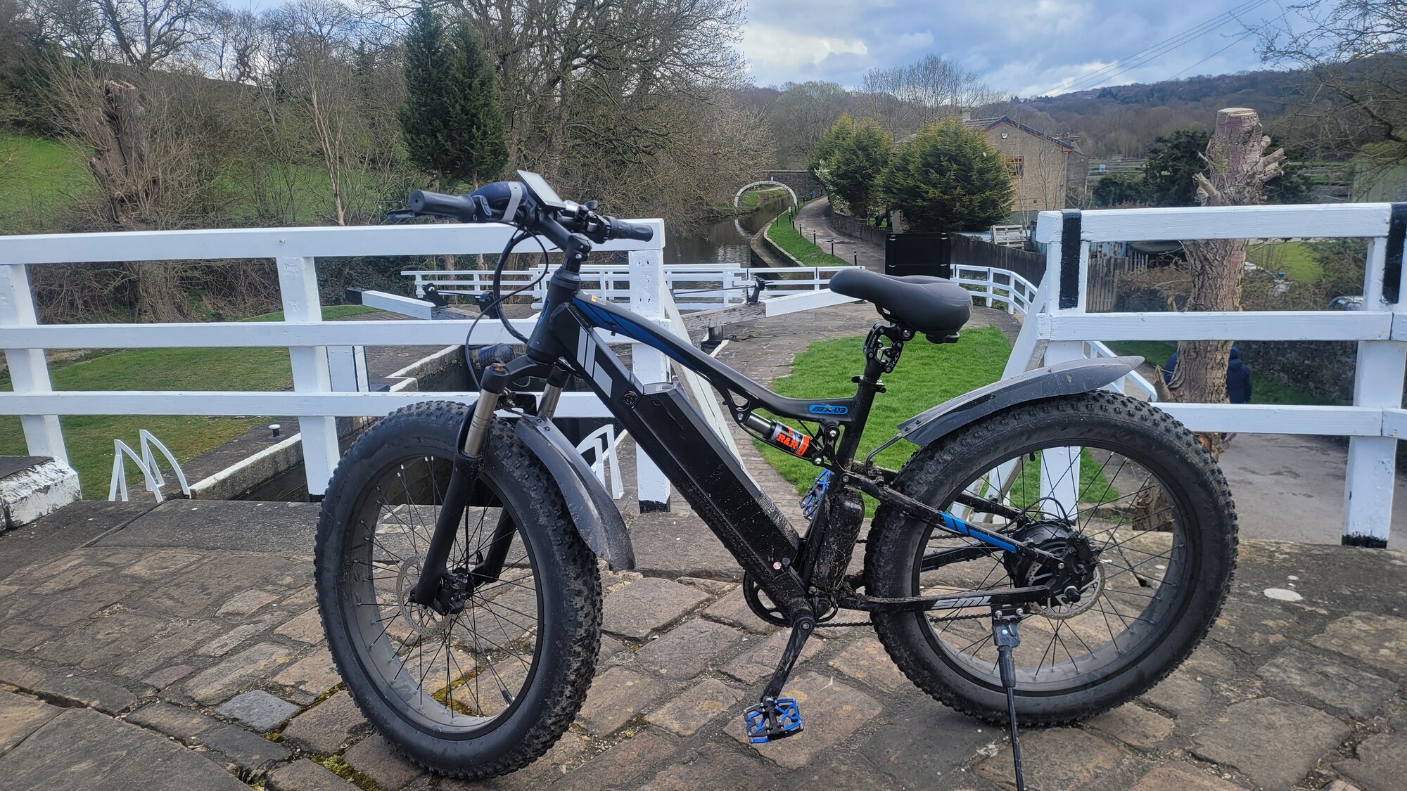

I can't see a review discussion post for this bike so thought I'd start one

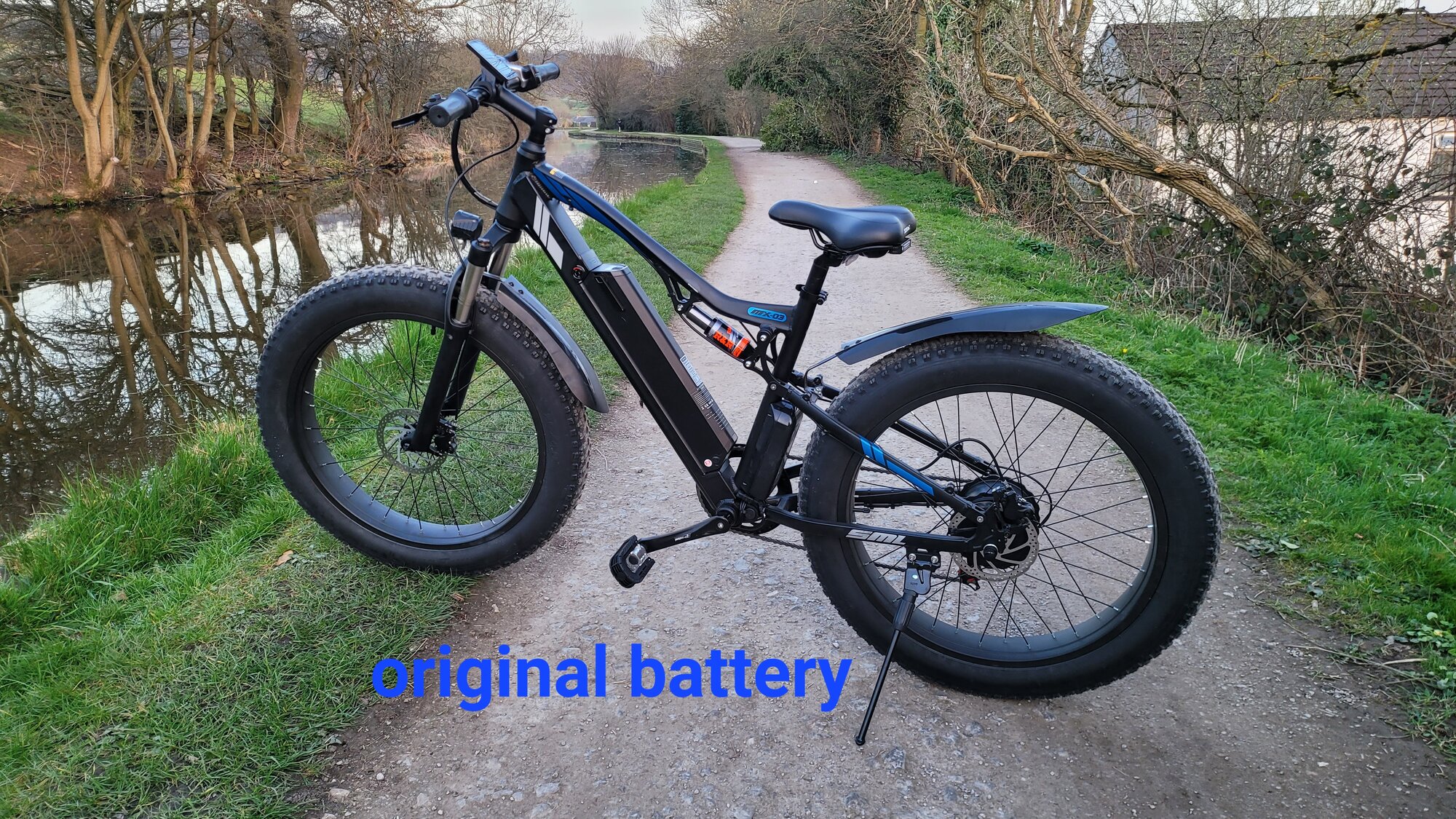

Specs - 48v 17ah (upgradable to 25ah and 1000watt ( don't think it gives the full 1000watt but close )

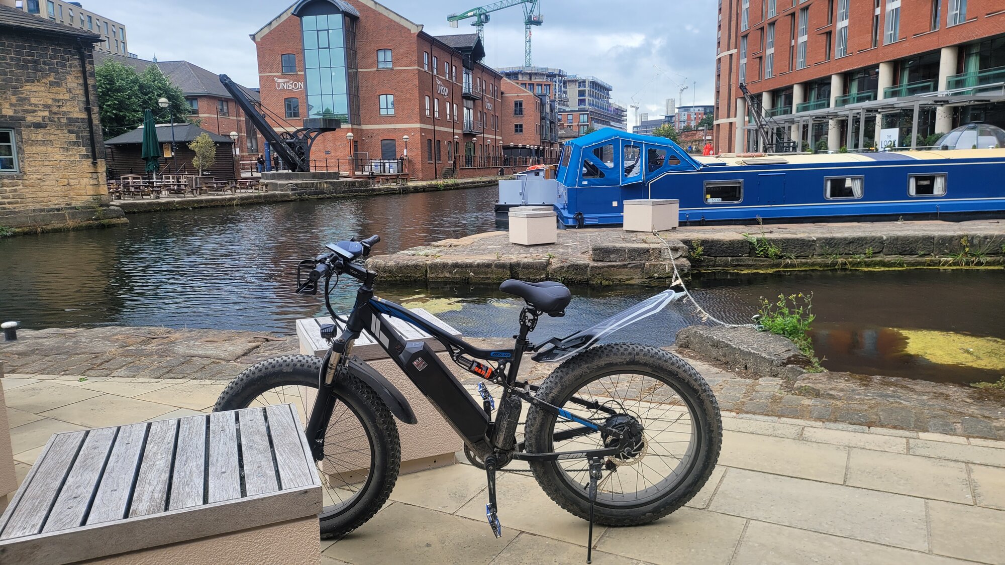

I have the Shengmilo mx03 it's an excellent bike if you know what you want it for, I did 29 miles with more than 60%battery left this was on pas2 mainly flat with some short hills , hills are no problem if you switch to biggest cog and choose the right assist(check the Relive link)
I checked the next day on pas3 same route and had 30% battery left ,
I went out again 2 days after and thought I'd give the motor a test (hills) I got 27 miles until battery depleted but I did go up some rather steep hills and had to work on the steepest climbs but I did stay in the saddle ,
Overall I'm happy with the bike for getting out and about if you want to climb mountains get a mid drive motor ,I pedal in manual mode meaning I use half energy and it assists when needed and if I go over 16mph in pas2 the current fluctuates from 2-1 on the display to conserve battery( I usually ride in 2/3 pas but found 2 is the best otherwise I'll miss the scenery,
Also @Jenny Mao can also provide the new 48v 25ah battery which fits which I might purchase later on I think it uses Samsung 5000 cells so should see good range and power
Any questions or mods anyone has done good or bad is welcome

It's only 18amp controller so possibly only giving 864watts but that's good enough tbh it pulls plenty good I could always change controller but why mess with it if its OK or I shunt it but risk damage it so I'll leave a it is.
Still better than 250watt UK standard so I'm happy for £1100 for the bike

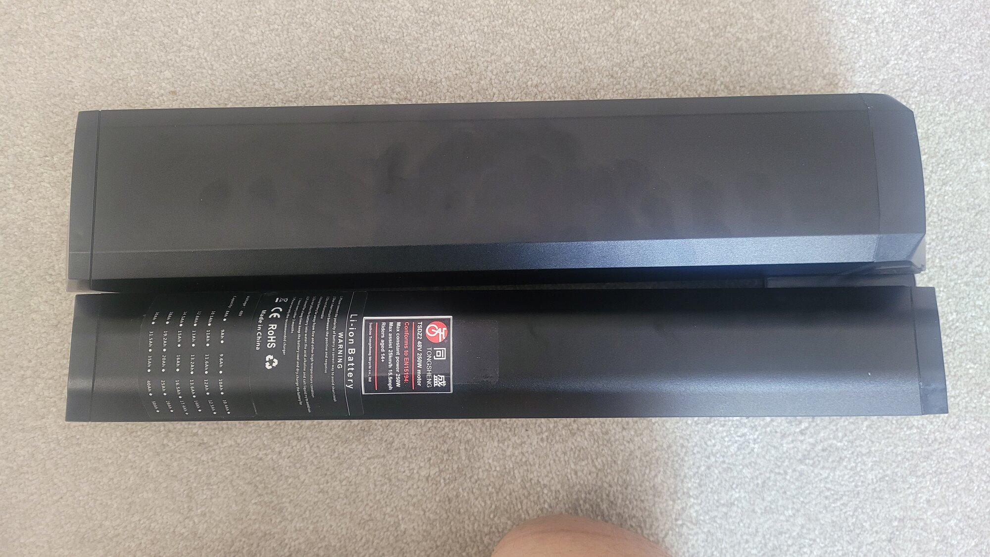

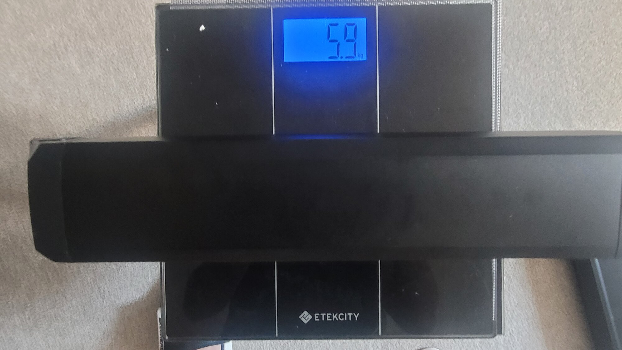

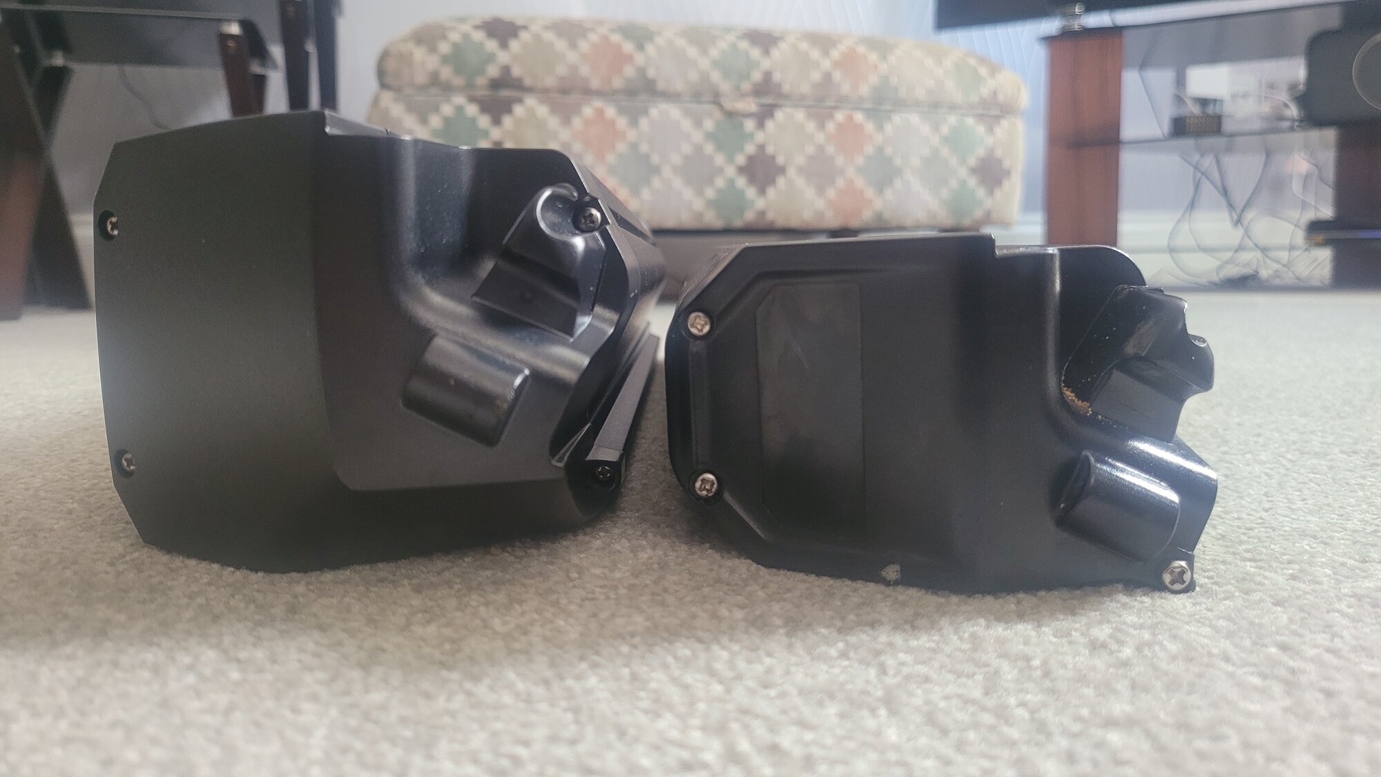

Hi guys received 25ah battery today from @Jenny Mao got to goto work now so I'll update tomorrow, I did put it on the bike and everything fits and turns on , I'll update tomorrow on my day off cheers guys,, I'll show you what it looks like tomorrow on the bike ,,here's the weight difference

Had a quick ride out today mostly steep hills, covered 21 miles and voltage went from 54v to 51.5 using power assist 2-5 (hills was steep) , battery still showing full, the power delivery is smooth with no battery sag at all , I was smiling away going up the hills using the right gears as appropriate and using good maintained speed up the steep hills I'll finish the battery tomorrow it will be mainly flat riding, I want to see if there's much battery sag near the end of battery and then give it a good charge , the battery is a little bit bulkier than original but not too much(see pics first 2 are 25ah battery)
So far I'm happy with the performance but much more testing needed.
The battery fits well and plenty of clearance if any shengmilo mx03 owners wondered, any questions or requests welcome ,
One thing I noticed when riding up steep hills before I got this battery was it could do with a little bit more torque but with this battery there's no voltage drop/sag and handle them well obviously with a bit of effort that's how I like to use my gears, I'll keep this thread updated

The 25Ah looks perfectly fit on the shengmilo mx03. Thanks for sharing us so many pics and the real testing experience.

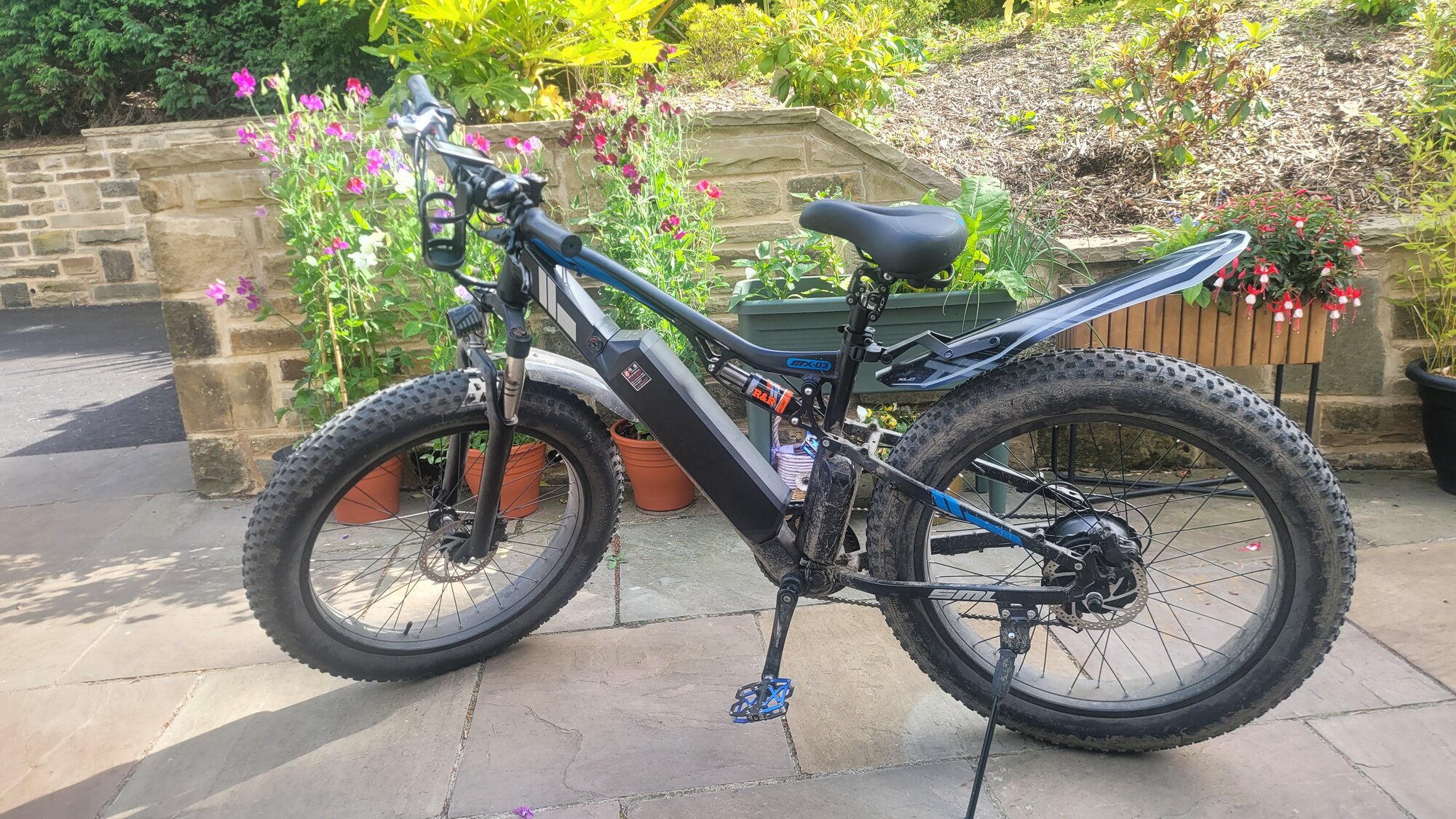

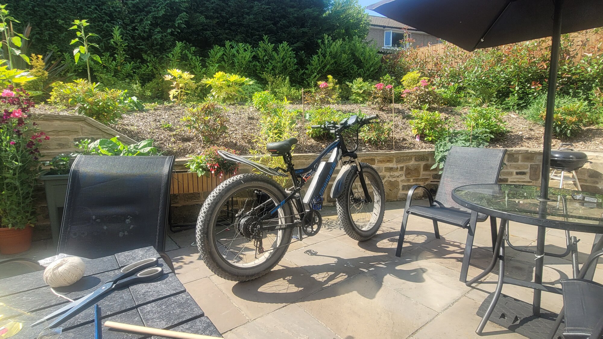

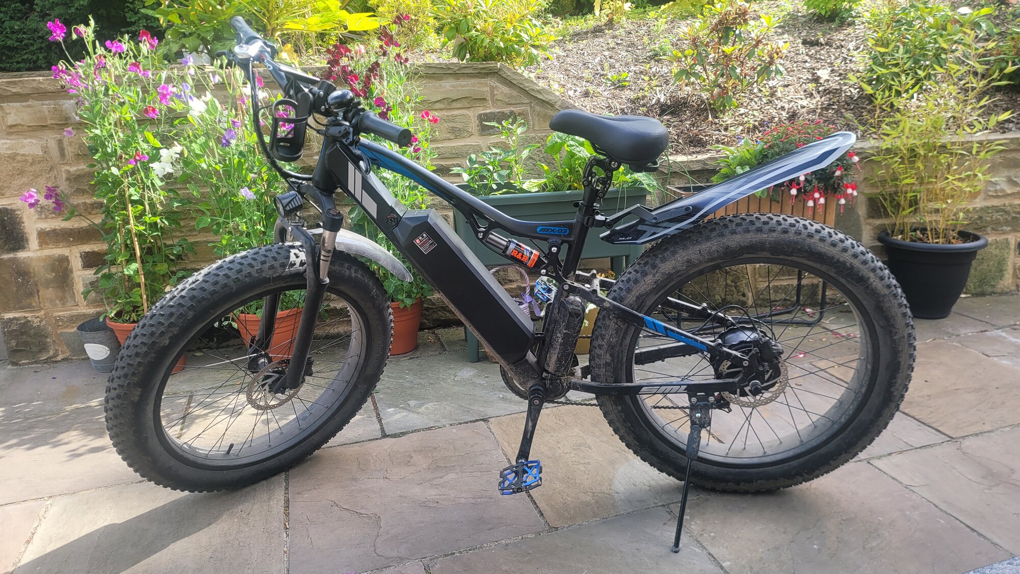

Seatpost is 30.4 , I haven't bought a rear shock as yet but it's recommended for a 190mm it fits best and raises the pedals a bit more from the ground(that's what I will be buying)
The 25ah battery is faultless from @Jenny Mao and fits great with plenty of milage,
Upgrades I've made is wider bars with a raise and a redshift suspension handlebar stem and a suntour suspension seatpost I had to buy a 30.4-27.2 shim so it would fit and more grippy pedals, thanks it's a great bike
Update on range on the first charge of the battery is 79 miles and 42.3v remaining could probably push another 5-10 miles or more if I wanted to take it to 40v but I'll leave it at a safe LVC, I've cycled in normal conditions using power assist 2-5 where needed and also give it a few blasts at high speed (28mph)
Cycling conditions was very steep hills and moderate hills and plenty of off road terrain flat trails , the battery sag is hardly noticeable all the way down to 42v ,very smooth performance overall (my range anxiety has now gone)
Another thing to note is the new 25ah has updated connections and can now mange 4 amps for charging (talk to @Jenny Mao if yours is compatible) new ones should be fine
So I'm now charging at 4 amps from 42v I'll update later how long it takes
This battery is a beast and performance is excellent, any questions please ask

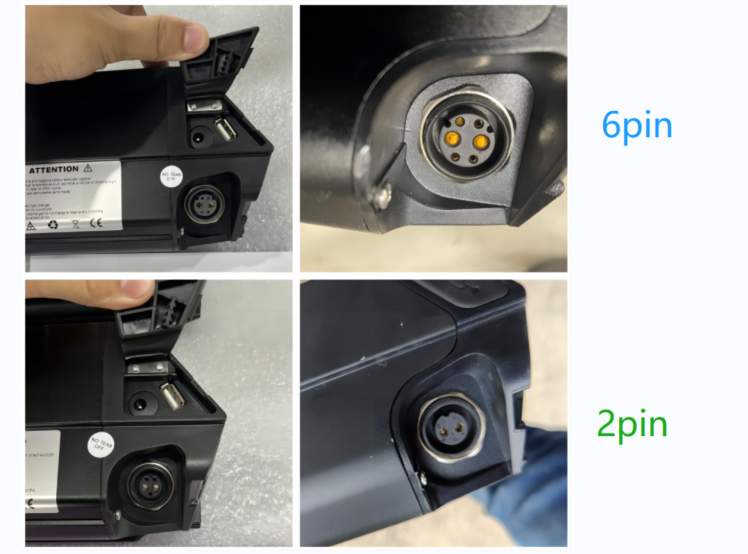

Recently we received a lot inquiries about the replacement battery for Shengmilo MX03. Thank you for all your kind support!
Some come with 2pin discharging port, and some with 6pin discharging port, both are available.
The price for 25Ah is best ever due to the sufficient Samsung cells supply on market, about DDP USD550-USD600 for the Dorado 48V 25Ah battery with a 4amp charger, with shipping cost and custom tax included. The shipping service is available to most mainland address in Europe, UK, (Swiss and Norway only have DAP serive, shipping cost a bit higher).
