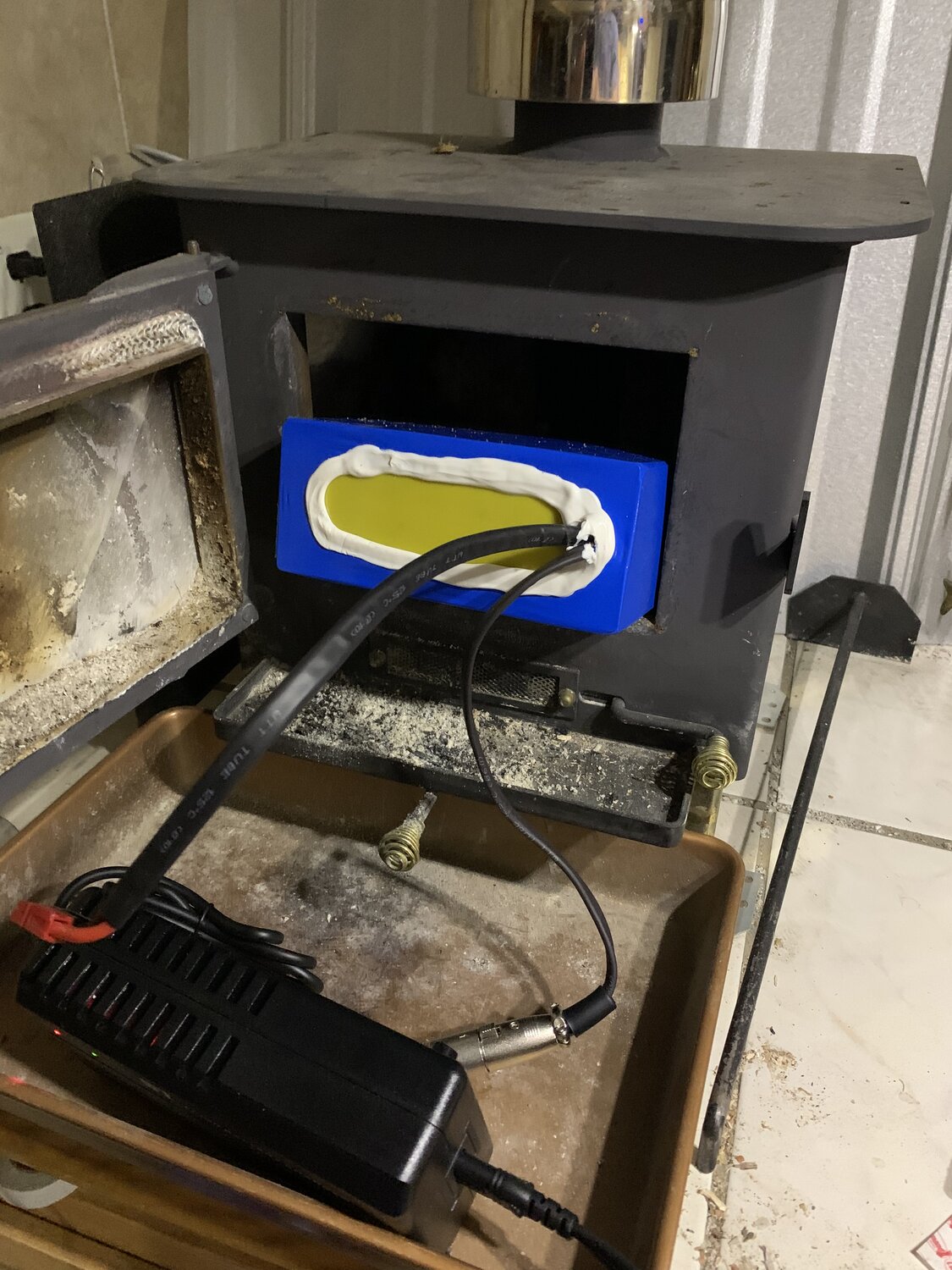

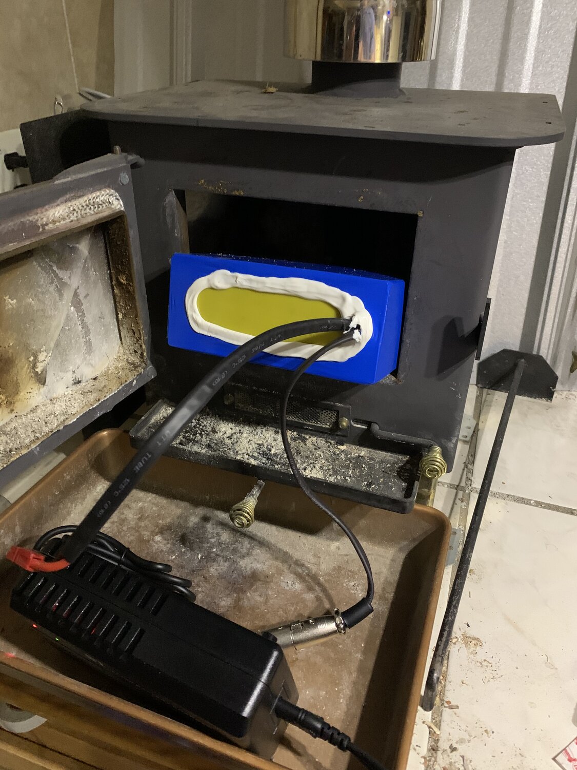

Good advice, thanks. I do have a miniature wood stove (about 12”x12”x12”) and out of an abundance of caution I throw it in there while I’m charging it and place the charger in a metal pan on the fireproof hearth pad under the stove. Probably overkill but I live in a trailer so it’s hard to be “too safe.”
Good advice, thanks. I do have a miniature wood stove (about 12”x12”x12”) and out of an abundance of caution I throw it in there while I’m charging it and place the charger in a metal pan on the fireproof hearth pad under the stove. Probably overkill but I live in a trailer so it’s hard to be “too safe.”View attachment 96586
Better to be safe than sorry!👍

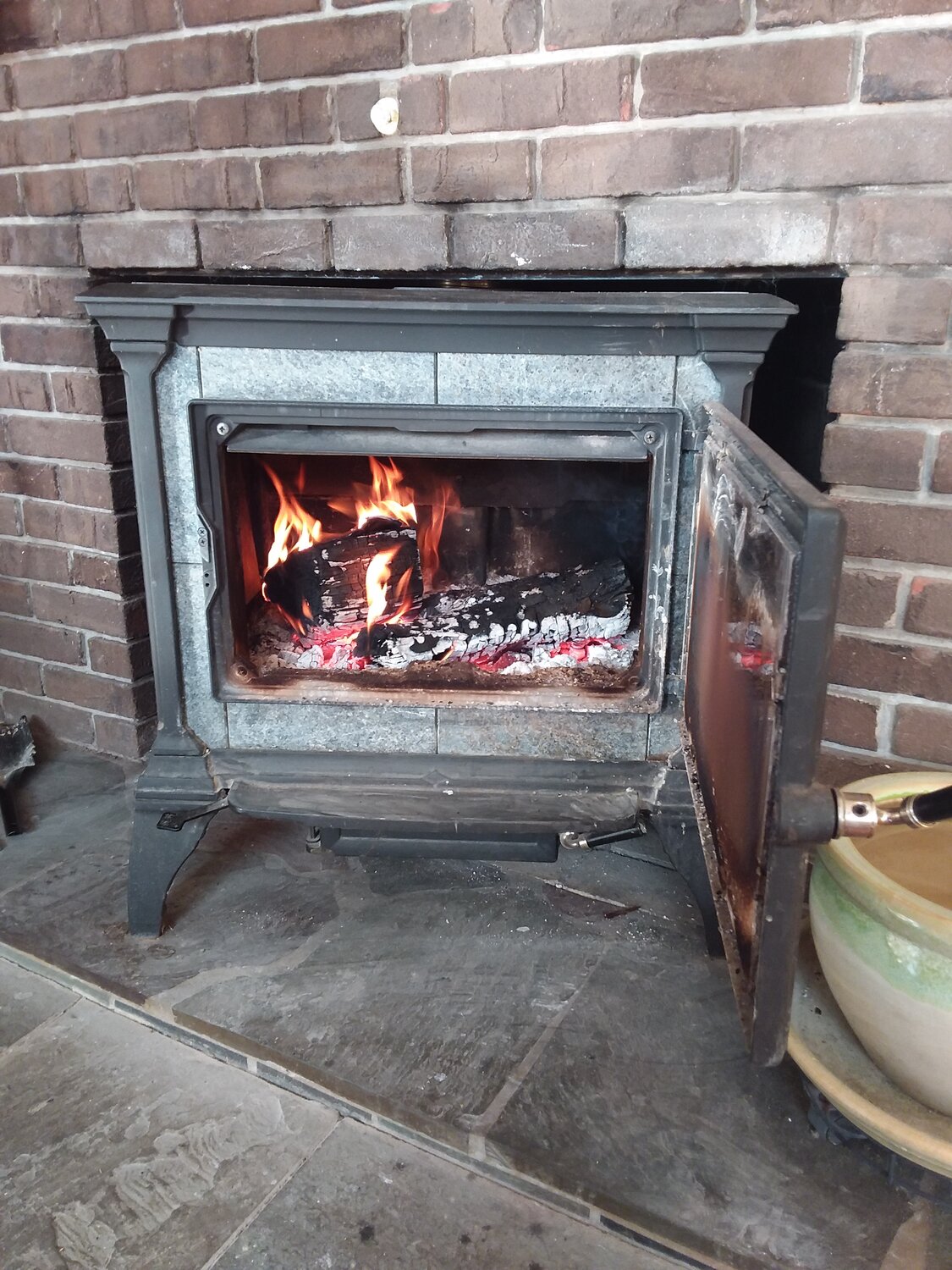

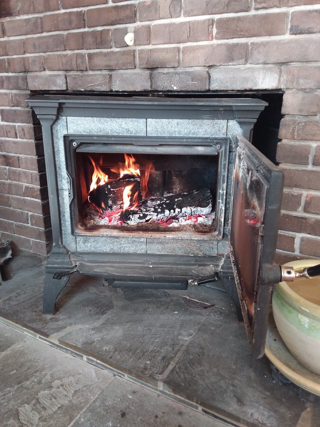

I am also a soap stone stove fan. Mine runs 24/7 for four or five months annually. View attachment 96747
That looks like a HearthStone?
I had three different Woodstock Soapstone stoves, including a beta version of one model before it went into production. A close friend had a huge Hearthstone from the 80s that he heated with 24/7 six months a year for 35 years in upstate New York, till it was so warped and burnt out internally that he finally replaced it with the Woodstock model I had beta tested, their “Ideal Steel.”
