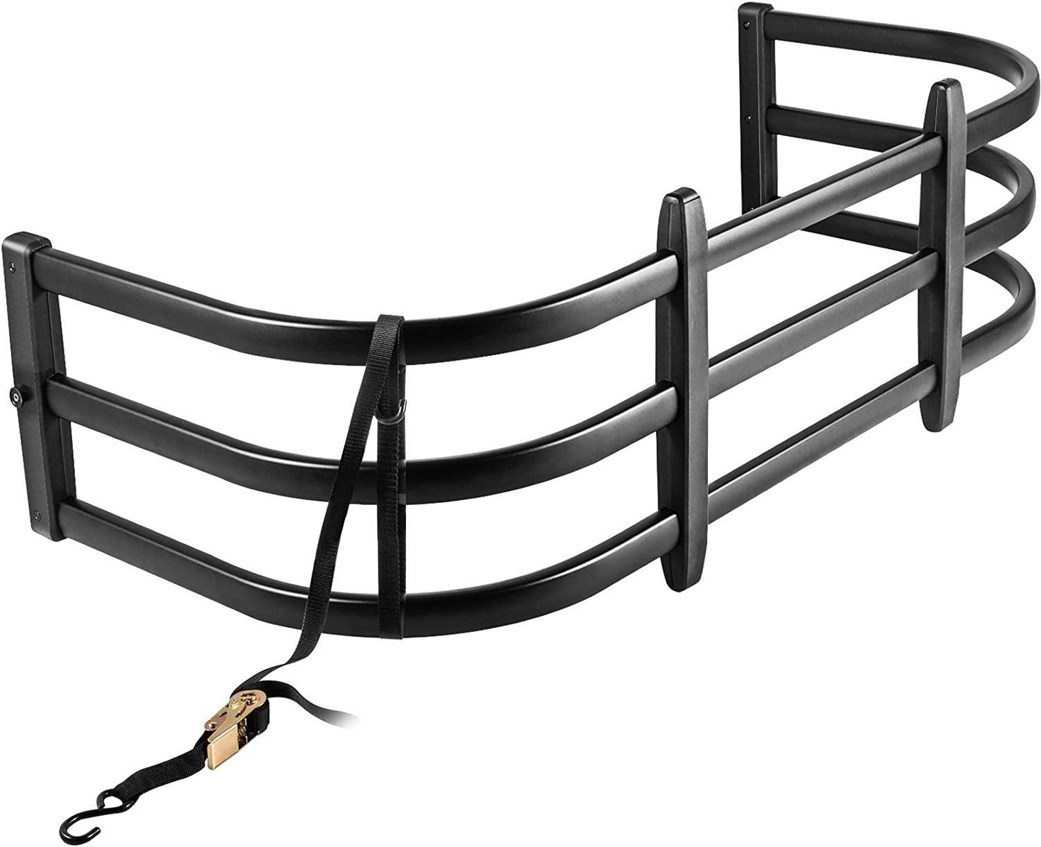

In my travels, I've seen a few folks carrying their bikes in short bed pickups with caps. They leave the wheels on and use a bed extender like this one:
Most of the rigs I've seen have tall bed caps to allow the bike to stand vertically.

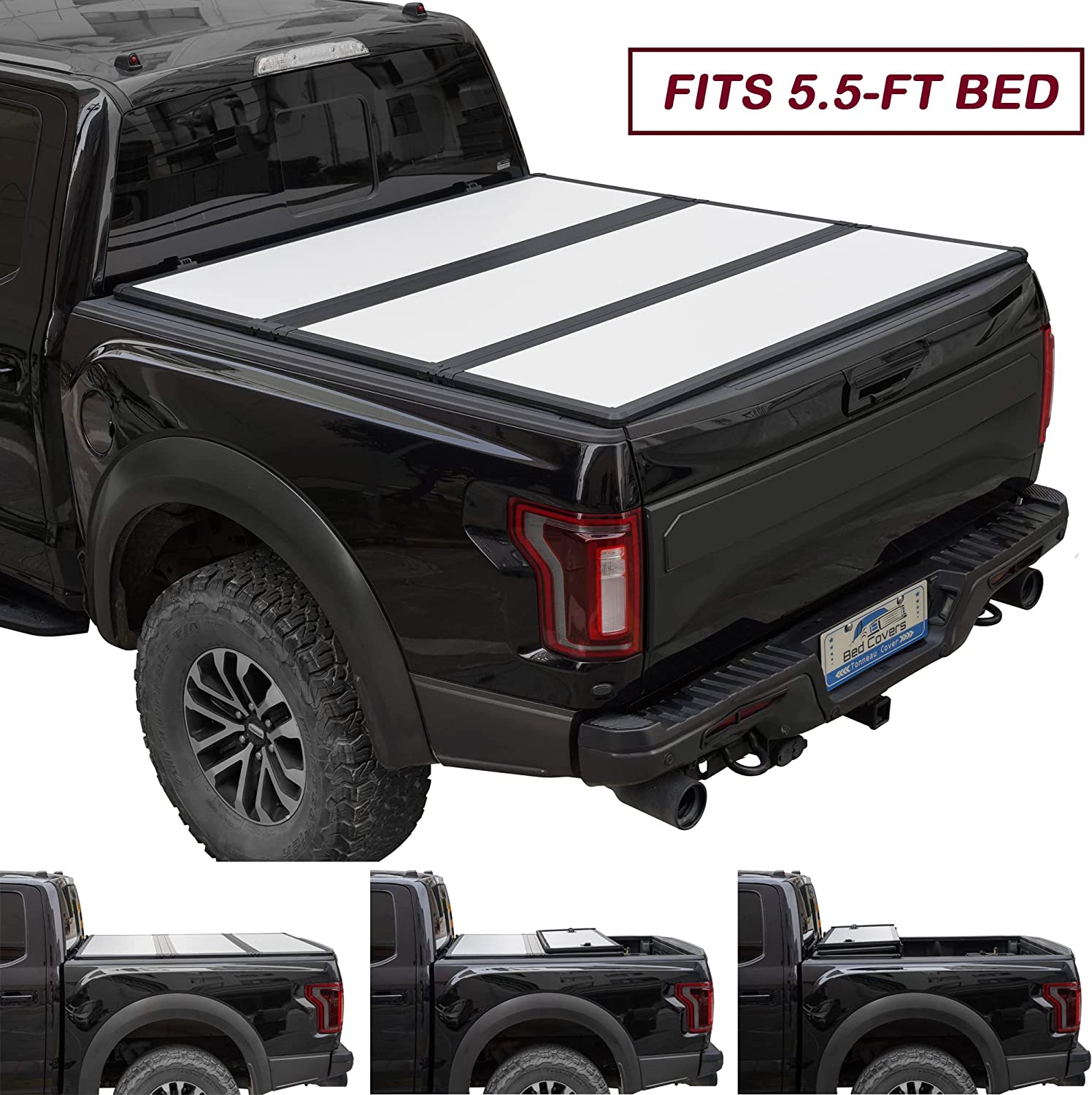

One clever lad I ran into carried his bike in a short bed with a hard tonneau cover like this one:
He laid the bike horizontally on a sheet of plywood with the wheels on. The plywood was cut to fit the bed and bed extender so it wouldn't slide around. He made a cradle with padded blocks of wood and screwed them to the plywood to support the bike. He just slid the plywood & bike out of the bed far enough to be able to lift it off. No tie downs were used at all. Pretty clever!
The only down side was the rear wheel of the bike extended out onto the tailgate and wasn't protected by the tonneau cover. I can see this idea would be nearly perfect for a long bed truck though.

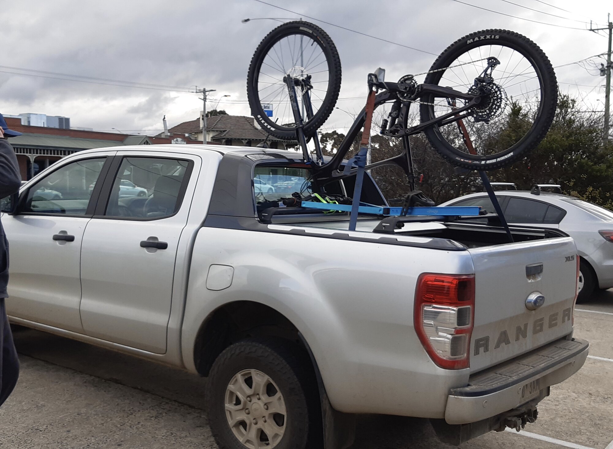

Do you know what the bike weighs without wheels? I've used an upside rack occasionally https://www.upsideracks.com/ I think it's rated around 18 kg which is JUST ok for my levo sl , but most full power bikes would be above that. The image below is my sons giant reign (xl size) , attached to the racks mounted above by rangers PITA rolling tub cover. I assume you could do something similar with the rails being on the bed?
Other things I've tried include:
2 roof rail type bike racks on those tub rails - rear wheel left on but forks mounted to a front axle clamp - this isthe most secure option but I hate having to remove the front wheel.
I occasionally fit my size m giant full e pro upright - diagonally across the tub, tie down straps just like I would witha motorbike, backed in and with forks turned she JUST fits in

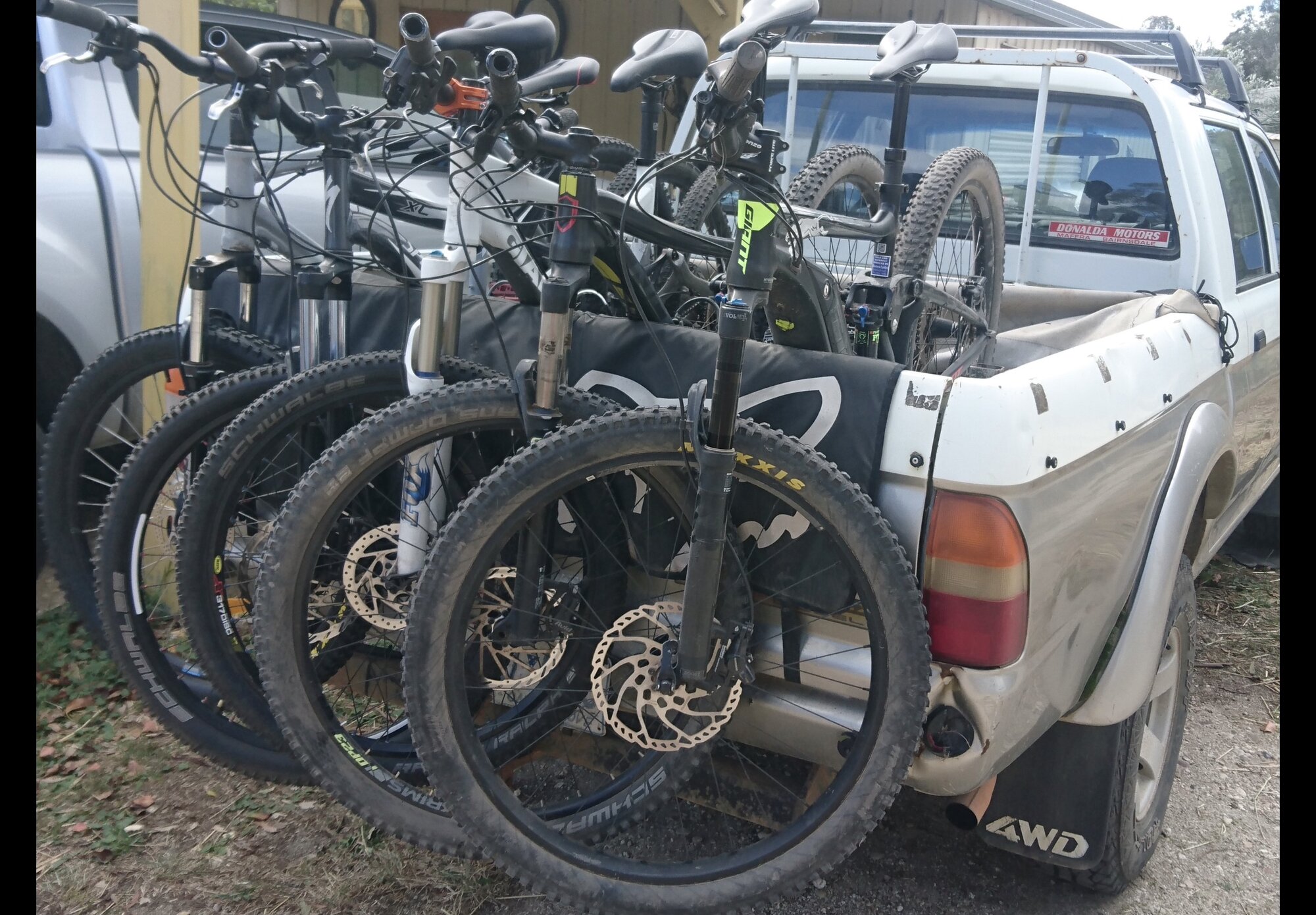

Why not go the tailgate pad route and forego having to remove both tires at all? Might need 2 people for that though.
Would the bike really not fit with just the front wheel removed and on a mounted skewer? A bed extender like the one above, plus a skewer fork mount could be the best compromise solution if the height/clearance works (will depend on your bed depth and overall height with the soft topper).

I think it'd be hard going tailgate mounted if the ute had a canopy - lifting a full weight e bike over the tailgate is about the limit my strength / dexterity - in particular getting the motor over the lip when REMOVING the bike. Most of the time I end up with a contorted circus act and the rear wheel in the air looking like the trapeze artist forget to join the act. I miss my ancient mitsubishi triton with it's lower tailgate / longer tub!
