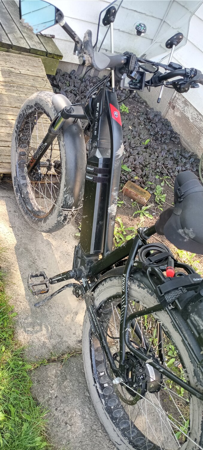

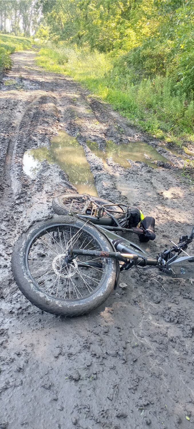

I've got over 3600 km on my e-bike now and I've never cleaned my rotors.
Come to think of it, I've only cleaned my bike once, but only because I kinda had to. 😂

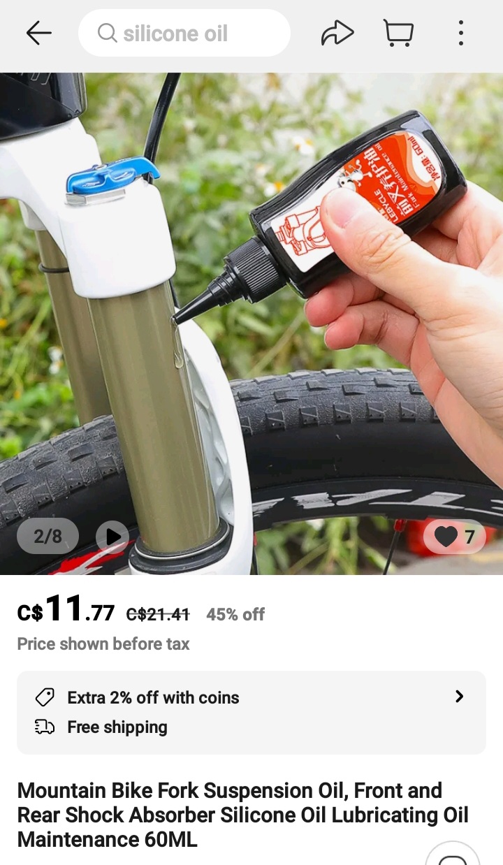

I clean and lubricate my fork stanchions regularly though.
I bought this stuff for the job,..
