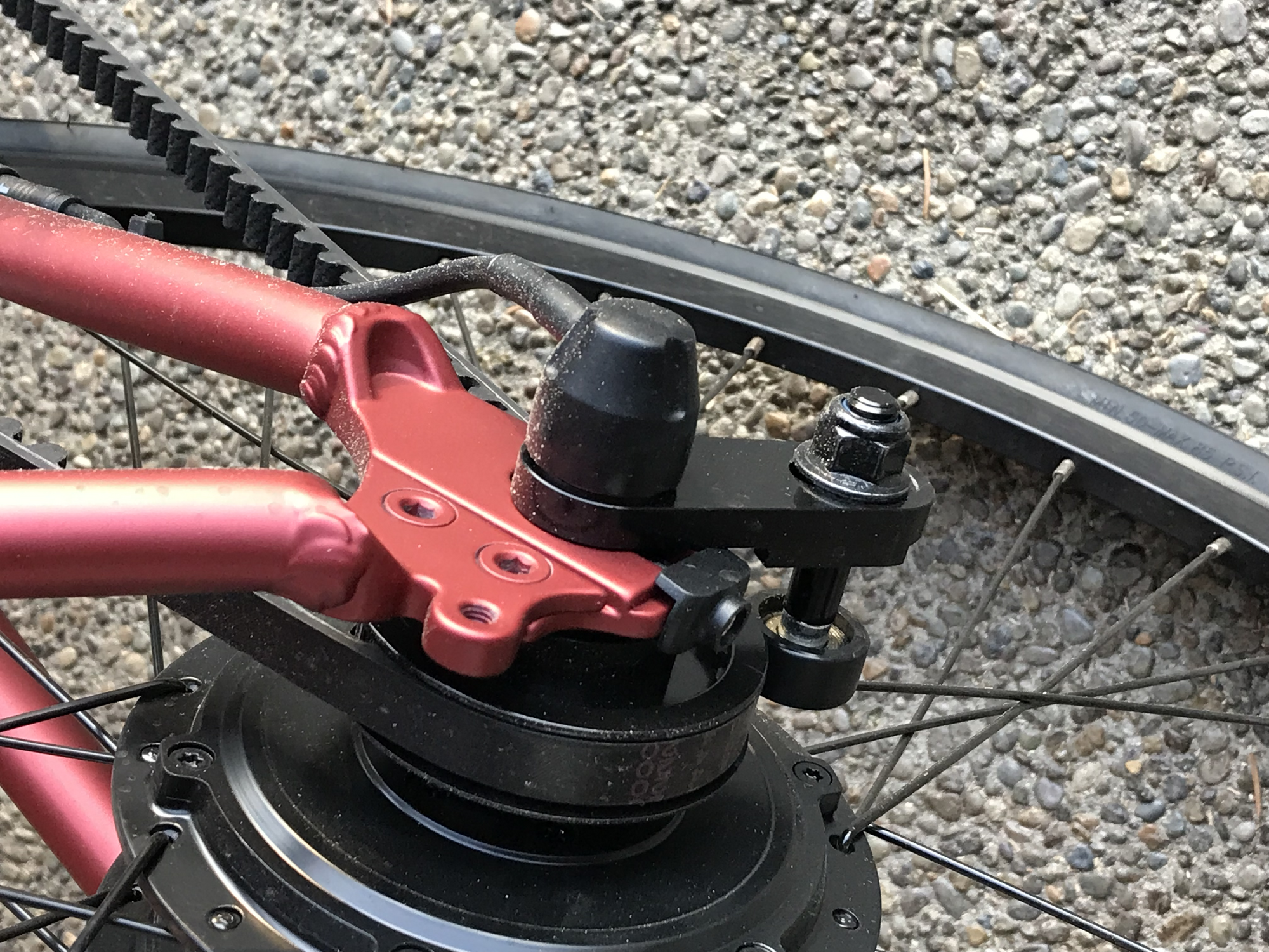

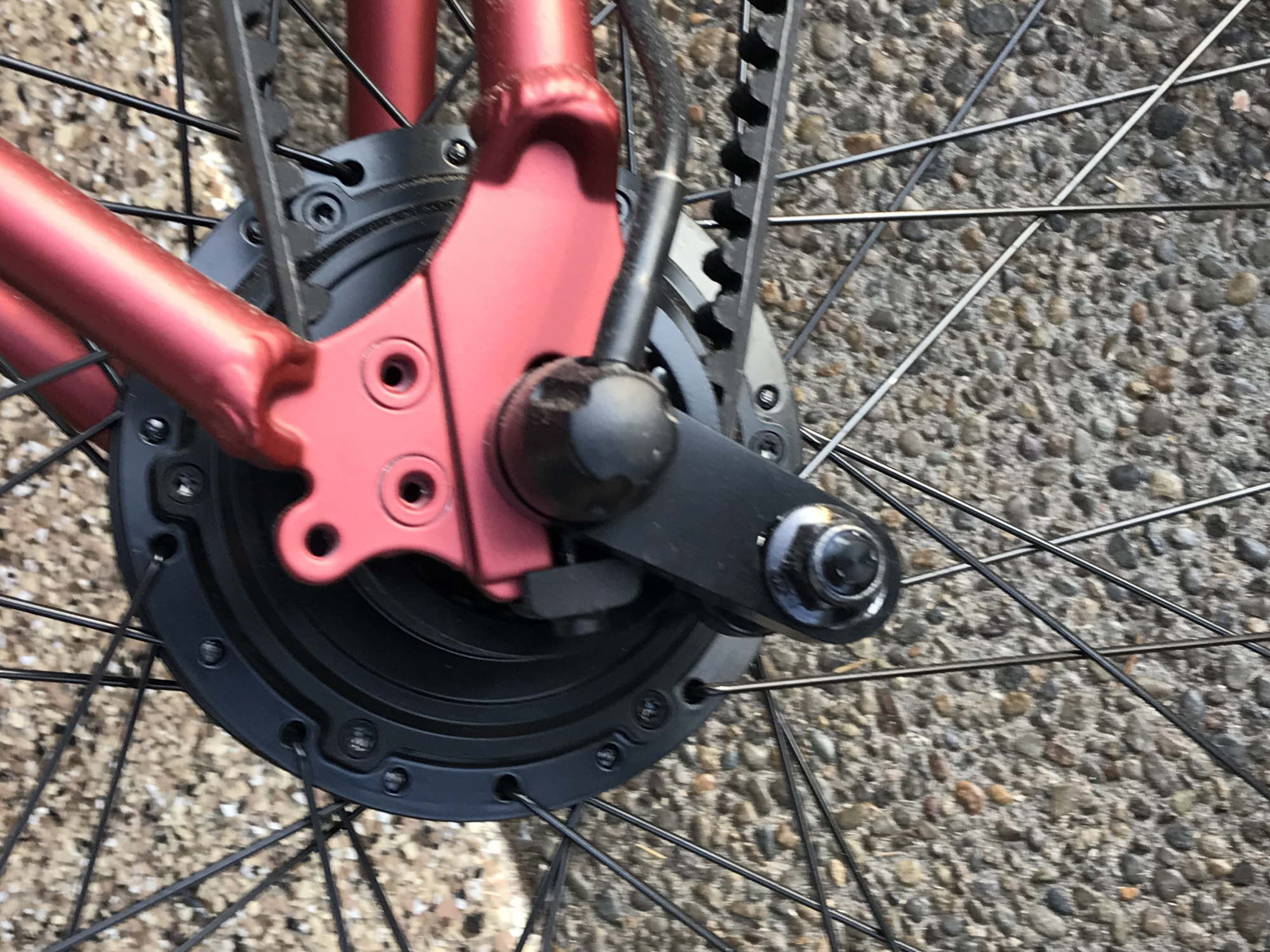

Is your belt still skipping Ute4492? Did it come with a snubber? Many early ones did not come with it. You can get one from Ride1Up if it is still skipping

My neighbor very recently got a new regular Roadster (his 1st one was stolen) and the new one has the snubber on it.

Here you go - don't know why they're loading this way, but you get the idea. My neighbor did have skipping on his original Roadster. So far not on this one. I have not had that issue on either the regular Roadster or the gravel and I ride some pretty good grades (though not to PSm's standard). But I weight 150#'s where my neighbor is over 200.
Thanks for posting the pictures. Seems like it would be a simple install.
I have an inquiry with Ride1up about availability.
