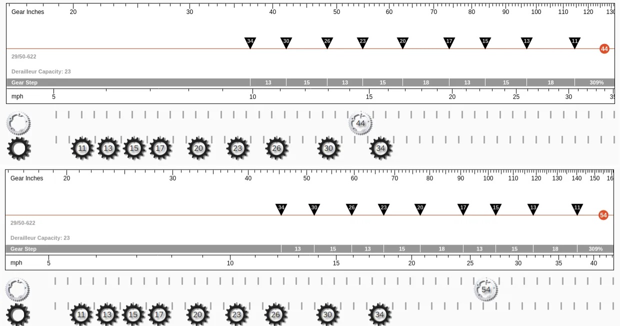

I'm 500 miles in and have already replaced my cassette. I think I solved the issue though. This bike has a 44T front and 9/11-32 rear. The Juiced bikes, and I suspect other ebikes, have a 54T front. This anemic front sprocket means only the 9th gear, and it's like 5 teeth, take all the power if you want to go 28mph. Only going ham with the cadence, or 9th gear, can get you to 28mph. I just bought a new front sprocket that will arrive soon to expand that top end. I'll report back once installed. You can see in this top graph, at 90rpm and 8th gear with a 44T, the max speed is 26. A 54T greatly increases which rear gears give you that range. (Bottom graph)
I know for a fact I shredded the rear gears. I was doing fine after the cassette replacement for miles 200-450. At around 450, in 9th gear I decided to get out of the saddle for a hill climb instead of downshifting. It was my mistake, I was putting like 2000 watts (I know my sprints are 1000 watts because of Zwifting with power meter pedals) into those few teeth, it skipped hard and I've been skipping on 9th since.
Edit: 58T was juuuust too large to fit. Trying again with a 54T.
