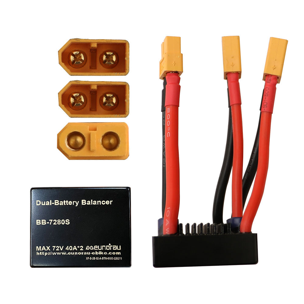

In addition, if your RadMission is still under warranty, I would hold off since anything aftermarket will void warranty.
Also, if you were to connect two battery packs, make sure to use dual battery converter.
Eunorau Dual Battery Conveter
WattWagons Dual Battery Conveter
Bolton Dual Battery Parallel Connector
