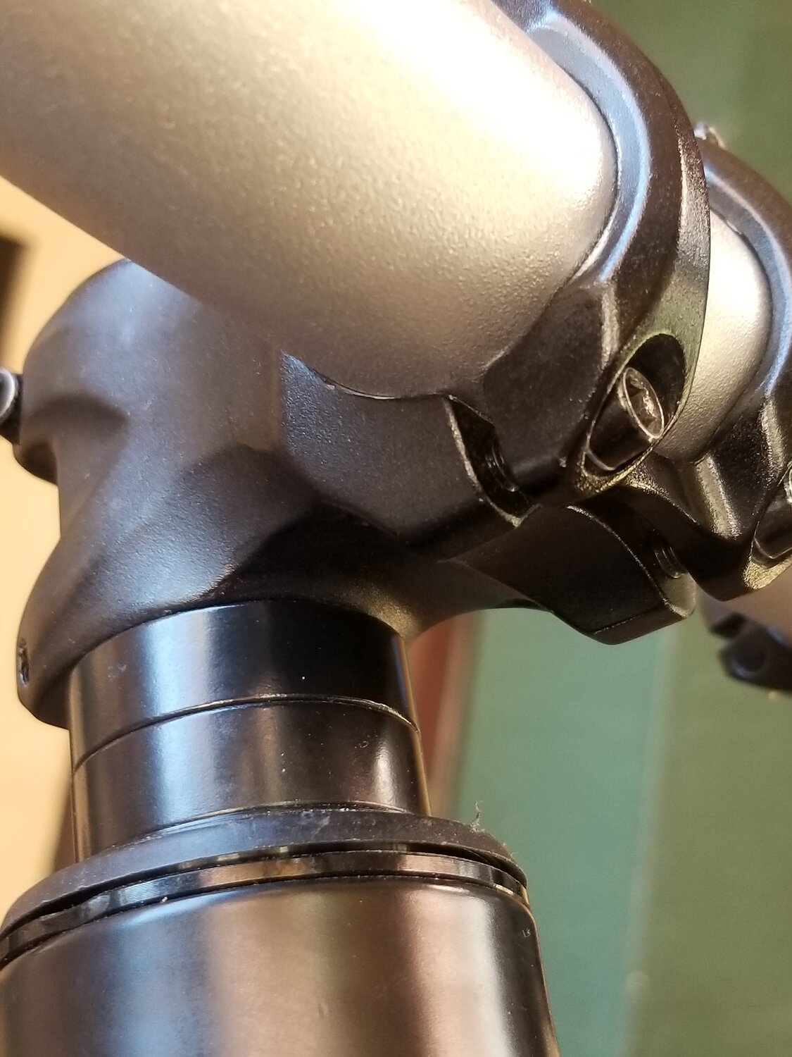

Any Fox fork will be a huge upgrade, however, you'll probably end up having to replace your front wheel as well, the LMTD comes with old skool 9mm QR if I'm not mistaken, most forks from the last 5 years are through axle type (like what is on the Prodigy)
I so agree It would be, but wasn't thinking right.
I vaguely remembered from assembly, checked the assembly vid and sure enough. Ltd has a straight steering tube.
All the higher end forks are tapered.
It's come down to RockShox Judy Gold (150 grams heavier), or if I can find one, the Recon Gold (but that one's not straight tube which is much rarer). Getting frustrated looking for that Recon, so it's likely the Judy - still a lot less weight than the stock RST and a full feature suite of adjustments.
Axles ... another good reminder. Thank you. MTB axles are all the rage - esp on full suspension bikes.
No I don't want to replace my front hub, etc. Honestly, what was I thinking?

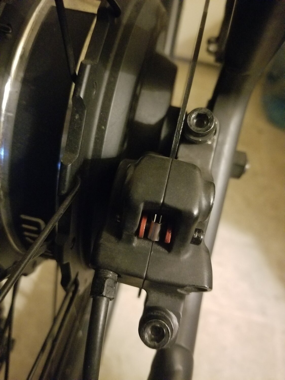

1. Ltd's brake type and model
The Ltd uses Tektro Auriga hydraulics and the model number (HD M290n) can be found on the on the underside of your levers.
View attachment 124669 Tektro rates these brakes in the 'Mountain Bicycle' category and all four Tektro size 22 pad types will fit*.
*Tektro's calipers that fit size 22 pads are - as far as I can tell - identical. The pads installed are the primary limiting factor and thus, upgrading pads, upgrades the brakes to different performance levels.

3. How to choose which pad is best
Typically, it's a trade-off. More metallic brakes have greater stopping power, harder compound pads wear less and can last longer, but the discs will need replacing more often. Such discs are less than $20 from some sources, but there's also labor involved.
Regardless what you like, one thing is undeniable. The Ltd comes stock with E10.11 (Green) pads, the manufacturer says are not for e-bikes.
The A10.11 (Black) pads are the entry level, soft compound pads for e-bikes
4. My experience and conclusions
The green pads for 38lb Mountain bikes.
Absolutely unacceptable.
The Black pads (e-bike entry level), are for 'Tektro brake kits' to convert bicycles and entry level e-bikes.
No matter how you use it, the Ltd is not an 'entry level' - 20mph e-bike or converted bicycle.
We're talkin' a 100nm, 53 - 65 e-bikes that can exceed 30mph.
Absolutely, unacceptable.
My 'medium', leans towards higher performance and safety over less rotor wear.
I've done 3 1/2 f & r pad changes, always true to the stock pads.
After getting to the end of my stash of E10.11's, I thought I'd try the next step up, P20.11 (Red) pads on the rear caliper.
I'm running new (<100mi) set of green E10.11 pads in the front, the comparison difference is remarkable.
Quick break in and immediately the P20.11 (Red) pads are noticeably quieter/ more powerful than the stock E10.11.
Huh? The rear, that was always the weak point is now much the stronger?
Other things like minutely detectable shudders, now so distinctly absent in the rear are apparent in the front.
I've no idea why Tektro advertises the Green pads as "Quiet". The P20.11 Red are significantly quieter.
I prefer a happy medium leaning towards higher performance and safety.
Such lesser performance for less rotor wear isn't worth it to me.
Next I'll install on the front and we'll see.
Hope this helps others.

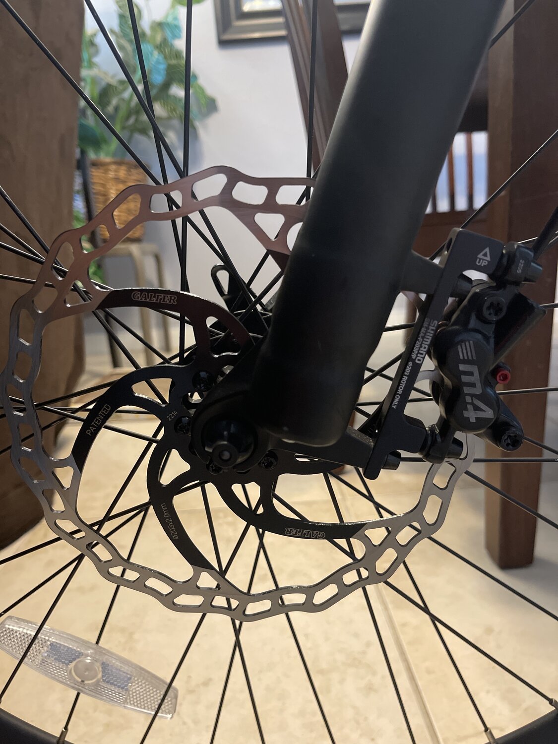

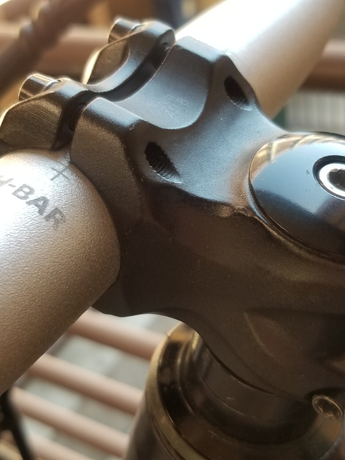

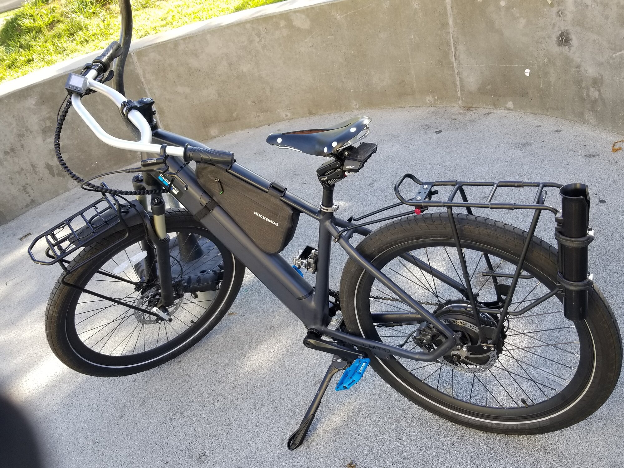

Jones H bars confirmed.

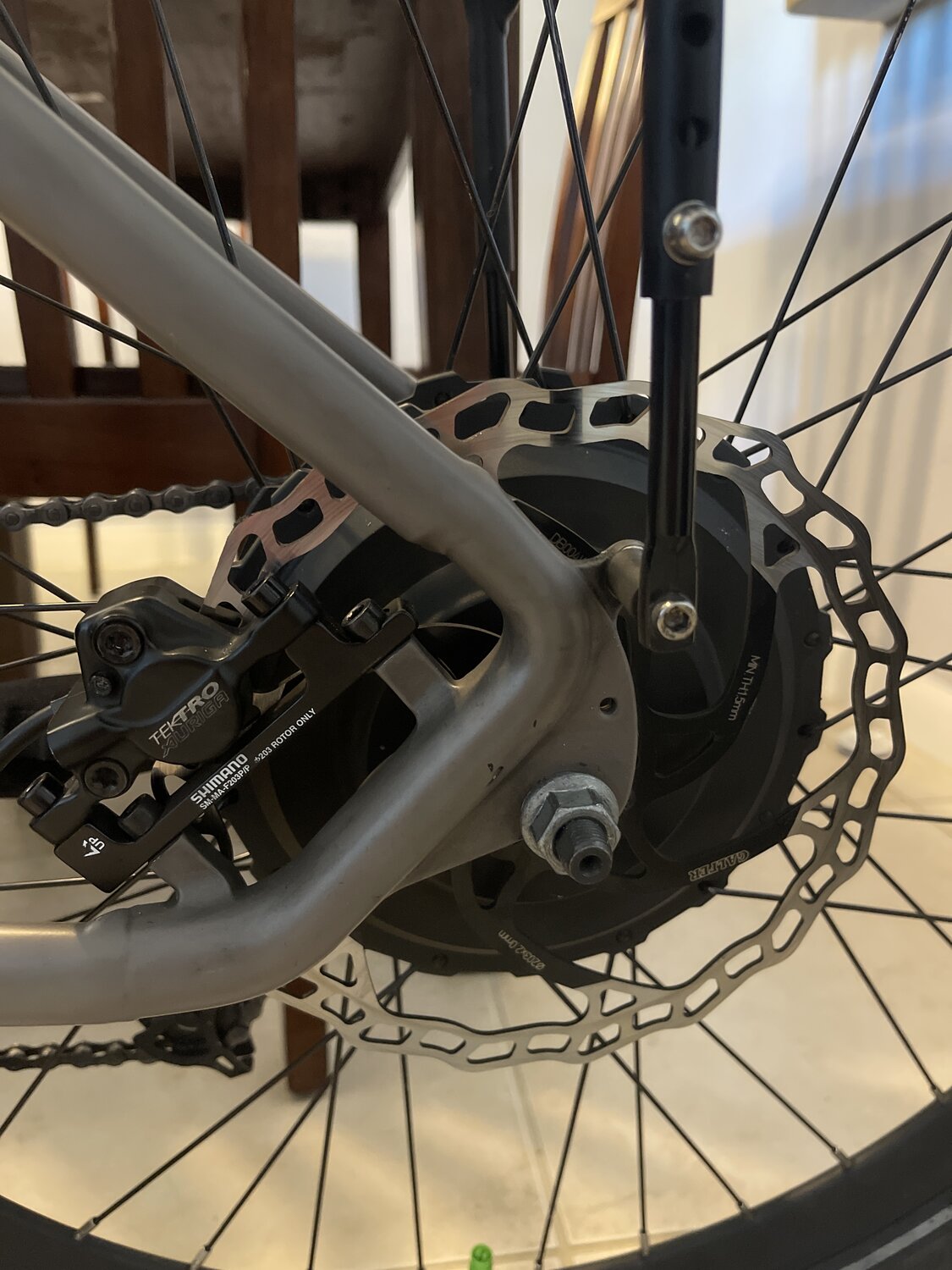

Red pads in the rear ....

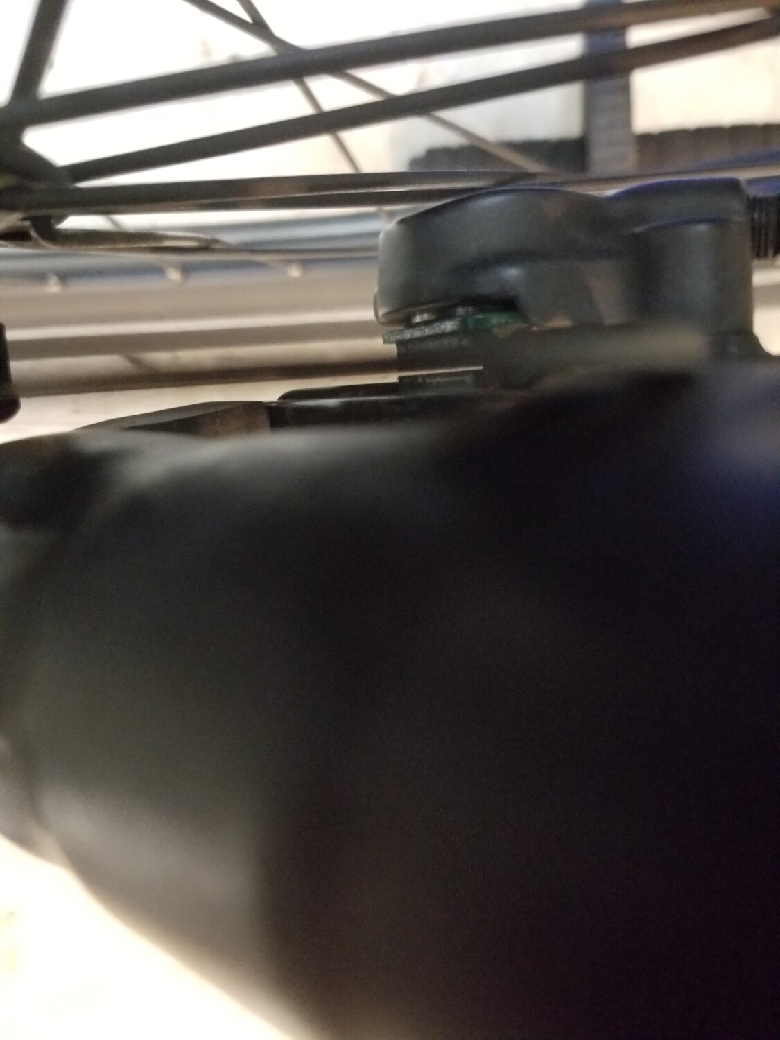

20220601_141145[1].jpg ... and still running Green in front 20220601_141327[1].jpg

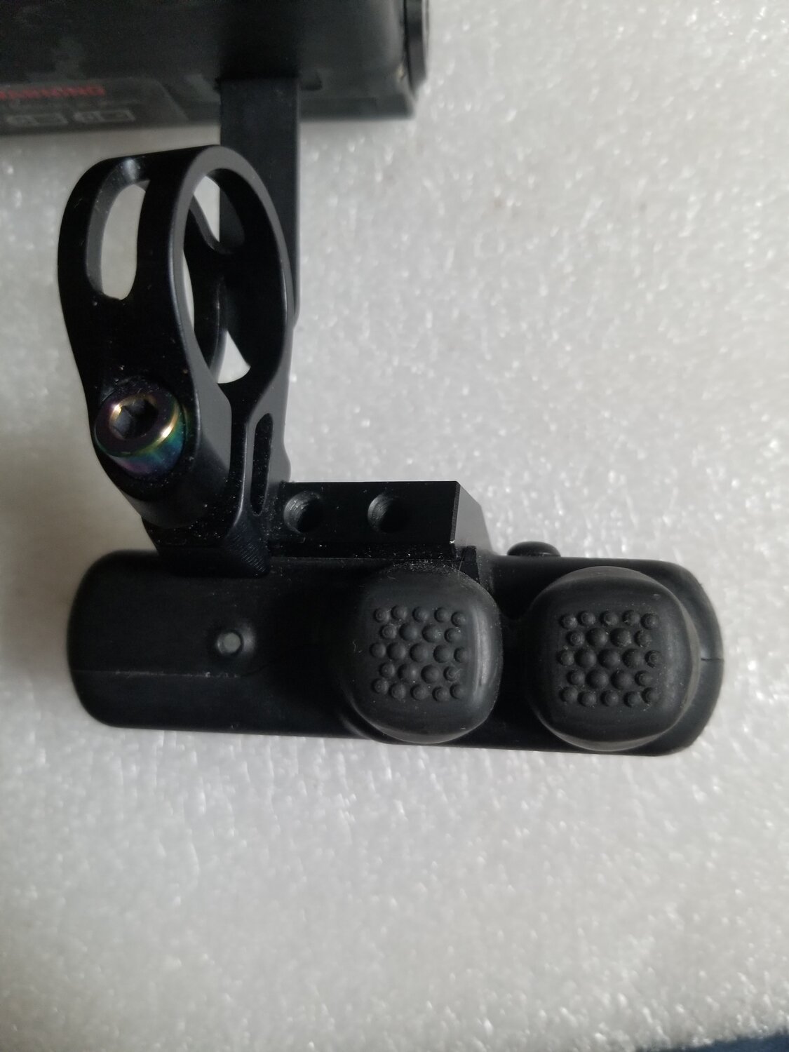

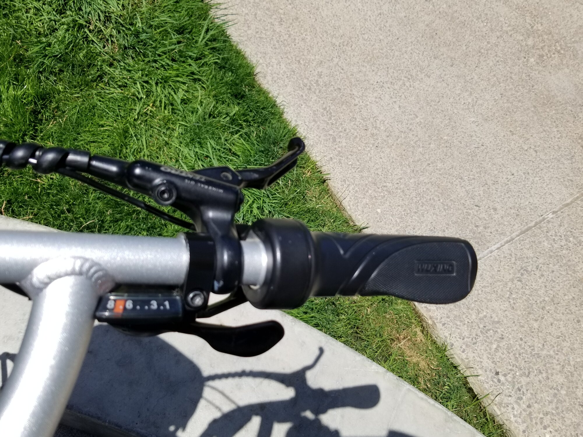

While the cassette and gears seem fine, I still don't like the awkward shifter 20220531_132207.jpg either bashing into my thumb knuckle when I use throttle, or being in a weird position to reach over and up-shift.
It's my fault again. Not meant for throttle use, unlike when rolling your hand, your knuckle says fixed using just your thumb.
What was I thinking?

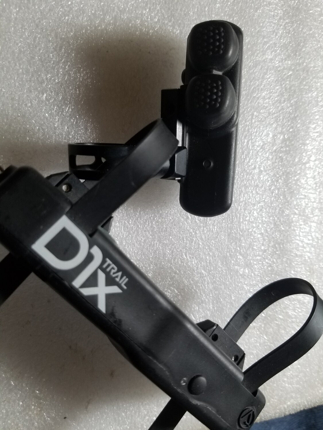

I was thinking about installing this Archer D1x 20220601_144018[1].jpgwireless shifting I picked up on ebay.
The shifter itself is adjustable to 3 positions, over about a 20mm horizontal plane - for 22mm bars. 20220601_144350[1].jpg Awesome!
Since I purchased, the price doubled. I'd saved it for my next mid-drive build, but time's flying and we only live once.
I know if I leave it on when I let this machine go, it won't be be worth any more that the stock set-up. Sigh - a buyer'll, like: 'what about that scratch'; is that modified; I can't tell what gear I'm in with that thing; where's the thumb throttle'?
I guess I can (go against my plan :mad:and add weight🥵 by 🤣leaving the cable in place and just disconnecting, running my D1x to shift gears., but not so much my style. Maybe trap myself like that, then do it right?

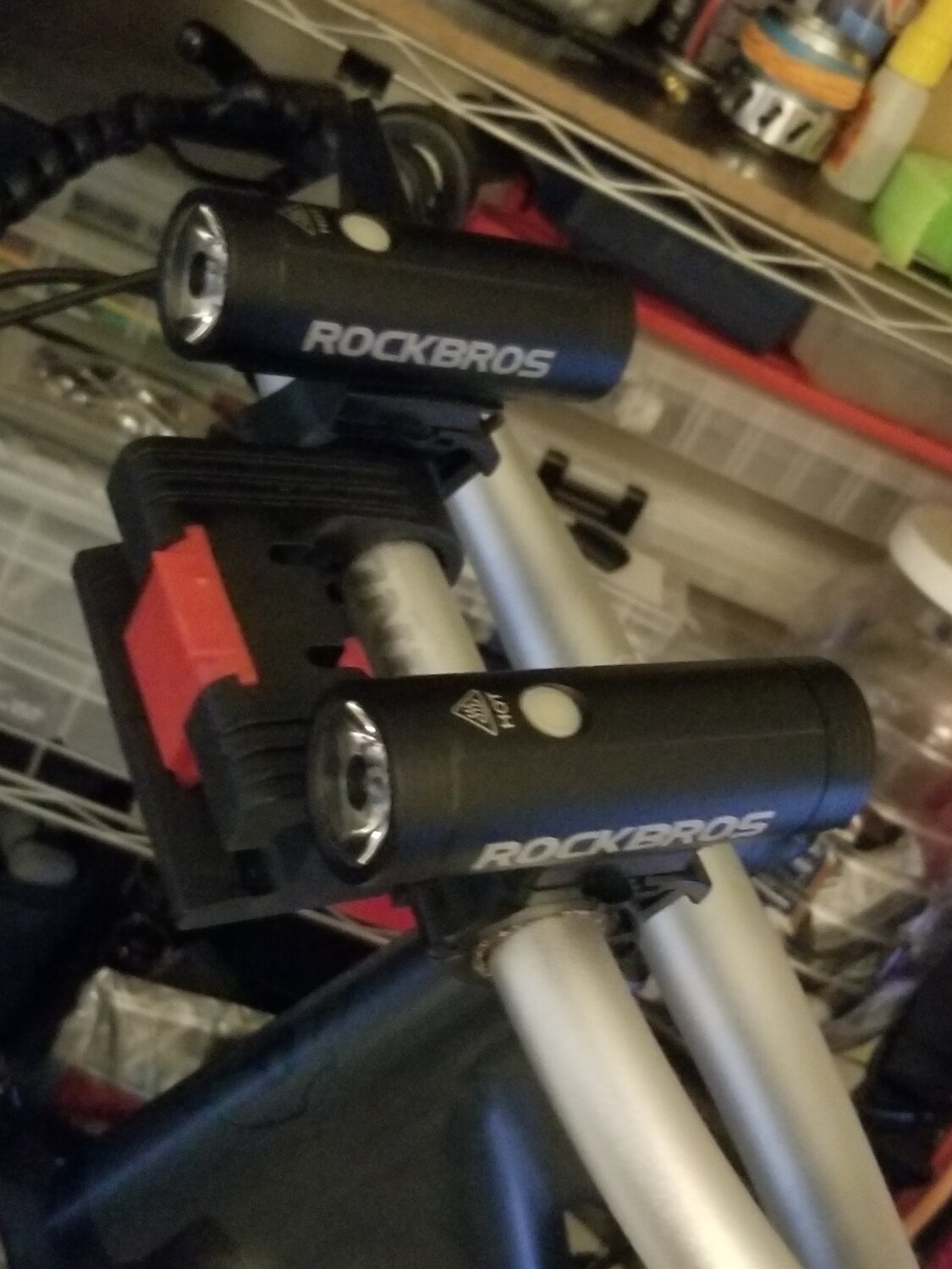

This may be a 'last chance' moment to load up on Rockbros stuff - gloves, rechargeable lights.

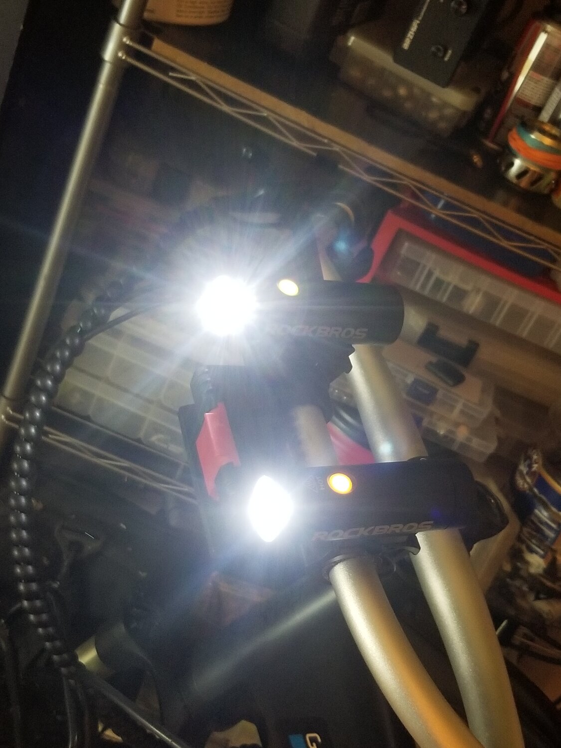

I just ordered a couple more of the 'round, 800 Lumen rechargeable's Screw clamp, and slide detachable, Portable Round 800 Lumen 3 setting Light.jpg that take 18650s and work excellent (here aliexpress source).
These can be dual mounted in a flash and detached twice as fast.
The 'round' 800 Lumen' type with this particular clamp works correctly.
BEWARE: All the other sizes, types and extension types I've tried have problems that make them unsuitable. Regardless what you chose, the types using 18650 batteries - available everywhere - enables you to upgrade from 2000 to 3500watts
The 'screw handled' mount type (pictured) stands out' in setting RockBros lights apart.
Entirely tool less, sturdy, simple and elegant, the mount can be left on the bars and the light removed, or taken off entirely in 30secs.
It's easily adjusted while driving and it holds adjustment without 'jidder'.
Remove the light - click - and you have a powerful flashlight.
Sooooo, after trying them all, I've two of the above type mounts (and some junk in a bucket).
6hrs @1600s Lumens' all I'll need - if doing Alaska in winter - and each light has two lower levels.20220601_174811[1].jpg 20220601_174829[1].jpg
I used to mount one, and keep a spare in my bag for 'nigh-crawling'.
Not 'crawling' that much, it came down to one - no spare needed.
Then it's 'not in use for a while', handy to take 30 seconds to detach and leave home, out of the elements when not needed.
It reduces theft and vandalism. Out of sight, out of mind.
No matter what videos show of 'any lock being broken', if your machine looks 'bare and bully', it'll be less of a target.
More mods that work to come !!!

Latest: Also dumped those Green pads in front. Just failed at comparing with the Red.
Takes me 10mins now to change pads, fully adjusted.
Oh my, what a difference ! Now the front is grippier than the back and zero noise, stutter etc.
Absolute game changer.

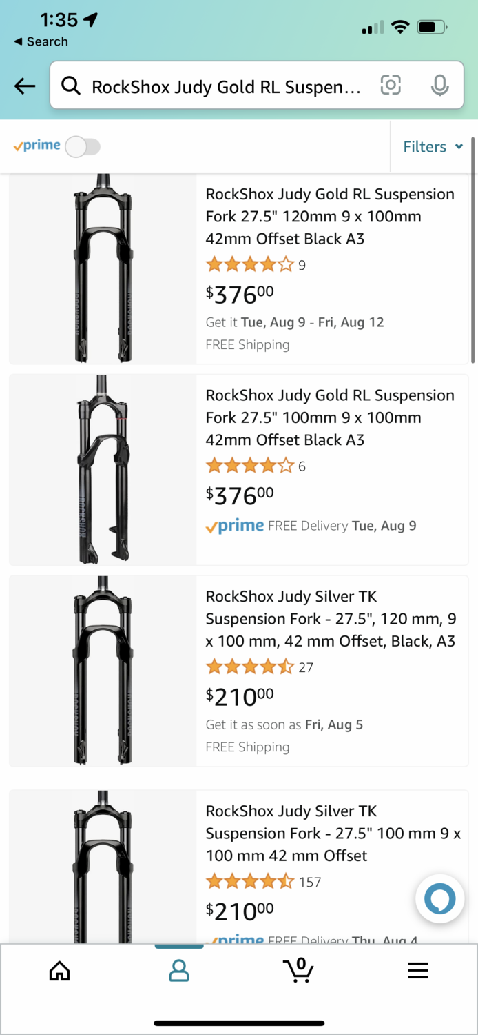

What upgrade fork makes sense for the Ride1Up Lm'td / 700/ 500/ Cafe Cruiser?
I hope this inspires and helps other Ride1Up and knowledgeable suggestions, corrections and sources.
In general this fork installation is no less applicable for the 500, 700 or Lm'td series bikes and certainly others.
If you've thought of changing out, here's some 'Fast n' Furious two cents' to save you some research and provide a few parts leads.
My Lm'td came with an Asteria, straight steerer, 80mm, w/ QR skewers.
Although it's called an 'MTB' fork, it's actually an 'entry grade of entry grade' of suspension forks.
In our segment, RockShox controls the market, so finding that out, I started research with their Recon and up, up up to the Lyric.
A member clued me in, "buy a used Yari and install Lyric Ultimate cartridges".
Huh? That LU is rated better than Fox 36. WOW ! For about $6 - 700.00 I could build a superbad ...
... but that's a huge travel (150 - 180mm), big (36mm) tubed, super strong stanchioned (read "heavy") fork.
At my light weight (138lbs), I just don't need 'heavy duty' and this is an aggressive City Bike, not an MTB - no matter titles advertising 'MTB' on their parts.
The forks I considered come with either the stronger 'thru axles', or QR's.
I happen to like my wheels and the stock tires are super. If it was a $1200.00 fork, that's different, but this is about upgrading to more comfort, capability and higher quality - that's supported by in-depth reviews; higher end in it's particular class and (choke, gag, cough) somewhat reasonably priced (I'd bet, a year from now you'll agree 'it was when I got it').
An axle upgrade requires a new hub/ wheel and this project is about replacing just the fork so I stayed with QR's.
Adding up it sums to: RockShox Judy Gold RL A3, 27.5', Air, 100mm, 1-1/8', QR, Rake: 42mm.
It's a higher grade version of a real 'MTB, entry level fork'.
The fork can come with (or come in a kit) remotes, that also has a dropper post control. I've read reviews that say I can remove tokens to go up to 120mm if I want.
Searching for the past few weeks, I finally found a deal at ModernBike for $356.00 total.
A Judy Silver's $230.00, but by using alloy where the Judy 'Silver' uses steel, the Gold loses nearly a pound of excess weight to come in at 1689gms. Both fit my 2.4" tires/ brake mounts - being bolt-on compatible with the old Asteria.
The Silver has a 'plug' available to upgrade it's strength. The Gold does not require one - already being stronger by it's crown's alloy.
It fits OEM on $4k - $5k market segment e-Bikes - Diamondback, Cube, etc.

A wiring harness can be run through the bars (crimping on new connectors after wires are fished through).
By drilling a hole through the bars (behind the headstay) into the fork, wiring can go into and out of the bars, and down the fork tube.

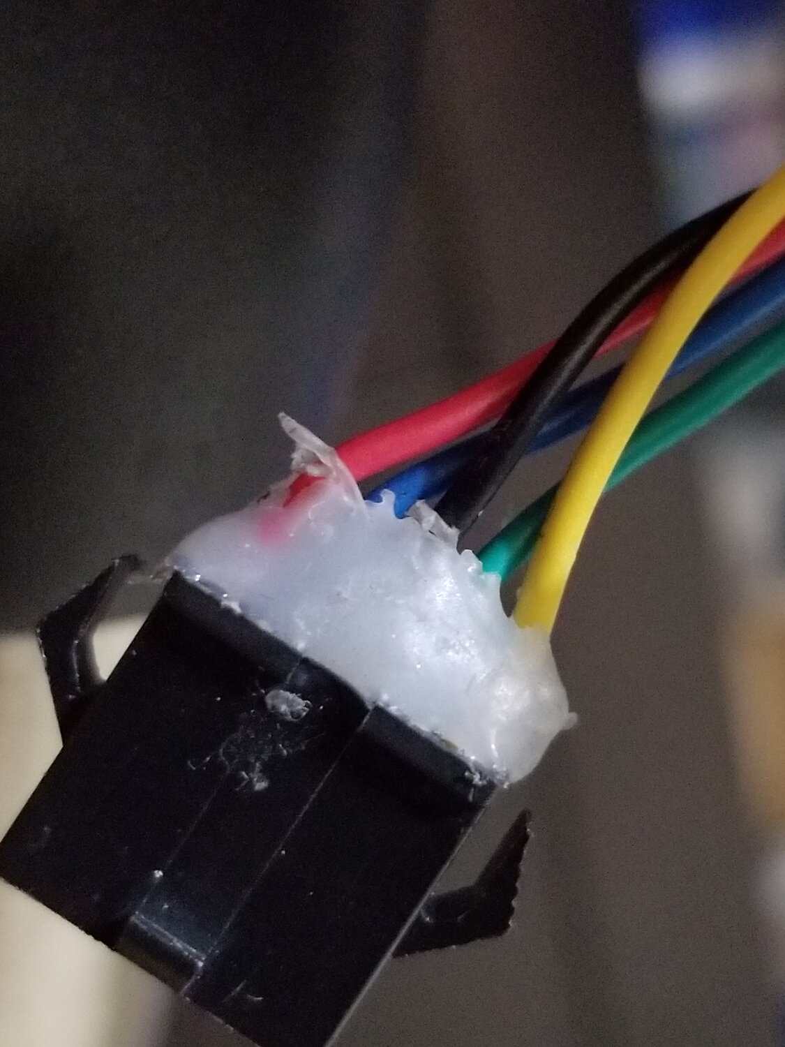

Sounds like a bit of work to neaten a few wires, but I've redone virtually all wiring from the controller to the bars.
In that regard, replacing the 5 pin and 3 pin connectors with high-grade type, 22 wire and factory pressed pins that fit perfectly - the type used for LED's are perfect -
that have then hot glued (like our controller's are) has eliminated intermittent gremlins.
This post is already too long and about the fork, so I'll go over some wiring improvements in another.
Ride on !!!
Fn'F

I just purchased the tektro red pads and galfer 203mm wave 2.0 rotors and a new derailleur hanger.
The thing I’m struggling with is finding the correct adapters for the calipers. I initially ordered SM-MA-F203P, Plus 43mm Post Mount from Amazon but got nervous because the pictured adapter was SM-MA-F203P/PM
When I messaged the seller he confirmed that it was the incorrect adapter and sent me a different part number. However, when I google that part number I’m presented with a bunch of random knockoff adapters.
Can anyone who has done this upgrade advise what caliper adapter they used?
Kinda bummed because I was hoping to get everything put on before the weekend. And at 1100 hard ridden miles, I’m sure the stock pads are nearly toast

I found a little side-to-side play at the rear wheel.
To repair, the machine must be turned upside down. For me that means loosen display bolt and rotate out of harms way.
H bars are awesome, though tippier than conventional that rest the weight on the grip section.
I went in and it was the inner axle nut was 1/4 turn out. I adjusted to 'right before the drag kicks in', tested axles in the dropouts.
Play's gone.
Fn'F

I ended up running the textro reds on the rear. I’m actually running a cheap meroca M4 4 pot (Clarks M4) on the front and I’m damned impressed with its performance. I got the set for $70 and had to swap the handles, but hey, it works.
Current setup is galfer wave 203 and meroca m4 4 pot and stock pads on the front and galfer wave 203 and stock tektro auriga on the rear with red pads.
I’m trying my best to hold off on installing the M4 on the rear since I have two sets of tektro reds. I’m also kind of dreading the hassle that installing the rear will entail

The 27.5 Recon or Judy straight steerer tube/ w skewers will work.
I'll be showing some photos of my Judy Gold. I love it. A bit tighter steering though.
Response as set by my LBS is great.
These folks ModernBike have everything
What’s the difference between the Judy RL and Judy TK? There’s a pretty substantial price difference
