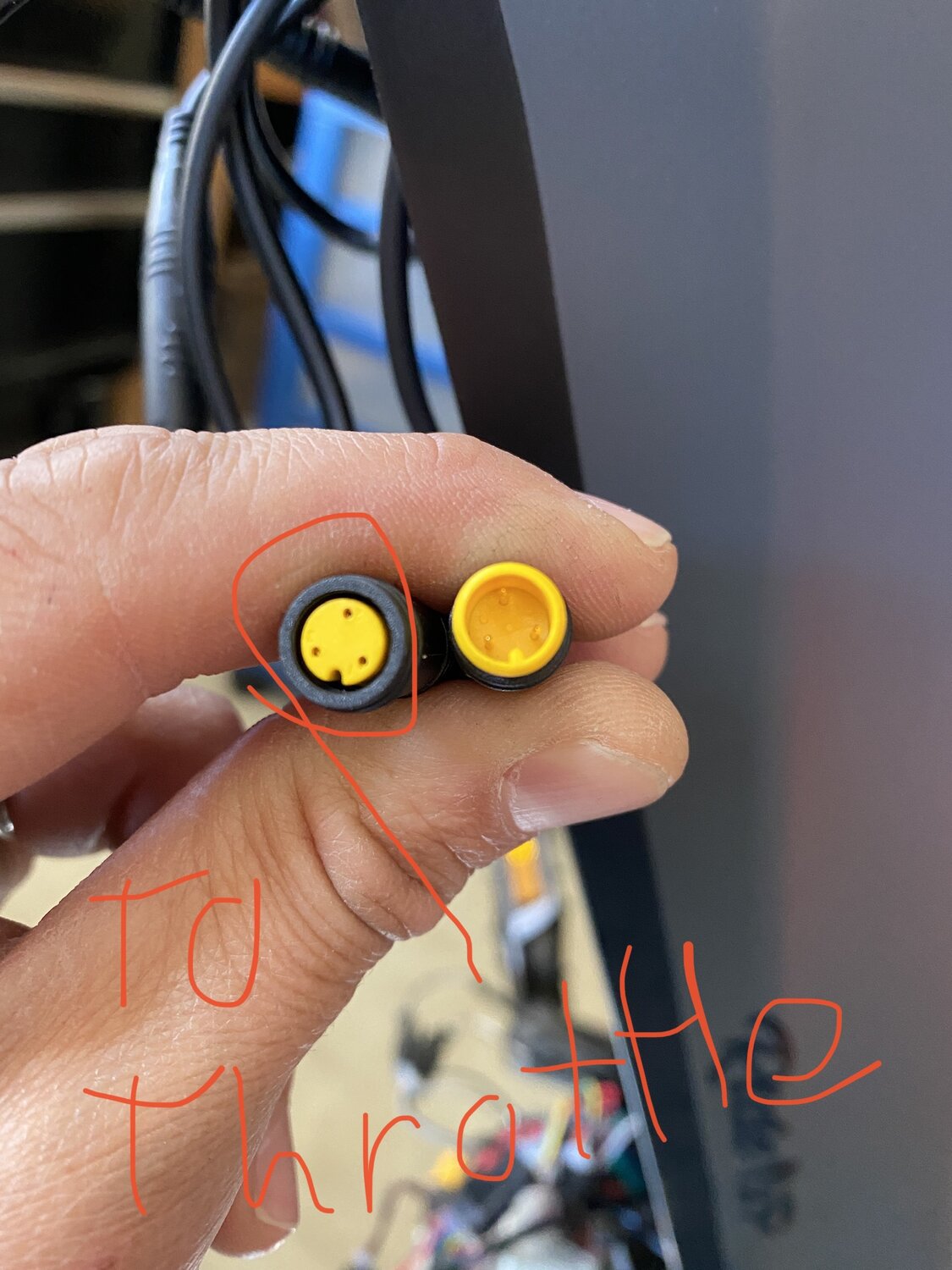

You can easier and cheaply replace it. This is the one that I bought.
The picture I shared is the connection above the battery. You can easily trace the wire from your existing throttle cable through the grommet and dig out the connector to install this one.
Note: This new throttle has a tad shorted cable. This means that the water proof connector (as pictured above) will be exposed.
Out of my own curiosity, I reconnected my original throttle and I’m able to “scale” the voltage to the motor. That is to say, that the original throttle is variable. I swear it didn’t act like this before, but maybe I wasn’t paying too close attention to it. Of course this means, that even if you do change your throttle, it still may not be variable.

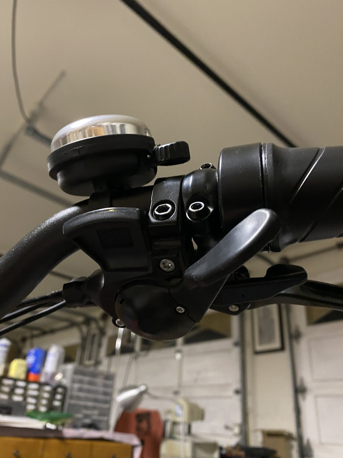

Other note:) when I installed the new throttle, on the right side, I realized that my trigger shifter butts right up against the half twist throttle. Everything still shifts well. I just need to pull the trigger against the throttle. This half twist throttle will be thicker and you’d have to move the shifter as close to the throttle as you can.
Thanks again. I just ordered the right side half throttle from your link.
I moved the thumb throttle to the right side of the bar this weekend. It’s a very tight squeeze so the twist should definitely help free up some space. I just prefer it on the right.
