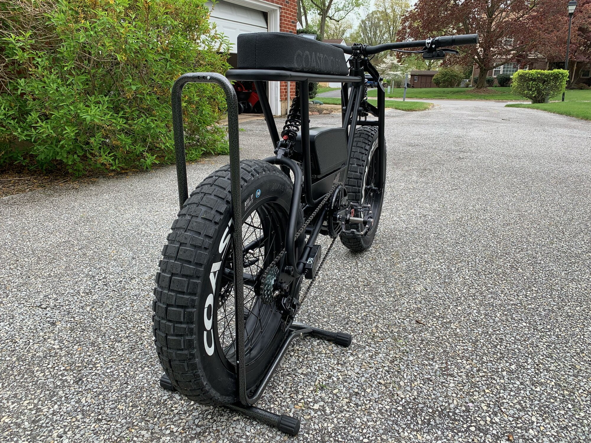

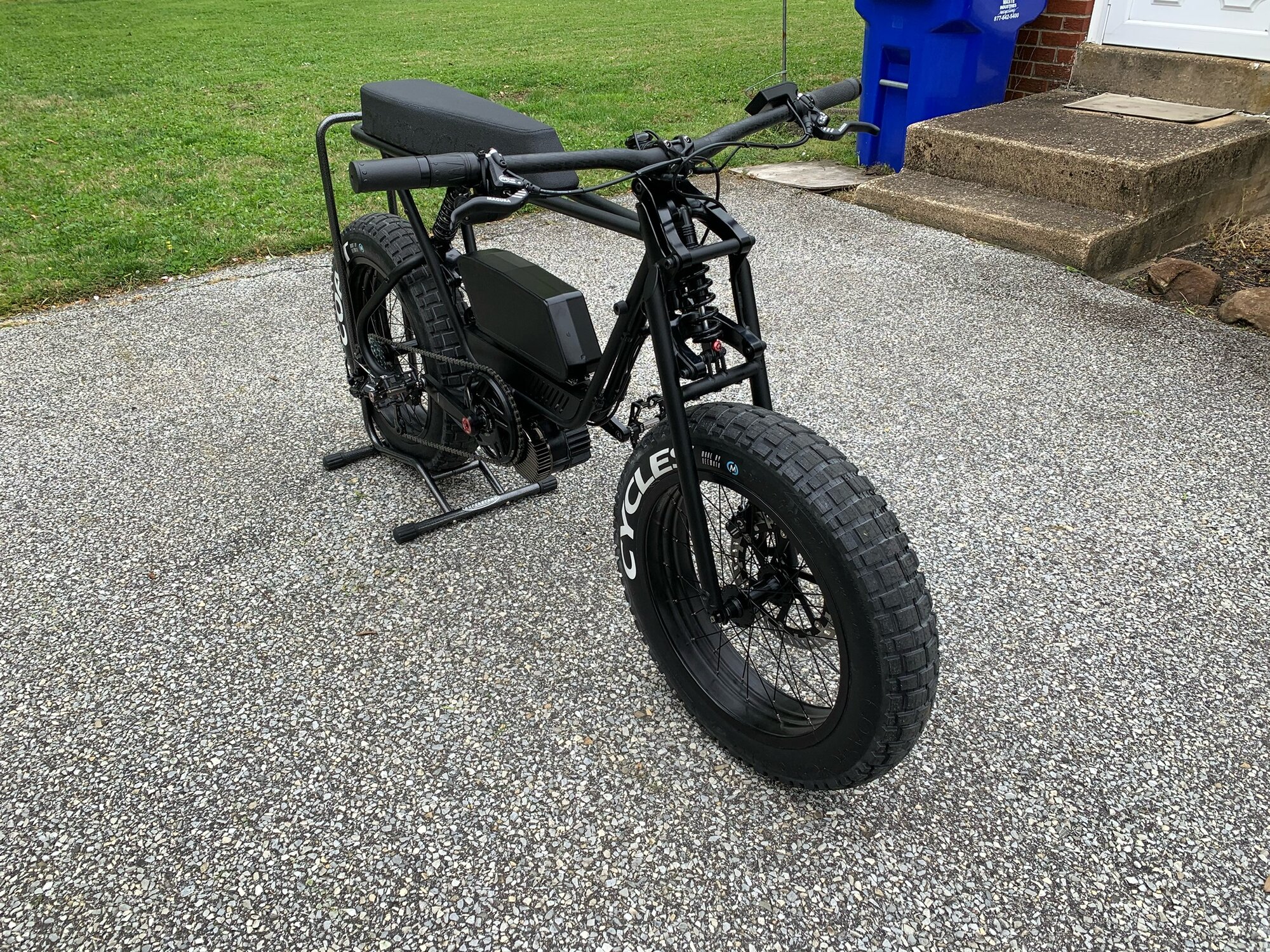

Finally got my Luna Super Banana V2 done and went on its first ride. ...My intention with this post is to give a review of the bike and purchase process with Luna and how, in some ways, the process compares to Watt Wagons specifically the Hydra.
This should have been posted in the Luna Cycles sub-forum. Posting it here shows, to me anyway, an obvious bias since the Hydra is a COMPLETELY different kind of bike. It's a silly comparison.
The bike is a Coast Cycles Buzzraw X that has a Luna Ludicrous V2 BBSHD and a 52V 18AH Dire Wolf Battery.
That is one of the options. Note that Luna is upfront in their description about what the Banana V2 is based upon.
So now my beefs and this is where the difference between Luna and what I’m getting with the Hydra will show. This isn’t a knock or complaint against Luna but all they did was install their motor and battery in the bike. Nothing was done to handle the power this bike makes. Basic SRAM 8 speed setup, cable brakes with 180mm rotors, no upgrades inside the motor like their Peek or steel gears. These are basic off the shelf components and are NOT designed to take this kind of power. Now, like I said I’m not complaining against Luna. It’s basically reflected in the price as to what your getting.

Bike has changed a bit since posting. Had to replace the SRAM rear cassette with a custom Surly single speed cogs setup after shredding the SRAM. Shifting controlled by a D1X Electric shifter. Bike is a hoot to ride and well worth the money.

View attachment 88024Bike has changed a bit since posting. Had to replace the SRAM rear cassette with a custom Surly single speed cogs setup after shredding the SRAM. Shifting controlled by a D1X Electric shifter. Bike is a hoot to ride and well worth the money.
Hi there. I know I'm replying to an old post but I've just got myself a buzzraw x with a bbshd and bac855 controller. I was wondering what size rear cogs you were using as I'm thinking of changing out my 8 speed cassette. Sweet looking bike BTW!
