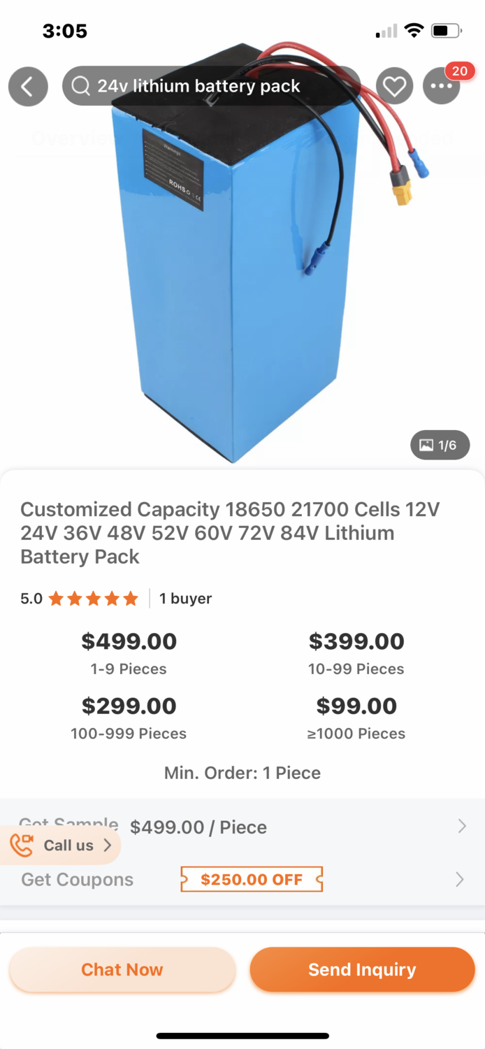

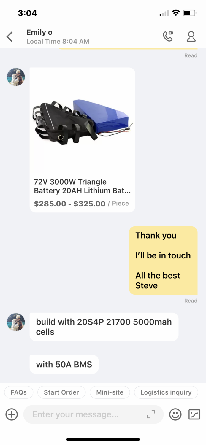

I have given the same motor & controller specs to two vendors & have received proposals, with one battery about twice has expensive as the other !
Wondering what specification is driving the higher cost and presumably the higher value.
Easier to answer if you posted details on the two batteries.

Tried to post the spec’s I have in the previous pic’s. (Sorry not clever enough to post links)
they are each giving me the specs they want to share. Given 3000w 72v scooter/minibike application, if I were to ask each vendor for the same 1 or 2or 3 key specifications, what should I ask for to get a side by side comparison?
Thats mighty cheap for a battery with those specs- for instance go price a "Battleborn" or similar setup, you could rig up a 24 volt system pretty easily-THE-COST!
