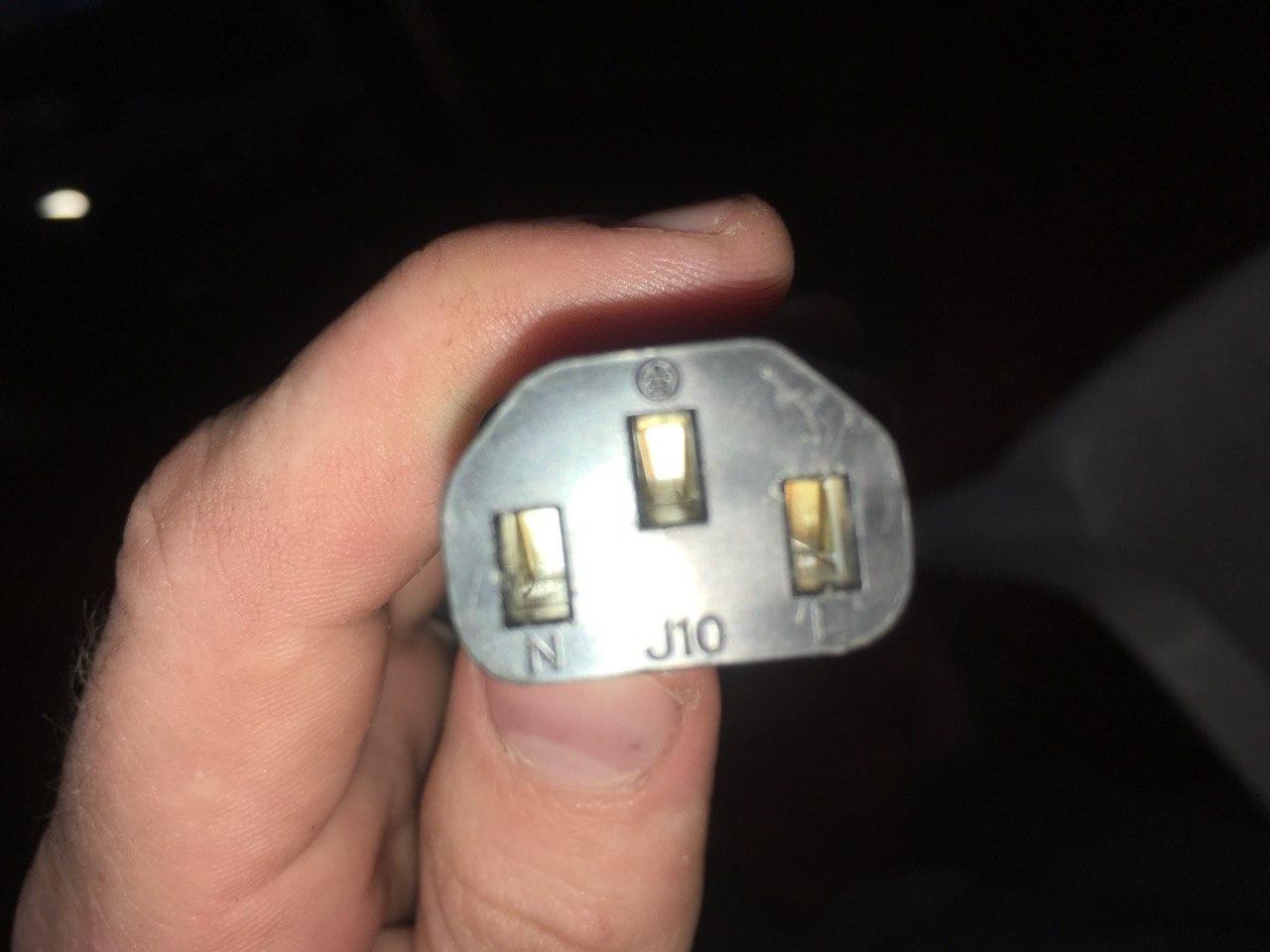

The power connector is the same kind as used at computer monitors (I'll attach a picture of the charger connector that fits it).

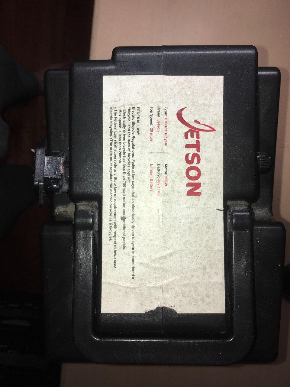

Pic. 1: the manufacturer's tag on the battery

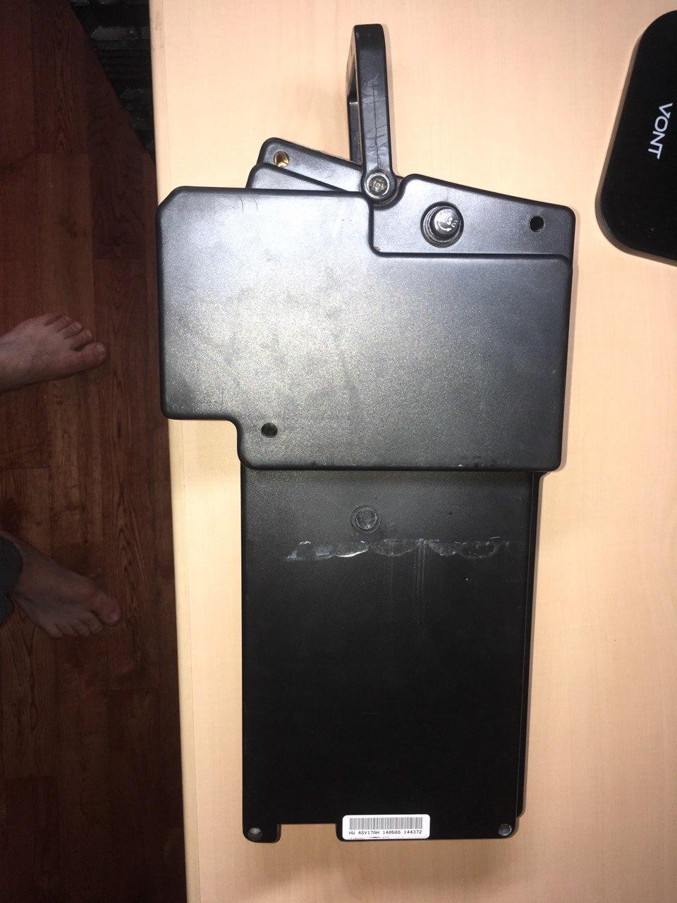

Pic.2: the battery and the ID-code (??)
Pic. 3: the C-14 charger end that fits the battery.

The Lithium battery has 48v, 17Ah.
The ID-code (??) on the battery says "HW 48V17AH 140608 144372".
When you say the connector is the same kind as used on computer monitors, it looks like you're referring to the power cord connector, correct? I've never seen this style used on a lithium battery charger so you may end up needing to change the charger's connector.
As to a charger, you will need a charger specifically designed for lithium batteries. Nothing showed up when I Googled this battery. 48V is fairly common however. An eBay search brought up dozens of generic lithium chargers that should handle this safely, after changing the connector. Prices were $20 and up with the lower $ units shipping from China. Domestic stock is more $, but still Chinese origin I'm sure.

Myself, I would just plan on changing the charge outlet, or adding my own. A pair of XT60 or XT 90 male/female connectors make this a simple operation that would reduce the difficulty of finding a charger that is able to charge this battery correctly MUCH simpler.
BTW - The Jetson ebike web site, https://ridejetson.com/collections/electric-bikes, has 3 models available. All 3 use 36V batteries. They have replacement chargers, but just for these 36V bikes. A generic 48V lithium specific charger looks like the way to go.

Take a look at this charger,
Terrible URL, but it has a matching plug, is rated for lithium batteries and ships dometically; $22.
Since there's no industry standard for the polarity on these plugs I would suggest verifying it with your new multi-meter before connecting it to your battery.

Need to know more about this battery. If there are no external markings identifying it, taking it apart may be the only option. This, to identify the individual cells, which USUALLY are identifiable.

Not good news. Depending on the chemistry it shouldn't be lower than about double that. At 20V it's telling you that most of the cells are way below their spec'd minimum voltage or that one or more cells are dead. Low cell voltage can lead to early cell, and therefore, battery failure. Can't really say if that's all ready happened or not. You could take the pack apart and check individual cell voltages. If none are dead and you're willing to spend a few $ on the charger you can test the pack by charging it up. If the voltage comes up, you're good to go. Otherwise you've got a new charger and a dead battery.

FYI. If the battery's BMS is working right, it isolates the internal cells from the battery terminals when they go below minimum voltage. Your 20V reading is just residual charge on the circuit. It's not measuring the cells. A 48V battery will show the true cell voltages down to about 40 volts. Any lower than that, the BMS shuts off the output, Then it's like what you see if your battery had an on/off switch and is switched off. It's just residual charge.
A lithium battery that really got to 20V would likely go up in flames if it were to be recharged.
