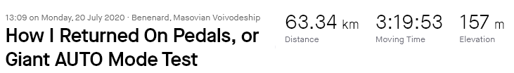

I had a look to the vast database of my ride stats on Strava, where I typically put the notes about the actual battery consumption. Whenever it was a mixed terrain ride (Giant and Specialized e-bikes), starting from the 100% charge and ending with the rest of the battery charge (at the unusable level) was giving me the same 64+ km (exactly 40 miles) as long as the ride was on the flat, and the effective fresh charge was 500 Wh. The assistance in the cases I analysed was equivalent to Giant "125%" ECO that feels natural and does not require the excessive effort from the rider.
It is important to mention Giant e-bikes exhibit a strange behaviour below the 20% battery charge: the remaining charge is going off the cliff giving only a few km range.
That was my first longer ride on a brand new Giant Trance E+ 2 Pro with 500 Wh battery. I was riding in standard Giant BASIC (Level 2). I had to pedal for the last 3 km unassisted.
Then, I tried the Giant AUTO mode on the same e-bike. I actually rode assisted for 53 km, and the rest was the unassisted ride.
Whenever hills came into the account (like 650 m elevation gain), I could safely ride for only 54 km on the Giant Trance E+ with the 500 Wh battery. That made me so disappointed I ordered the expensive 625 Wh battery and the battery cover, and after having waited for several months, I could eventually enjoy longer rides (with the 500 Wh battery carried as a spare). (I mentioned earlier my brother who can ride the Trance E+ for far longer distances. Yes, he reduces his lowest assistance level to the minimum (50% of assistance -- with 360% being the maximum) and often pedals unassisted).
