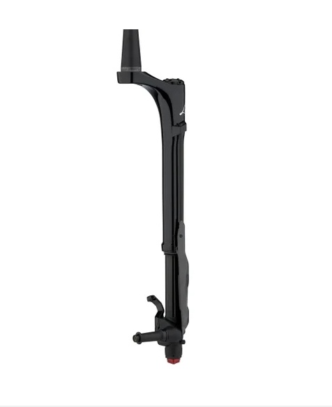

Now, what suspension are you talking about? The Specialized Futureshock? Trek Isospeed? Cannondale has used a suspension fork in their Lefty for gravel bikes but the travel is just 20 mm there!
A smart idea indeed for over €1100
P.S. Specialized Roubaix is using Futureshock 2.0 which is indeed the suspension for handlebars.

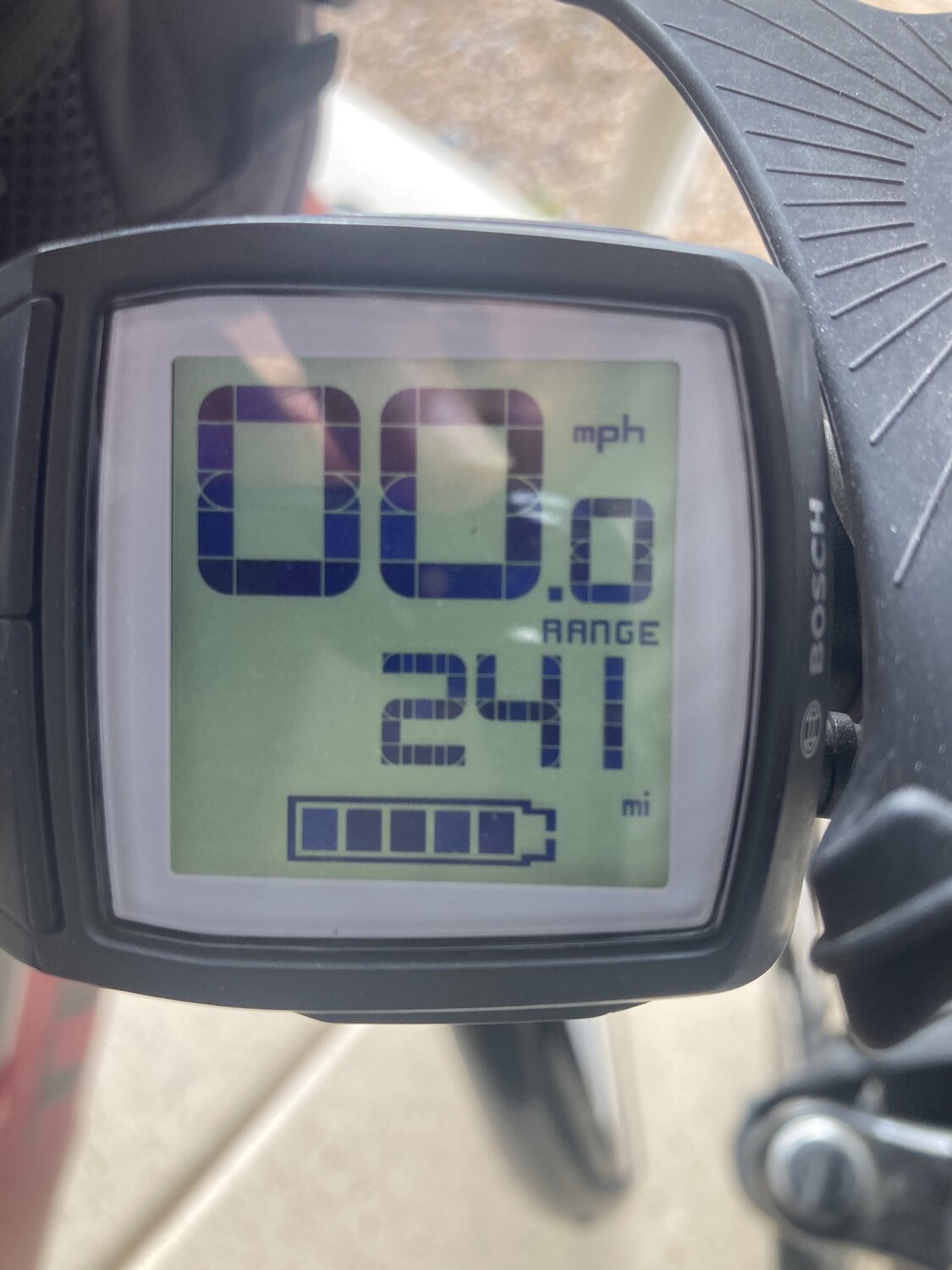

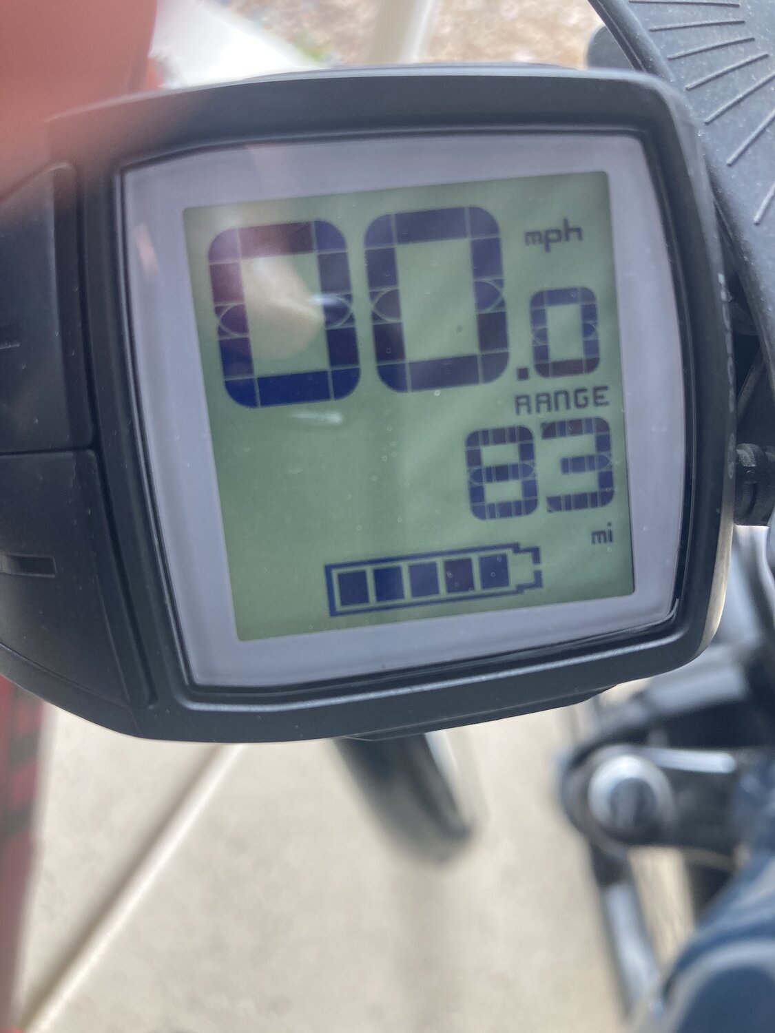

Electron range can be dramatically influenced by riding style. I have a class 3 Bosch motor with a 625w + 500w Range extender. The attached pix show the ECO vs. TURBO ranges on a full charge. Note: 6,700 miles on the batteries.
Gravel vs. pavement has little range effect per my experience.
