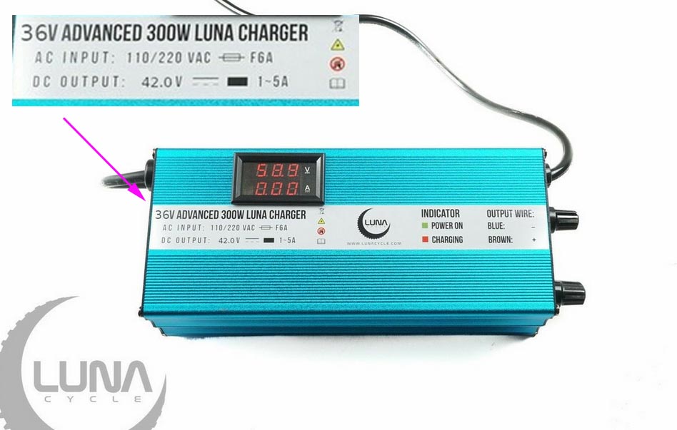

Re the Luna charger - I actually e-mailed them and that was the reply I received. They do not make a 240v. input charger.I believe It's less stress on the battery to recharge at 50% than it is to go down to 20%. By that reasoning, I recharge most of my batteries after every ride. If you want to maintain longevity then, recharge your battery to 80% after each ride, and top it off at 100% just before you ride it again.

By the way, in your other thread you said Luna claims their charger only runs on 110VAC. Wow, they must be taking different stuff than coffee on their breaks again, I have a Luna 80/90/100 52V charger, It clearly states 110-240. Universal switching supplies always run on 110-240. It's globalization.

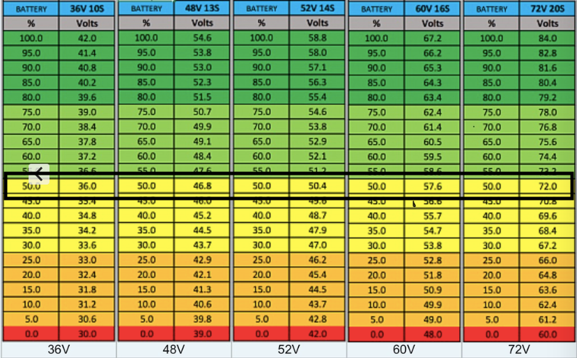

I keep my batteries charged to between 40 and 60% for long term storage. This chart gives a voltage to % comparison:
Consequently, I keep my 52 volt batteries charged to between 48.7 and 52.1 volts. I'm sure others will offer other suggestions but it's always best to check with the manufacturer.
