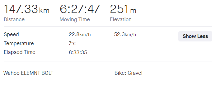

Typical ride metrics for a gravel cyclist during this cold Autumn. The temperature for the guy's group ride was 45 F, hence a relatively short distance.
