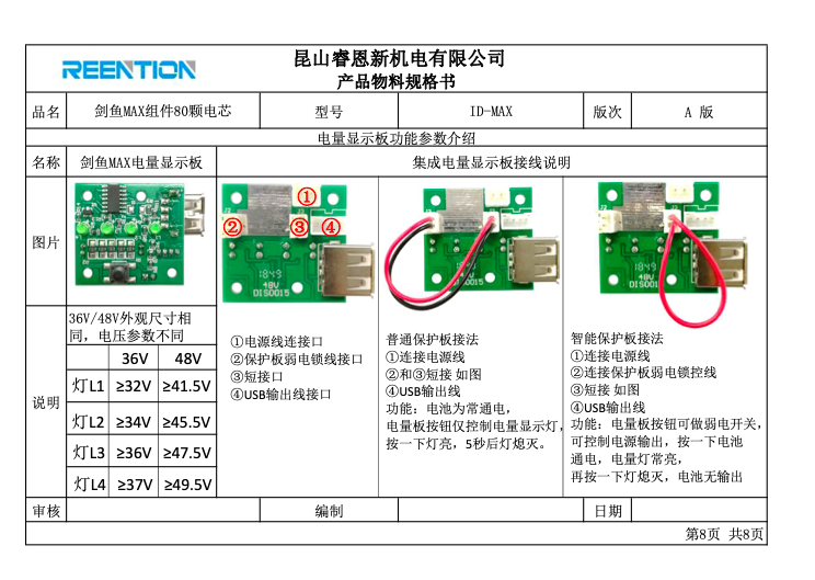

Hello thanks for letting me join this forum. We have a couple RAD city step through bikes and they have been pretty trouble free so far. The reason why I signed up for this forum is because I'm trying to find a part for a battery for a friends bike. She bought a Sparkbike a couple years ago and is already on battery number 3. The first battery was replaced under warranty the second one they would not replace anymore so she had to buy a new one (number 3) to the tune of about 700 Canadian dollars.
She brought me battery #2 to look at. I'm not really impressed with what i found in there. (a big mess of Silicon) It looks like water has entered the battery through the USB port even though she never uses her USB port but we do live on the WetCoast. It is a 48V 17AH battery made by Reention - Dorado. Battery voltage when measured at the fuse is 54V which would indicate the battery cells are still good. The little circuit board that holds the LED's to show state of charge however does not look to good and does not light up anymore when the button is pushed even though it has power. I'm trying to find that board but come up with nothing beside a Chinese PDF file which does not lead anywhere.
Does anyone here know where i could get this part or a similar one that would work.
1846 48V DIS0015 is all that is printed on it.
Hey, I have same board that burnt out, did you find a replacement? If so could you let me know what you did? My battery was still good but that board fried.... Power button wore thru and moisture got in... Thx
FYI, google searches for a replacement LED board leads here so I am posting a link to an ali express seller who sells the LED display board.
Also, the reason water ingress happens is because the rubber on the switch gets worn and then exposes the circuit board below. If your dorado battery has a rubber gasket, then you just need to ensure that the switch is covered with electrical tape.
My suggestion would be to apply something like silicone conformal coating so that the LED mosfets don't die as a small amount of corrosion removes the pads.
It is around $8, with shipping to Canada atleast being $15, though it will take 4 weeks.

The OP back in 2021 posted a picture of the LED display board on the reeniton Dorado. This board contains the USB port, a switch to turn on the battery and and 4 LED indicator lights and related circuitry.
This board has nothing to do with the BMS, so I don't know who brought the BMS up. This is an easy to replace part, though most sellers tend to sell the case as a whole.
Given the size of the case, you save $40-50 on the shipping, though I haven't found a seller for the rubber cover+gasket for the switch which is what tends to fail on this battery leading to water ingress.

it's listed with a part number on the Chinese site or full catalog. Products designed for avionics can protect electronic elements. See Boeshield and ACF50. See this sheet. There are different versions

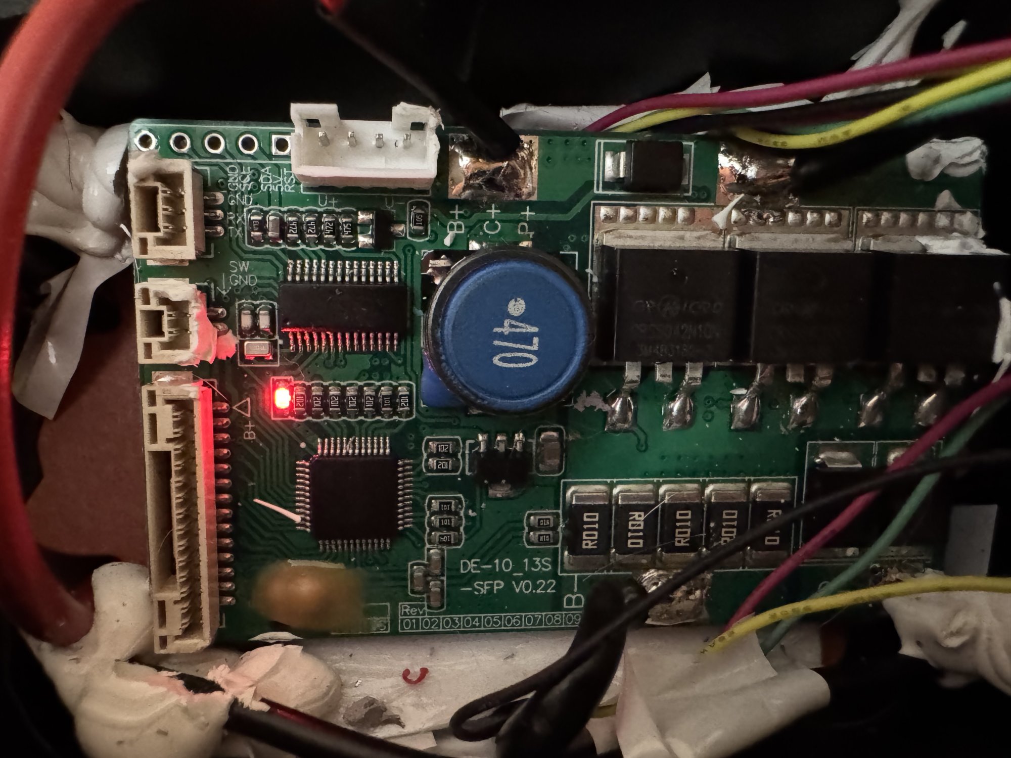

Hey i know this thread is old, but does anyone know where i could get a replacement for this bms? It's from a magnum peak, Reention Dorado+ 48v 13ah.
Thanks!
