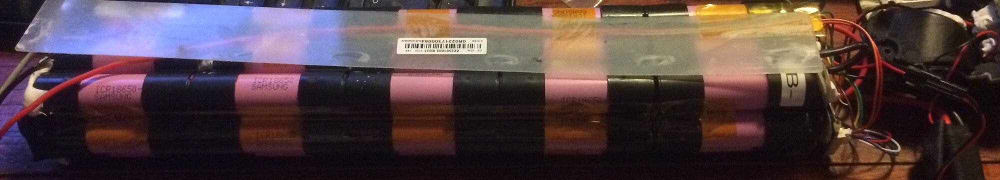

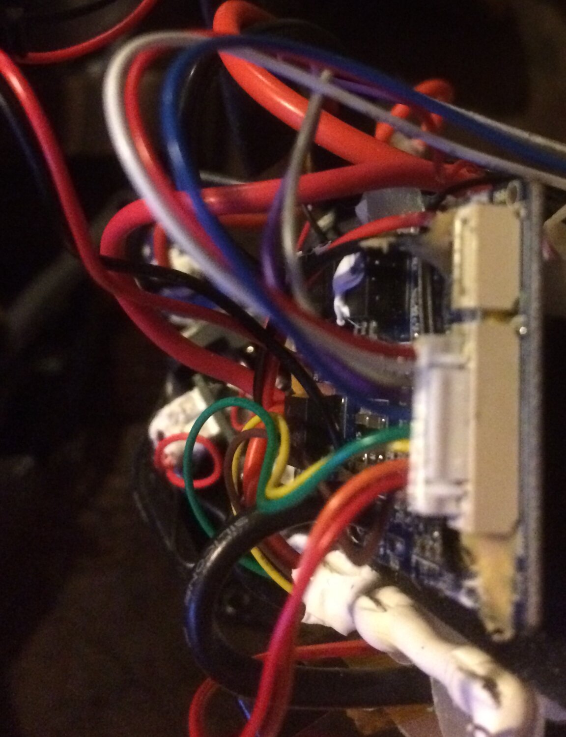

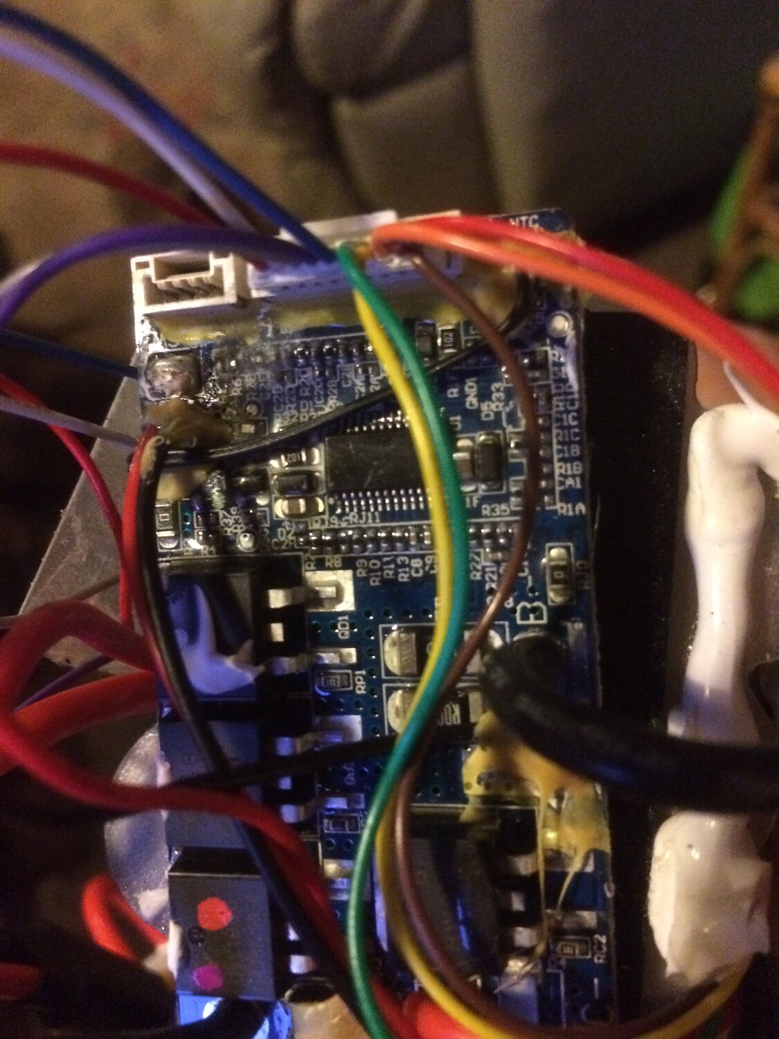

just to add to this, I bought a bike with a 36v Dorado from around 2018 that would not charge (red light would soon flash red/green alternating) or show any output voltage but on dismantling I can see 40v at the batteries when tested directly. I tried a BMS reset but no luck. On looking at the main input port on the BMS I could see corrosion and trauma on one connector and also looking at circuit board i'm pretty certain that at least one minute item is burnt out.
I would repair this if I could find a whole replacement board but no luck so far.

Thanks, i've found them all online now, but looks like this is a "4s" so I guess that the BMS required must be specific for this, the main plug has 10 wires only
I’m confused? 4s? Is 14v!
I'm still on the learning curve, the battery is in 5 groups of 10 cells, (I thought it was 4!). This is the very board I need to replace.

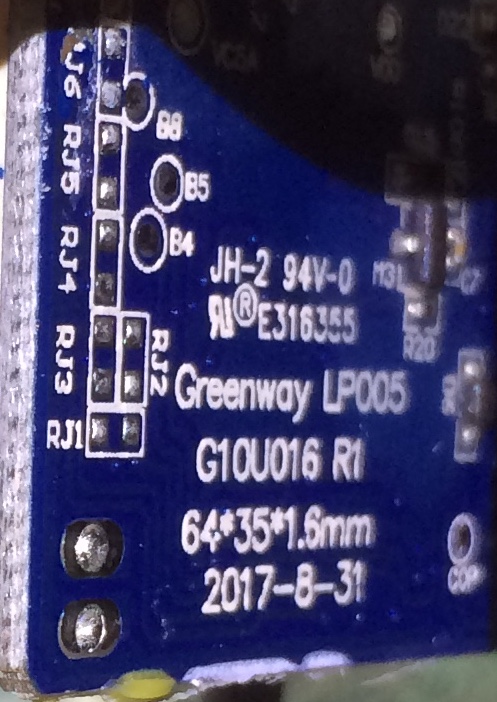

10s (10 in Series) 5p (5 Parallel) 36v (fully charged 42v)
Found on a Polish site. @Stefan Mikes can perhaps help translate. Price is crazy low a couple of £. $3.49!
have you contacted Greeway? I did get the hits Googling Greenway LP005
Thanks for trying Tom but did you see the aftermarket soldering on that board? - I won't be taking a chance on that Polish one. I did find one new but the price was too high. Looking at the range of new aftermarket boards available, I think that that is my best route but will need to learn/will need help working out which ones are compatible. It doesn't matter if I can't preserve all the functions of the original like the "charge" indicator etc.
