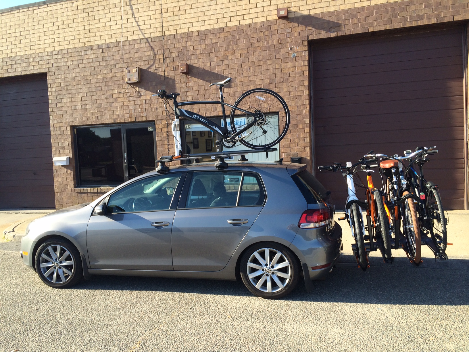

It is possible to carry 4 E-bikes using a 2" hitch+rack combo. Kuat NV is a popular model that many of friends have and they routinely carry 2 heavy E-bikes without even removing the battery. There is even a pic of this setup on a highlander: https://www.stoorz.com/i/combo-kuat-nv-20-gray
@Chris Nolte used to have this Kuat 4 bike setup when his shop was in Long Island. In this pic, he has 4 heavy bikes.
@ebikemom It would certainly help if you remove the battery and seatpost before loading them up. Also, traveling at 70+ mph may not be advisable while carrying 4 E-bikes.
